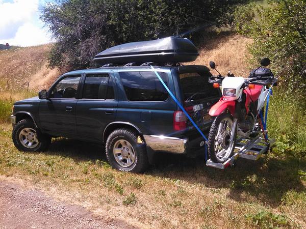

I use a Hitch Haul motorcycle carrier to get my 250 Enduro to the trails. It weights about 260 pounds. The aluminum rail holder has cracked and I used JB Weld to repair it. I also use ratchet straps to help support the ends of the carrier. I installed Firestone Air Bags on my 4Runner because I was hauling a trailer with the motorcycle mounted on the trailer tongue. You are going to need a very strong rack to hold a 400 pound bike.

Here is my old dual sport 230 that I bought in Idaho. I drove from SLC Utah to Boise Idaho to buy this bike. They are very hard to find. I bought the hitch rack at a Harbor Freight and brought it home. I rode hundreds of miles of trails out there, and even rode Slickrock in Moab! I like the red bikes!

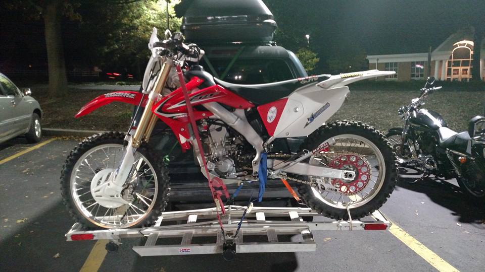

I’ve got 99 springs on my ‘00 and just hauled my supermoto on a hitch hauler this last weekend. I mounted up a wheel chock to secure the bike better. It made the 4Runner sag a bit at around 300lb for the bike and maybe 50-60 for the hauler. It drove fine for 4hrs each way but if I were to do it more, I think I’d get some airbags or even better, a trailer.
