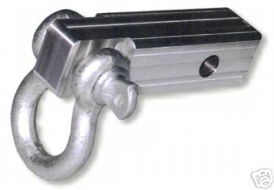

I leave my hitch reciever and shackle on all the time. It's convenient when I need to tow (no fumbling for it in the tool box) and adds some minor protection from idiots who need to practice driving.
Baba Booey said:
Thai,
One thing you should consider (and you may already know this) is that the hitch shackle mount (i.e. part that fits into the receiver) is a solid piece of steel (or some other metal) with a hole drilled through it for the pin to fit through.
I have a Warn hitch shackle, and I had to drill the hole edge out slightly in order for my hitch pin to fit through because it wouldn't fit through a slightly "out-of-round" hole on one end.
Because it is a solid piece of metal with a hole barely large enough to fit the pin through, I believe it would distribute the load evenly over the entire shackle mount piece. In fact, I am not sure that there is enough room in there to really bend the pin much at all because it is completely surrounded by the solid piece.
In your scenario using just the pin, the load is borne by just the two points on the pin that actually contact the edge of the holes on your hitch.
Then again, I am no engineer, and so I could be all wrong.:p

I actually now have a Warn unit as well as the Ebay one under discussion.
The warn insert is a heavy solid cast unit. The other unit is an interesting formed steel unit that weighs less. Check out this other one on Ebay.
EBay Shackle

I always have mine in, you never know when you might need it. It may stick out a bit, but I believe there are other parts under the rear (like the spare tire, and other parts of the tow hitch) that will actually hit the ground before the shackle receiver does since it's up a bit higher. I've scrapped my rear a few times, but don't have any marks on the receiver. I do have scrapes on the hitch receiver itself, however, just behind where the shackle receiver goes in.
Here's a sample pic of the load on the two different concepts:
The top image shows the load being on the center which can cause severe pulling forces applied to the center. A good example would be holding a toothpick and then pull the center and seeing the toothpick snap in half.
The bottom image shows the load being distributed at the ends of the pin. A good example would be holding a toothpick and then pulling the toothpick at the ends.
It is easier to bend an item when it is farther away from the foundation. This means the top image will suffer from potential failure as the load is being applied away from the foundation. Comparing this to the bottom image, the load is applied right next to the foundation so it would be more difficult for the load to damage the pin.
A real world example of this would be attempting to bend a bar by hanging on the middle vs the ends. Naturally the middle will show more flex vs the ends.

I agree with Lance that a strap in the center of a hitch pin will lead to bending of the pin and possible failure. I know I have a link to this somewhere.... :confused:
What happens is that at the least the pin gets bent in the middle and cannot be removed. The case that I read somewhere involved multiple yanks on the tow strap rather than one smooth continuous pull. The hitch pin fractured in the middle and failed.
