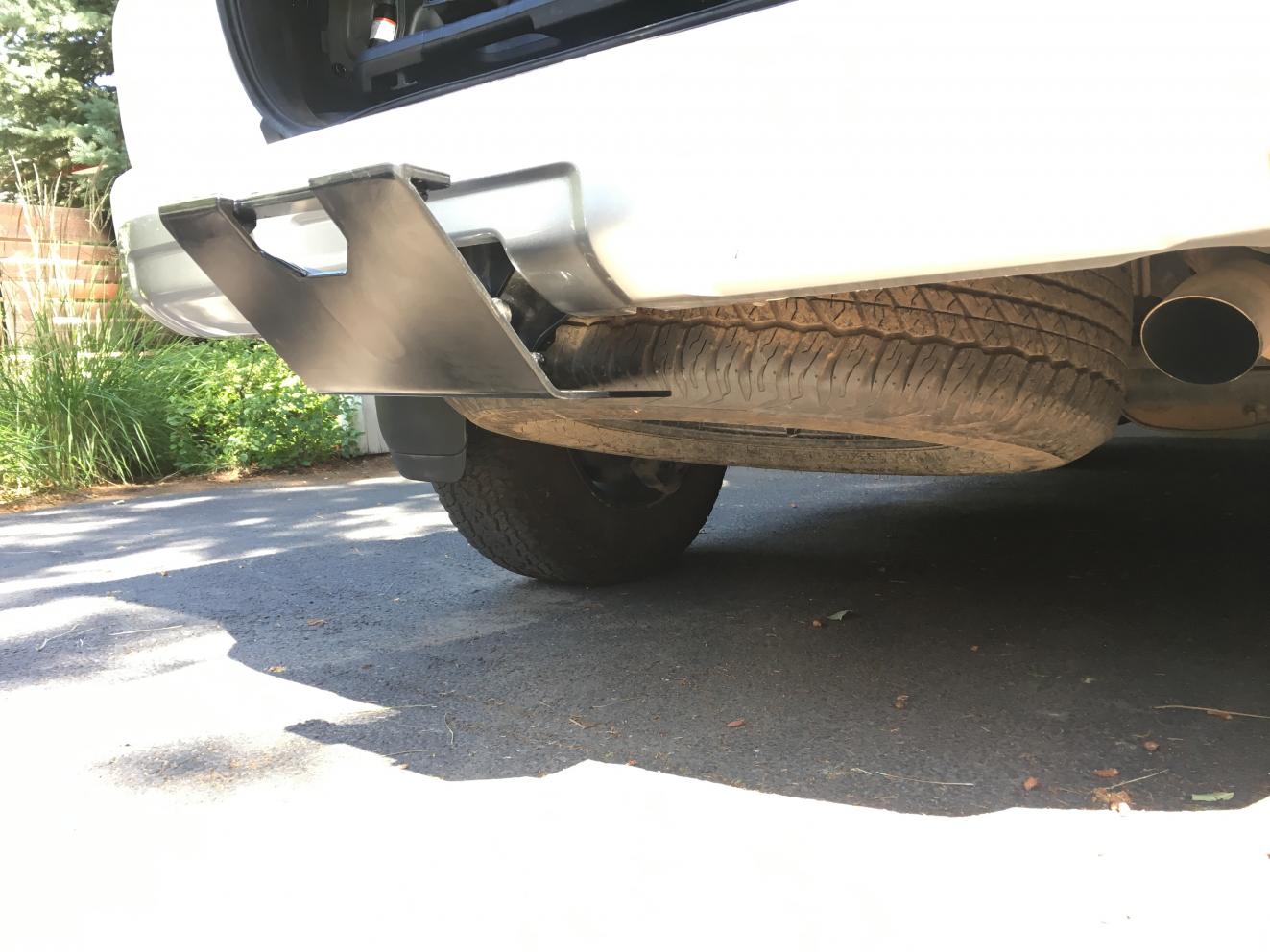

Mine arrived today, so I answered my own fitment questions on the stock tire size (265) spare. When I put the BA Backbone in the receiver the first time, it would not go in all the way to allow use of the furthest-in hole before it hit the spare tire. However, if you lower the spare a bit it can easily swing forward far enough to allow the stinger to be inserted into the receiver all the way to the furthest hole. You then just snug the spare back up tight. I don’t know if there is room to do that with 285s, but it works with the 265s and gets the step much closer to the bumper.

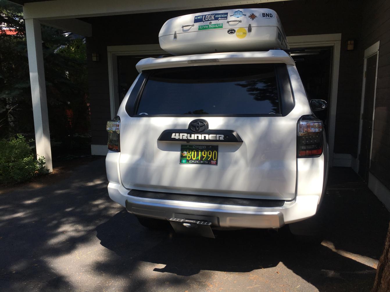

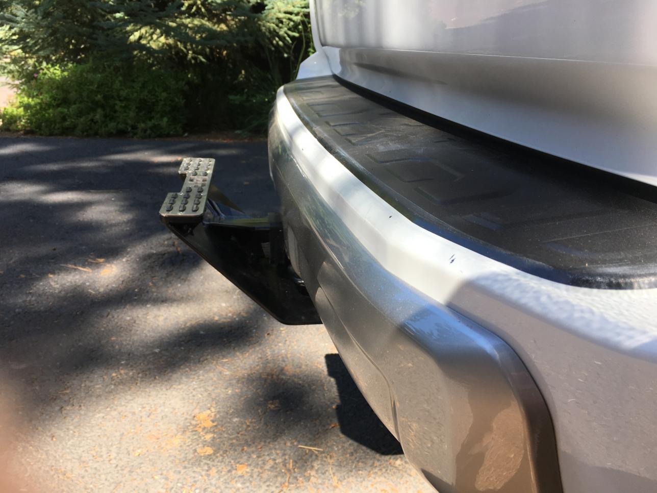

Backbone
Here are a few shots of the Backbone at its furthest in position. I think the bike inner tube will do the trick for now in stabilizing and keeping it from rattling. It is a nicely designed and finished piece of gear, and it seems like it will work well as a step.
