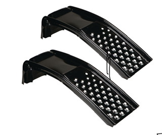

4 car ramps? I would think, if you left wheels and tires on, you would have plenty of room under to work on the frame. If you need to get to the area next to a wheel, do one at a time with a jack stand on a pile of wood.
I used those for my Outback, but I have not been able to use them on the 4R. The front wheels just roll over them like it is nothing :)
Keep your tire pressure high and they should roll up no problem.
The point is, I cannot stop on top because I cannot feel when to stop, I just drive till the wheels have dropped on the other side. Not so on my Subarus.
It is like a small rock on trail, don't feel it :)
Just a fun fact, that's all...
Make some ramps. Make 4 of them to whatever height you desire. I found some lengths on the internet and decided to copy it.
Added stoppers because my Dad liked to use it for his car now too and felt it was safer to have.
Thanks guys, I know that I’m dealing with a vehicle with decent ground clearance from the factory but I was hoping for more height while working beneath.
I’m a bigger guy plus creeper plus grinders etc means it’s kind of tight. I found this on my chev pickup project, but that was a 2wd.
Maybe I’ll use my steel ramps attached to wooden ramps as suggested to give extra height if needed. That should be stable enough. I’ll weld or bolt on stops at the ends of the ramps to prevent overshooting. Good to know about that one!!
