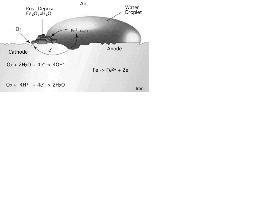

Corrosion takes place where a metal meets water and oxygen. So water in-terms of liquid or vapor with atmospheric oxygen corrodes the metal. Salt water is a very good conductor of electricity than water, so this speeds up the movement of electrons from anode (where oxidation occurs: removal of electrons) to cathode (where reduction occurs: accept electrons). As a result corrosion is 5-10 times faster when salt water is present.
I too apply WD-40 once in a while (make sure the frame is dry). This makes an oil film between the metal and the environment preventing water and air to touch the metal. You can spray trans oil too but it smells bad but stays for years without getting washed out.
