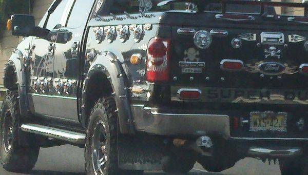

I bet this guy knows a thing or two about them.
If not the real deal hood scoop, I'd rather have the louvers. The idea was good, it's just that it wouldn't last long and end up ruining your hood.
