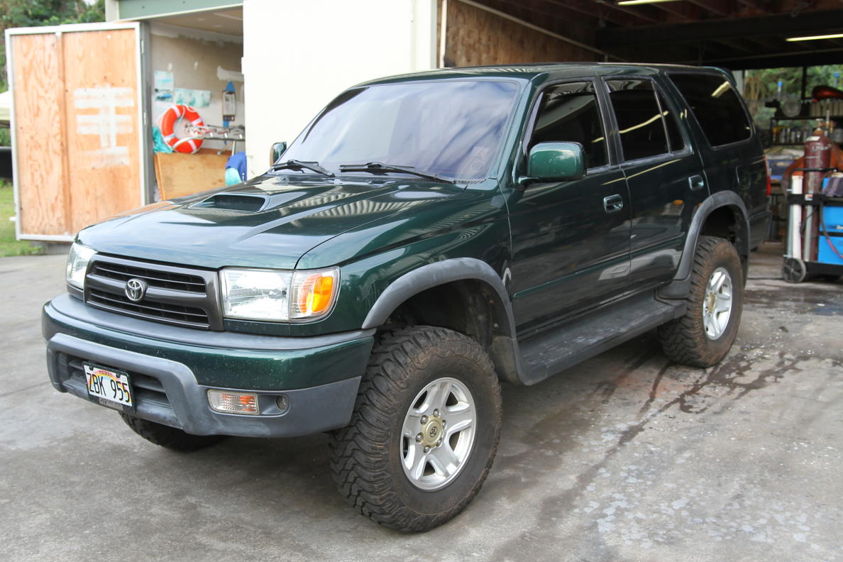

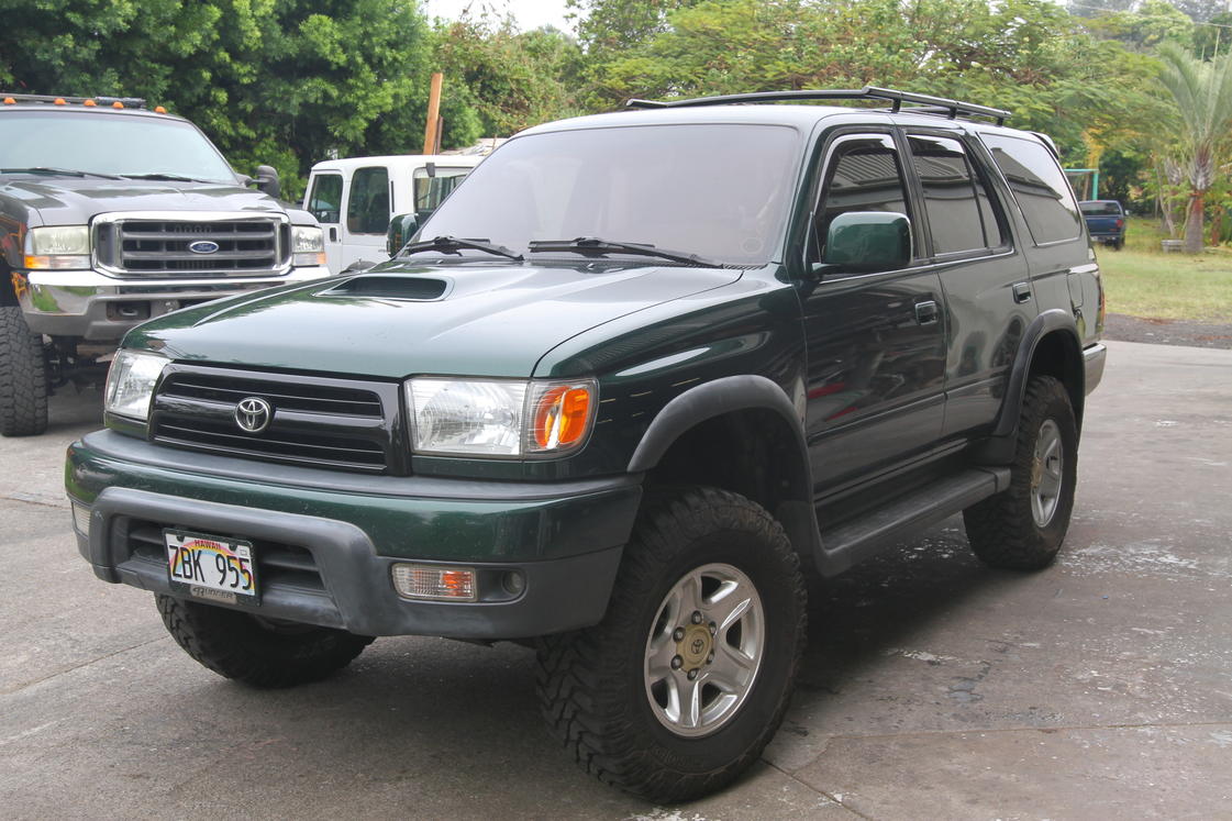

Here was the 4runner before the rack

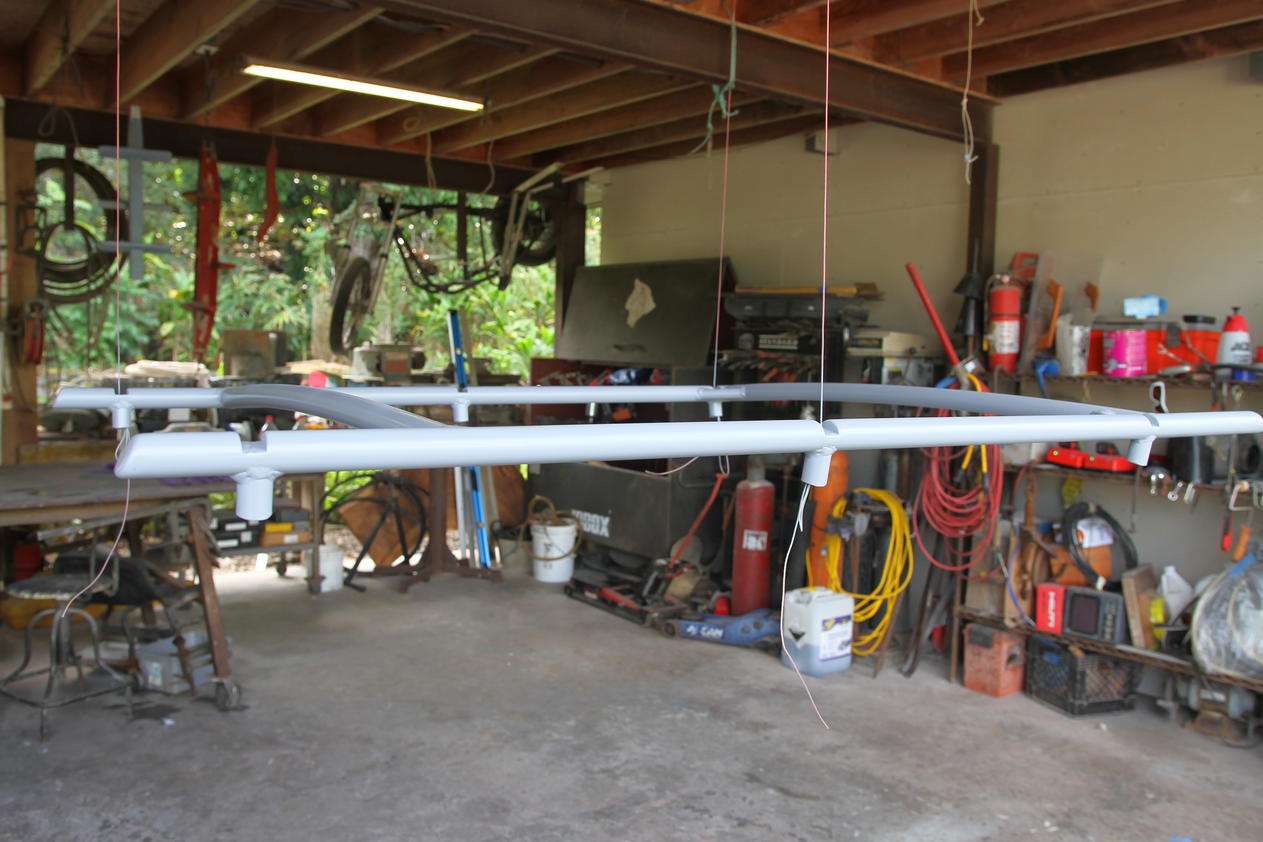

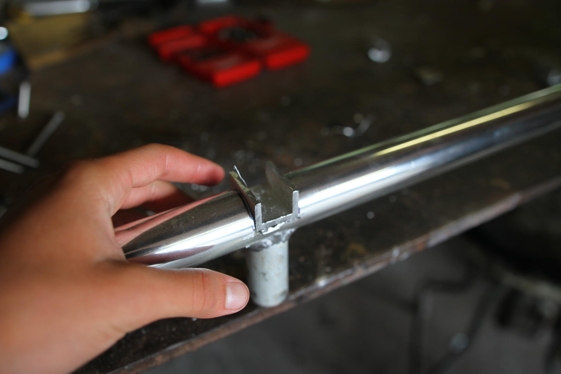

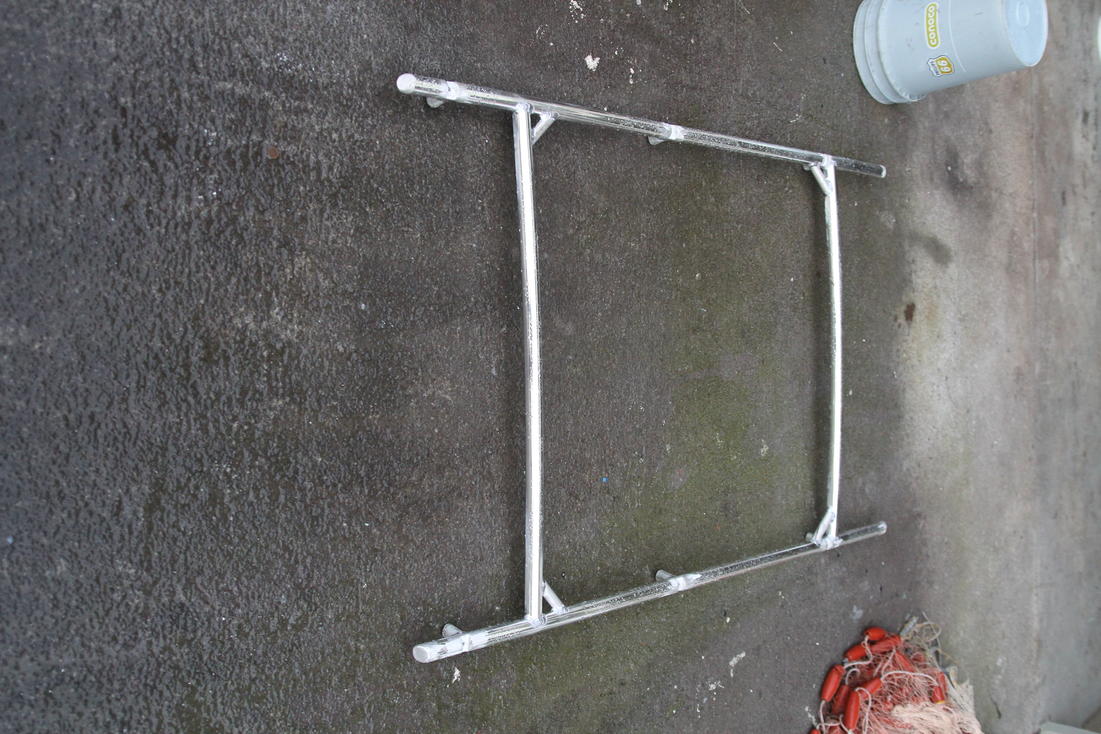

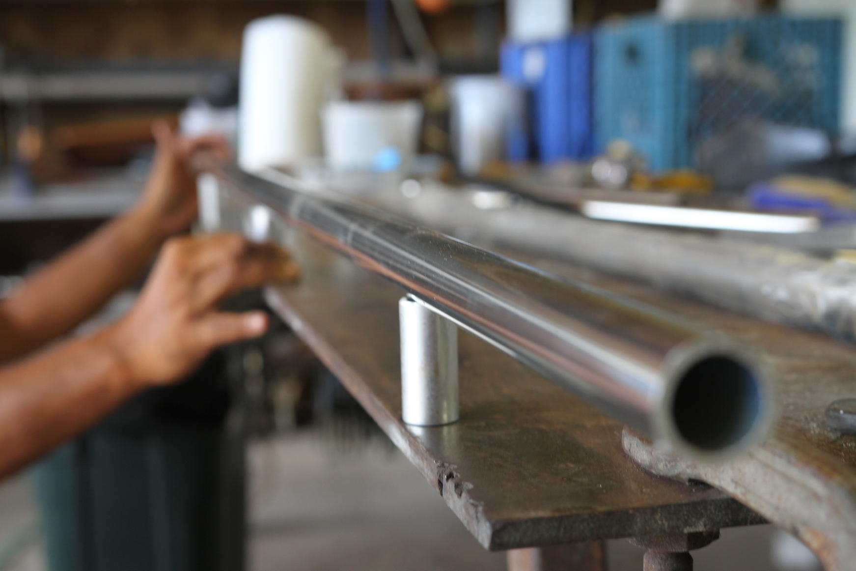

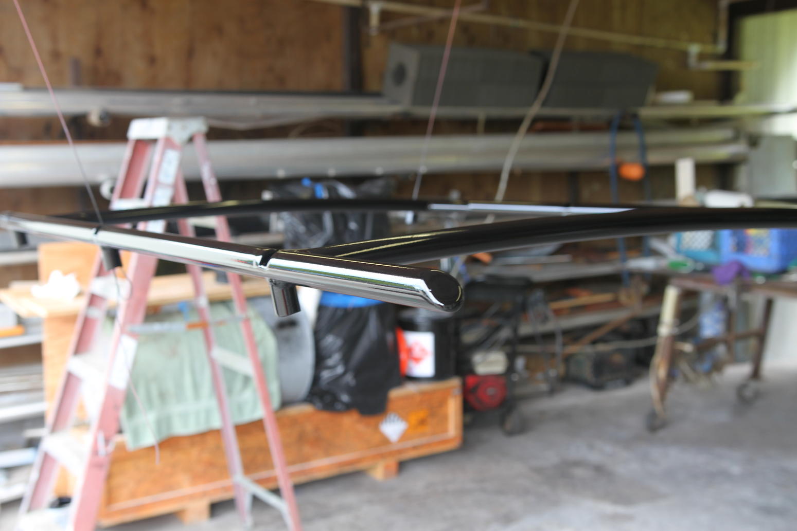

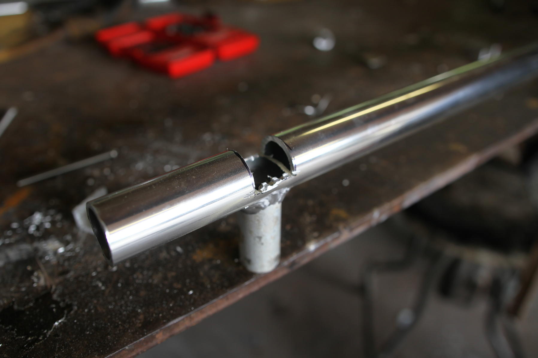

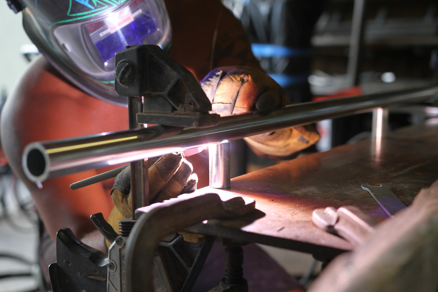

I lost all the pictures of the welding of the two bars we created that go parallel with the black tracks and screw into the track holes. But we rolled two

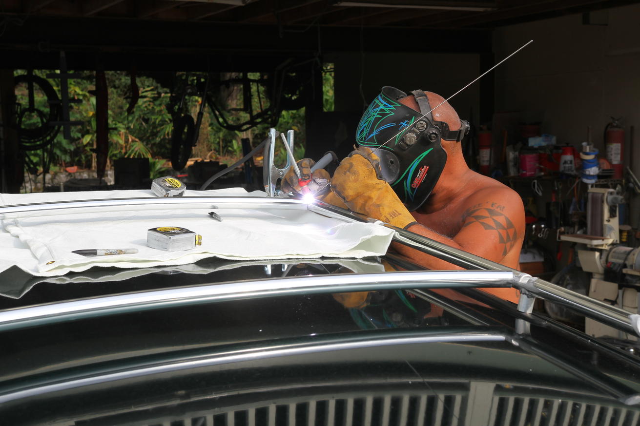

crossbars so they have a similar curve to the roof then tack welded them to the main bars that were over the tracks:
the bars the screw into the black strips are 3/4" aluminum while the crossbars are 1" aluminum, all found, cut, and welded in our garage.
then we completed all the tac welds all the way around

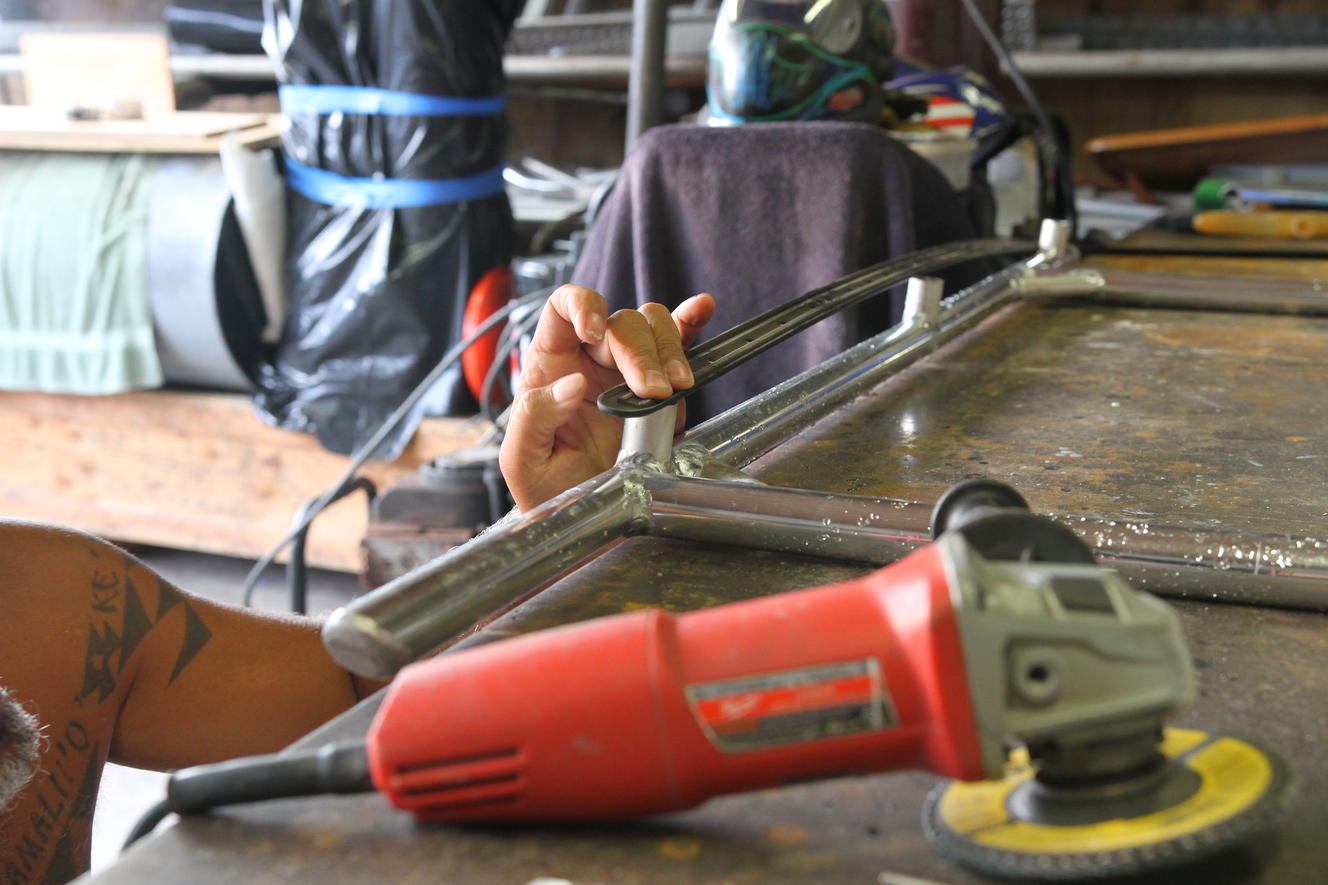

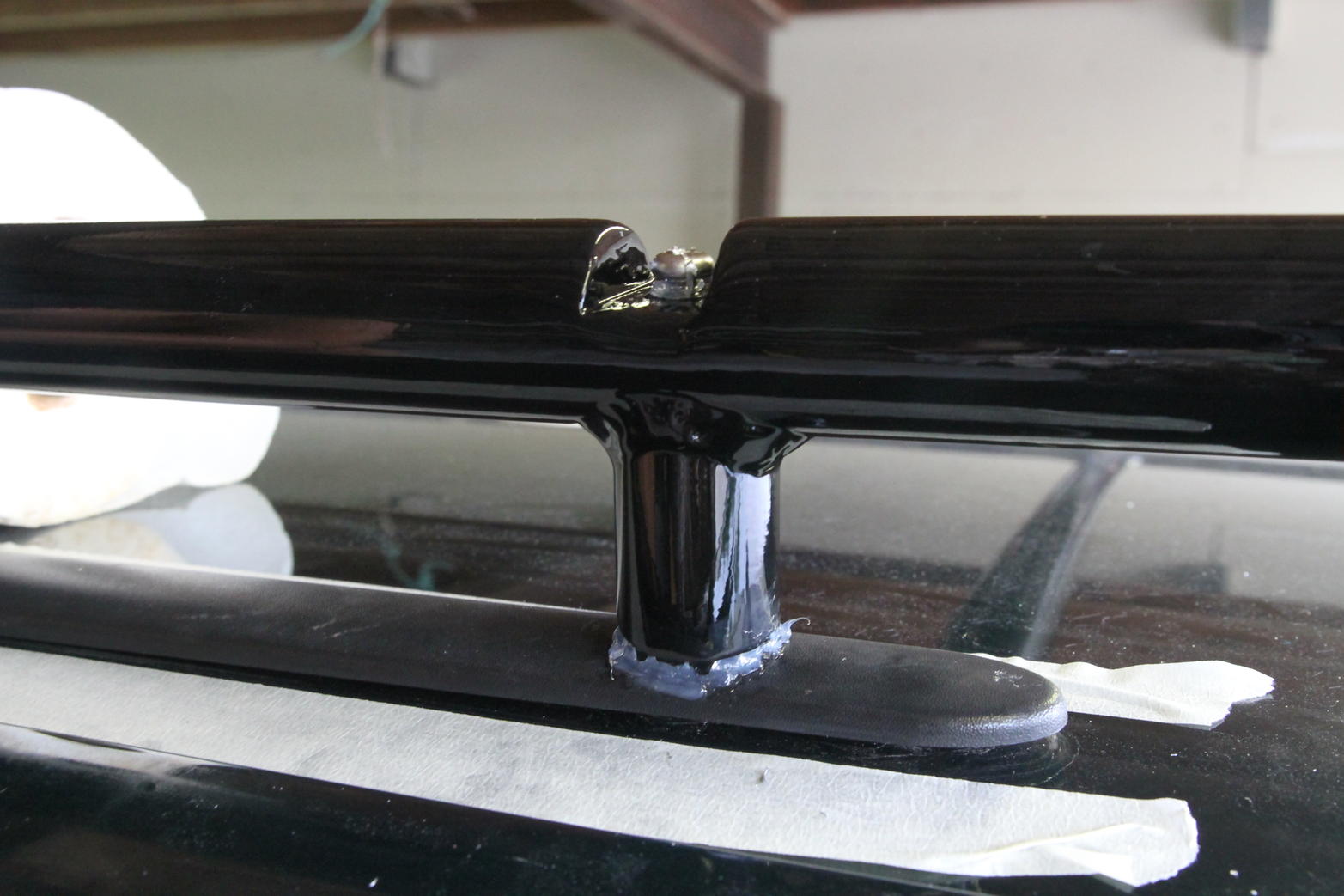

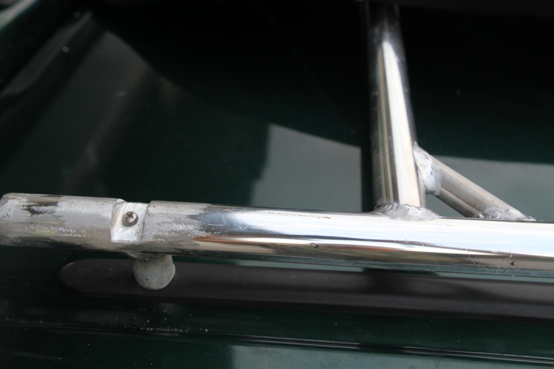

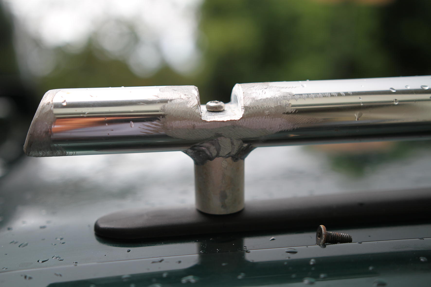

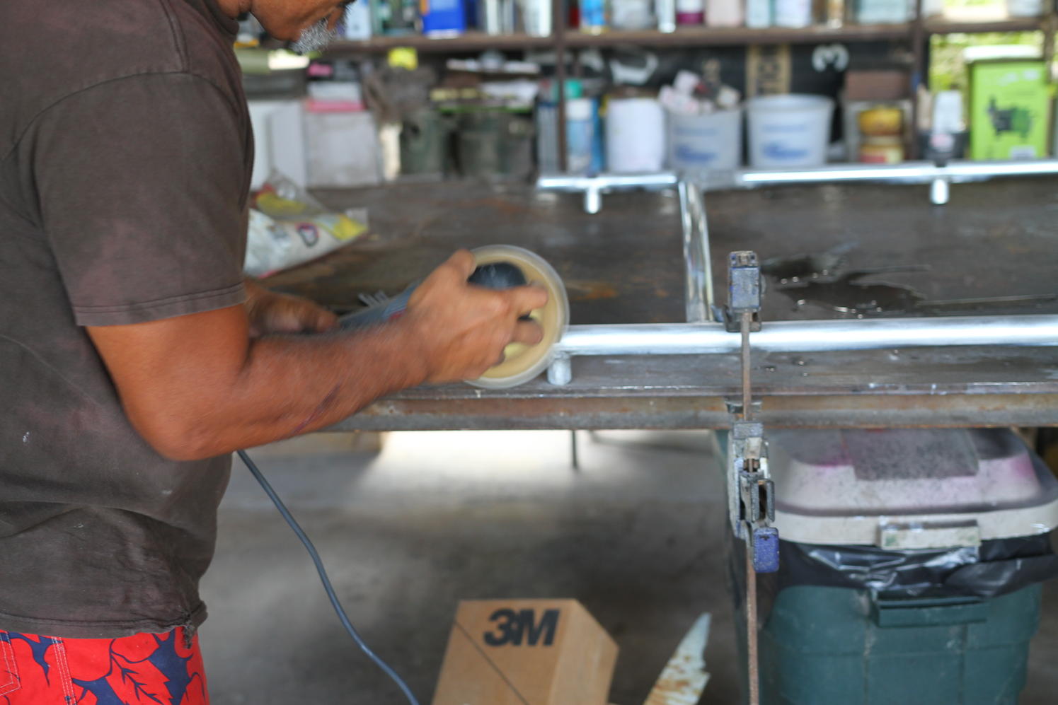

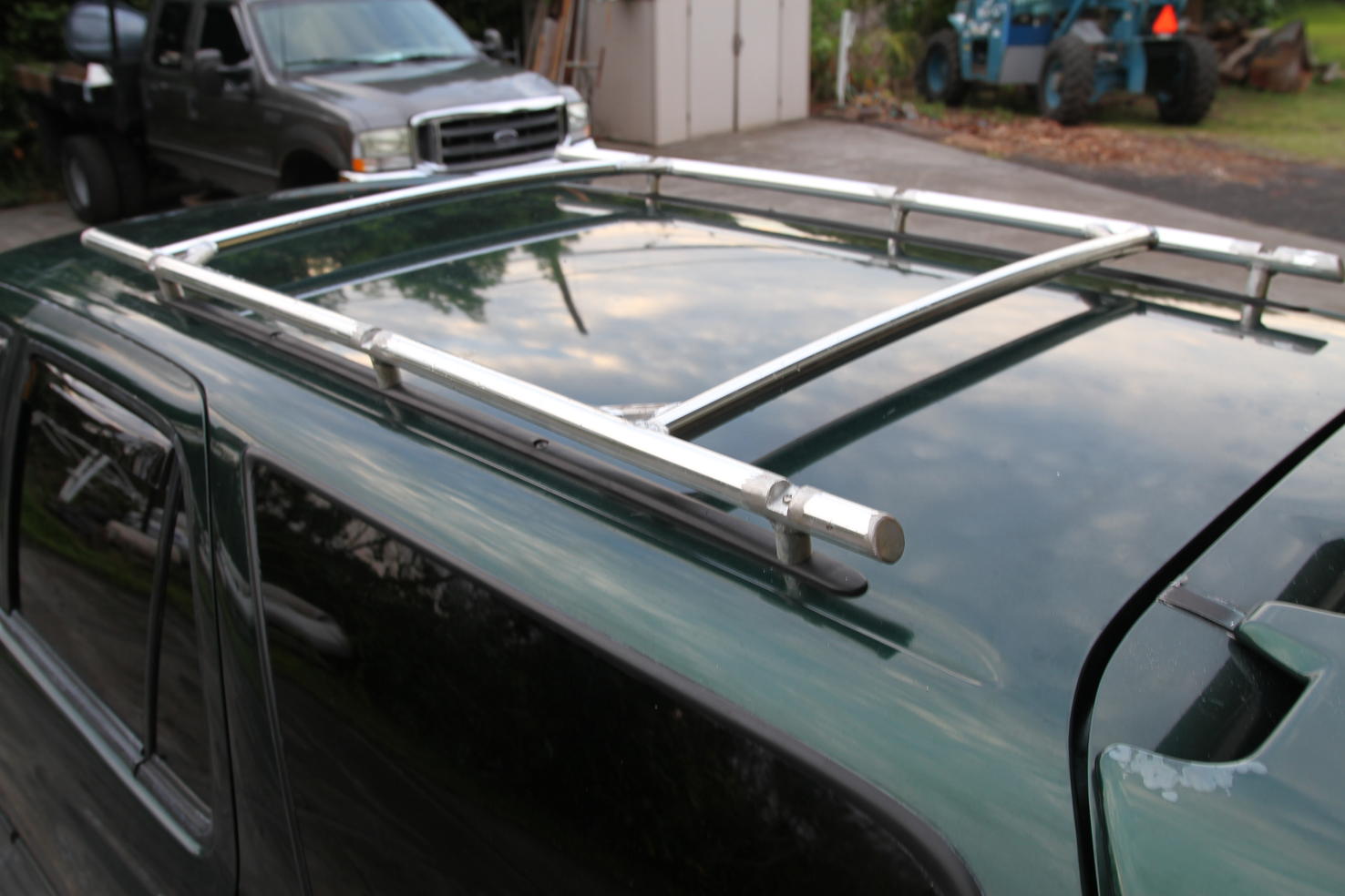

At this point you can see the black track/strip is gonna act as a gasket in between the rack and roof. We took off the track and rack to grind down the
bottom of the rack so it fits flush onto the track.

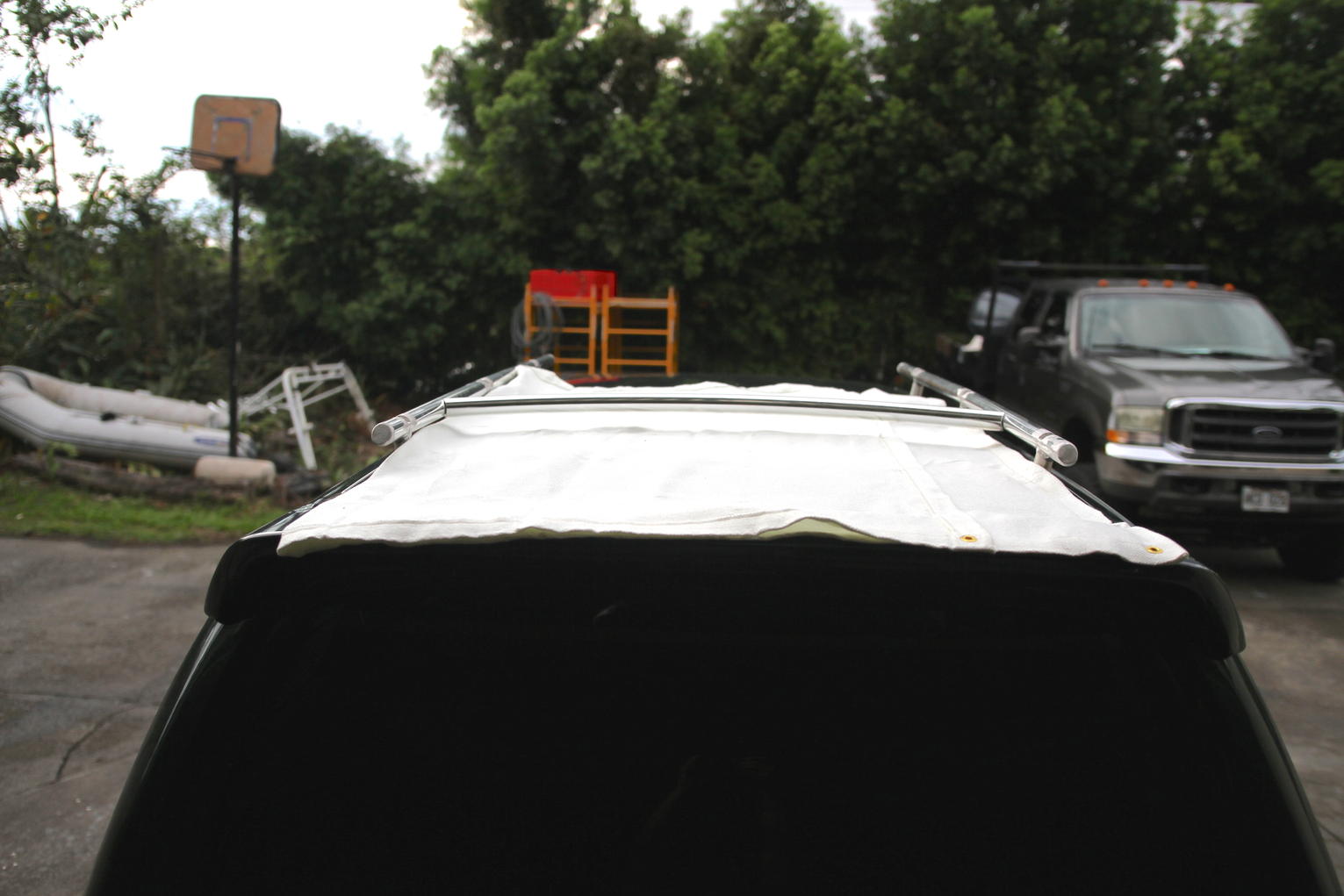

Then we fit it back on to see how it looked.
Her is a view of the area to screw in, wherever there is a screw, there is already an existing hole for the track screw. the 3 in screws we used fit perfect
with a length that was long enough to be stable but not long enough to have to go any deeper than was originally intended.

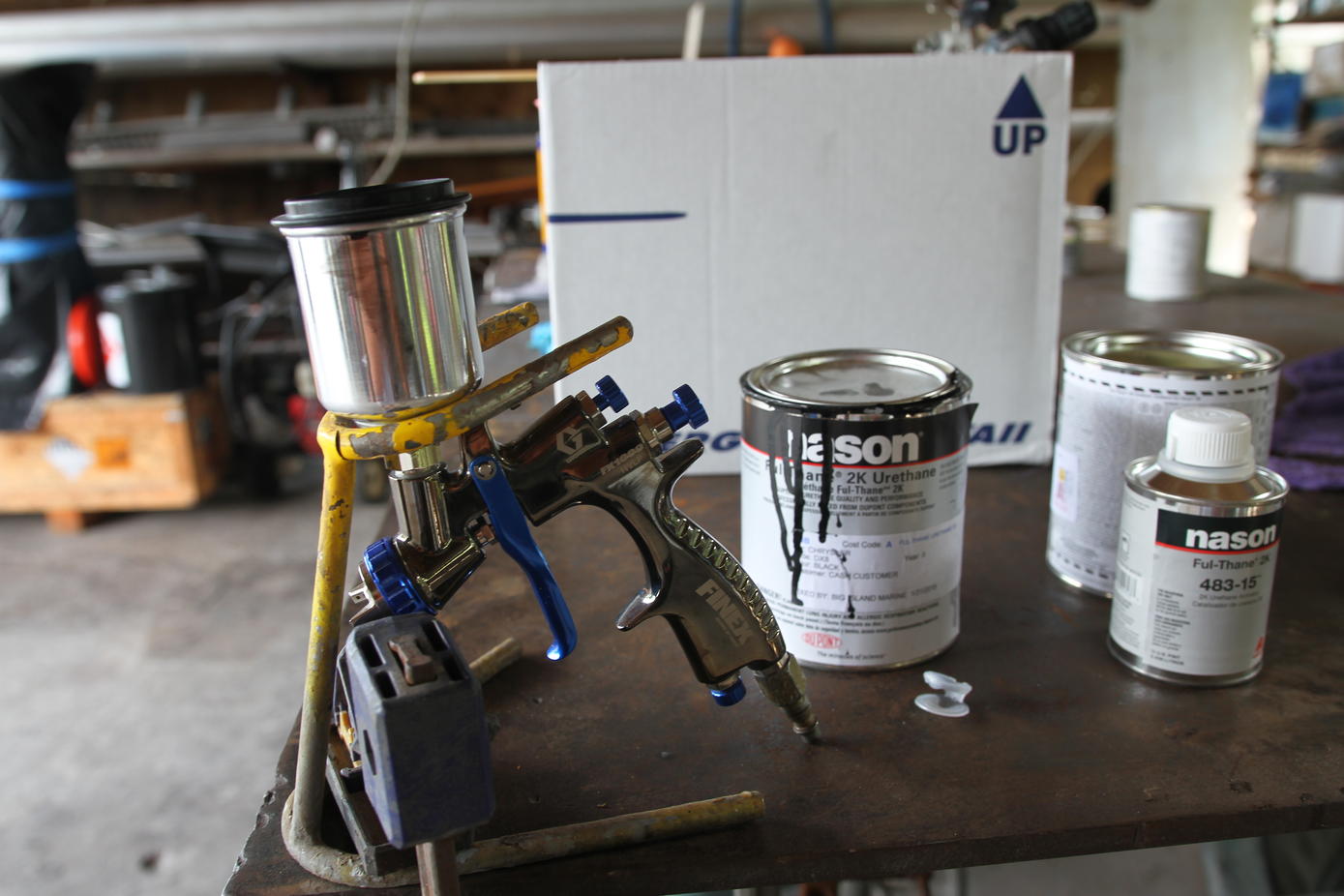

After the fitting we took it off, gave it an acid wash to even out the lack of shinyness then sanded it with 80grit then 220, then added a couple coats of primer
Used Nason black to paint it
Then before screwing all the way on we put silicon on the tip of the screw and around the gaps to keep it water tight and of course wiped it clean

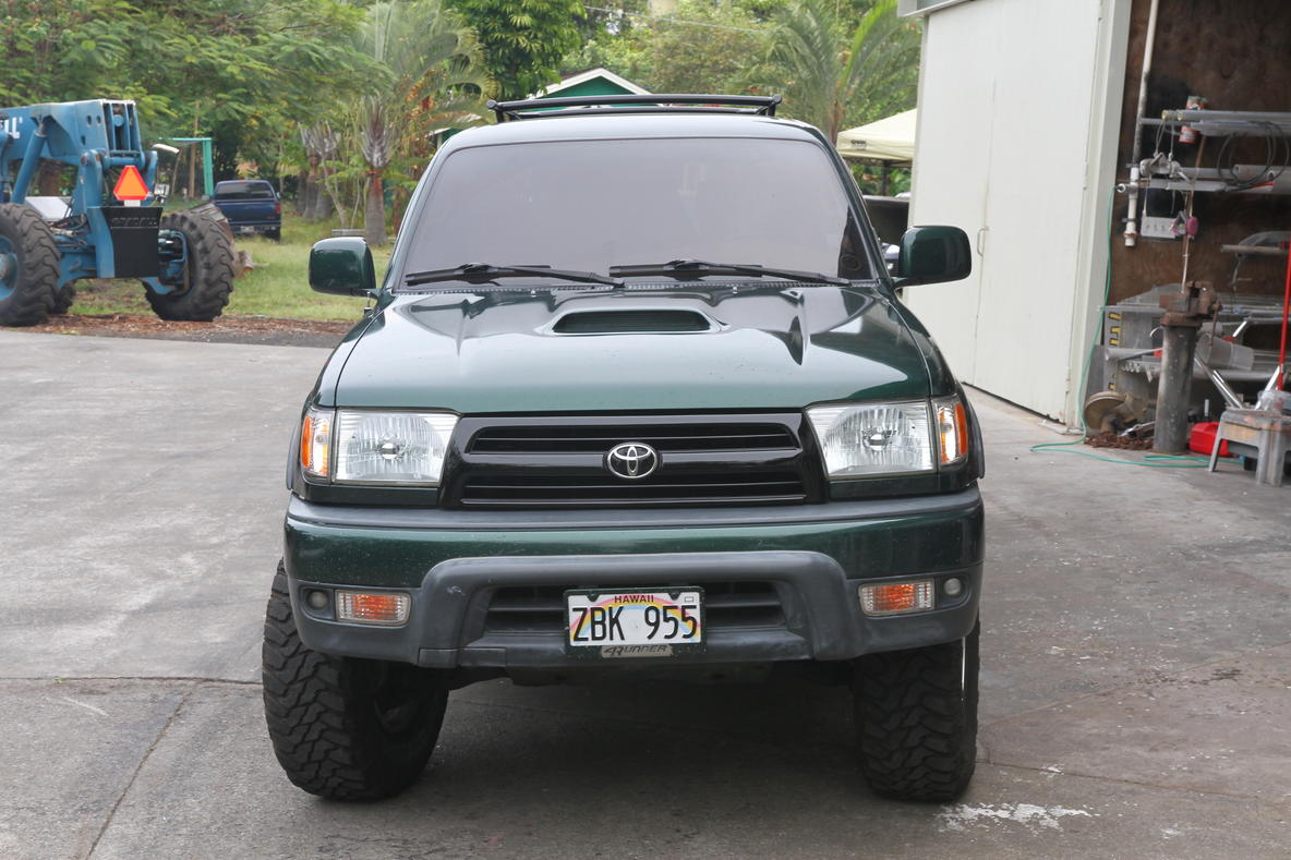

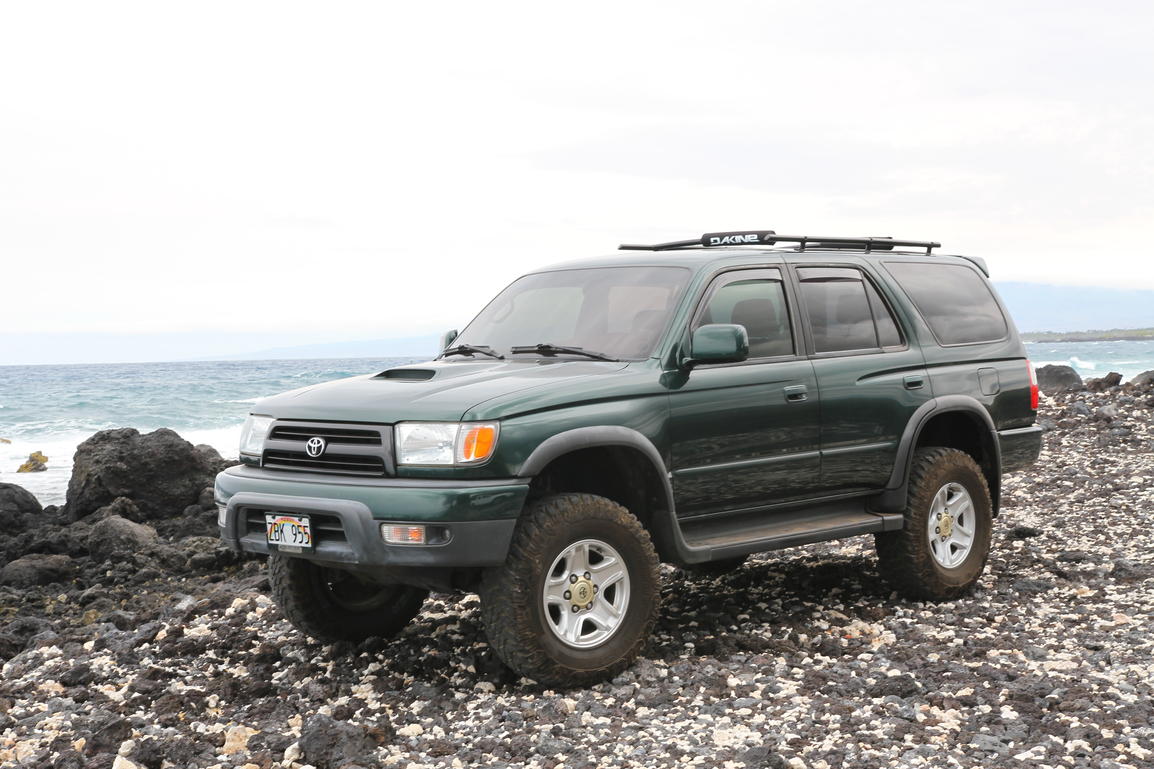

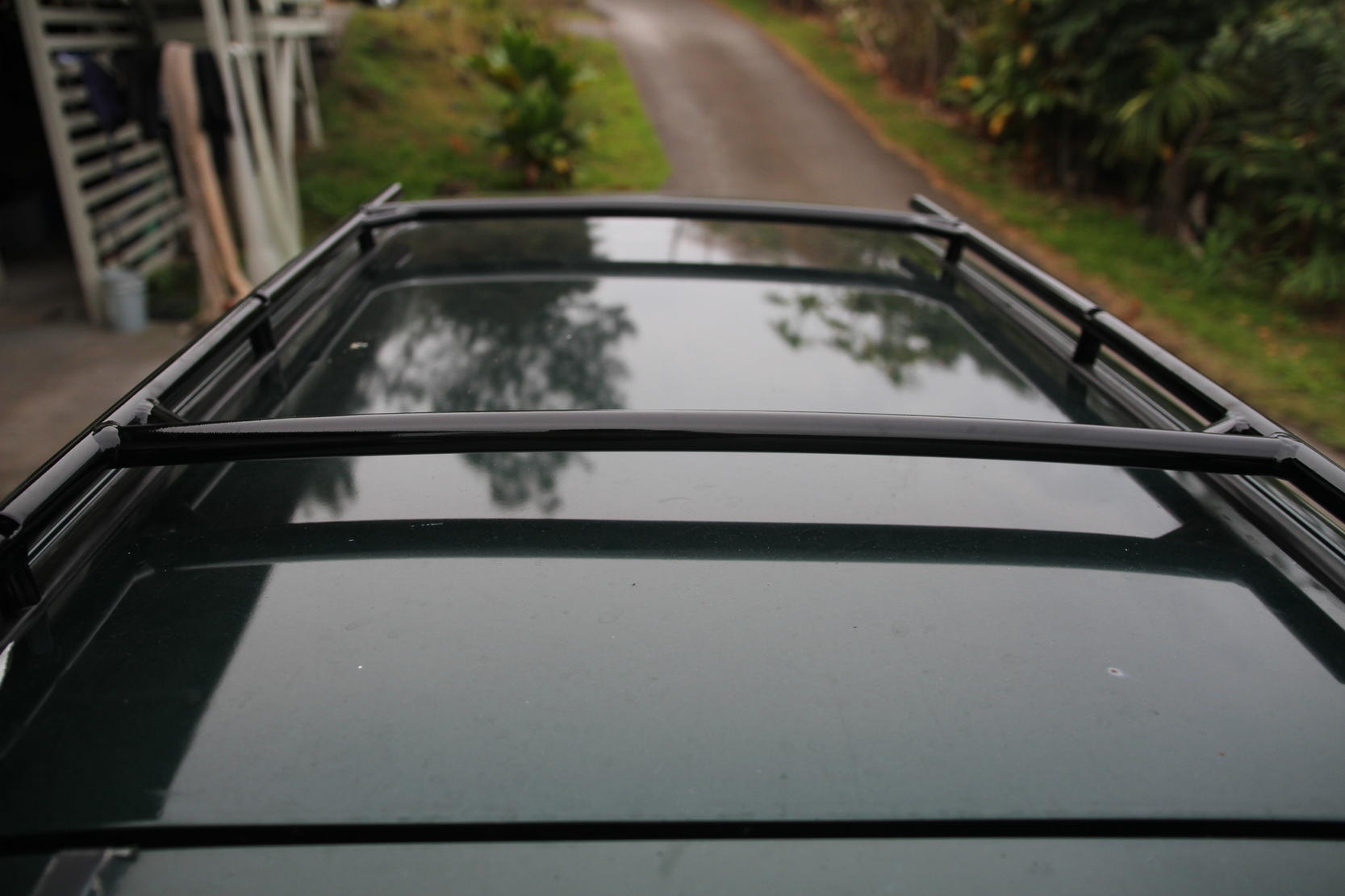

Here is the end product

Nice work! It looks solid. If you ever wanted to, you could extend the front a bit, add another crossbar, put in some mesh flooring, and you'd suddenly have one of the better looking racks on the market. The way you added radius to the tubing and triangulated the joints makes this thing look pretty solid, and I bet it's fairly light considering that you used aluminum.

Nice thing about TIG is you don't have to deal with the crazy splatter of MIG, so you can weld in your skivies!

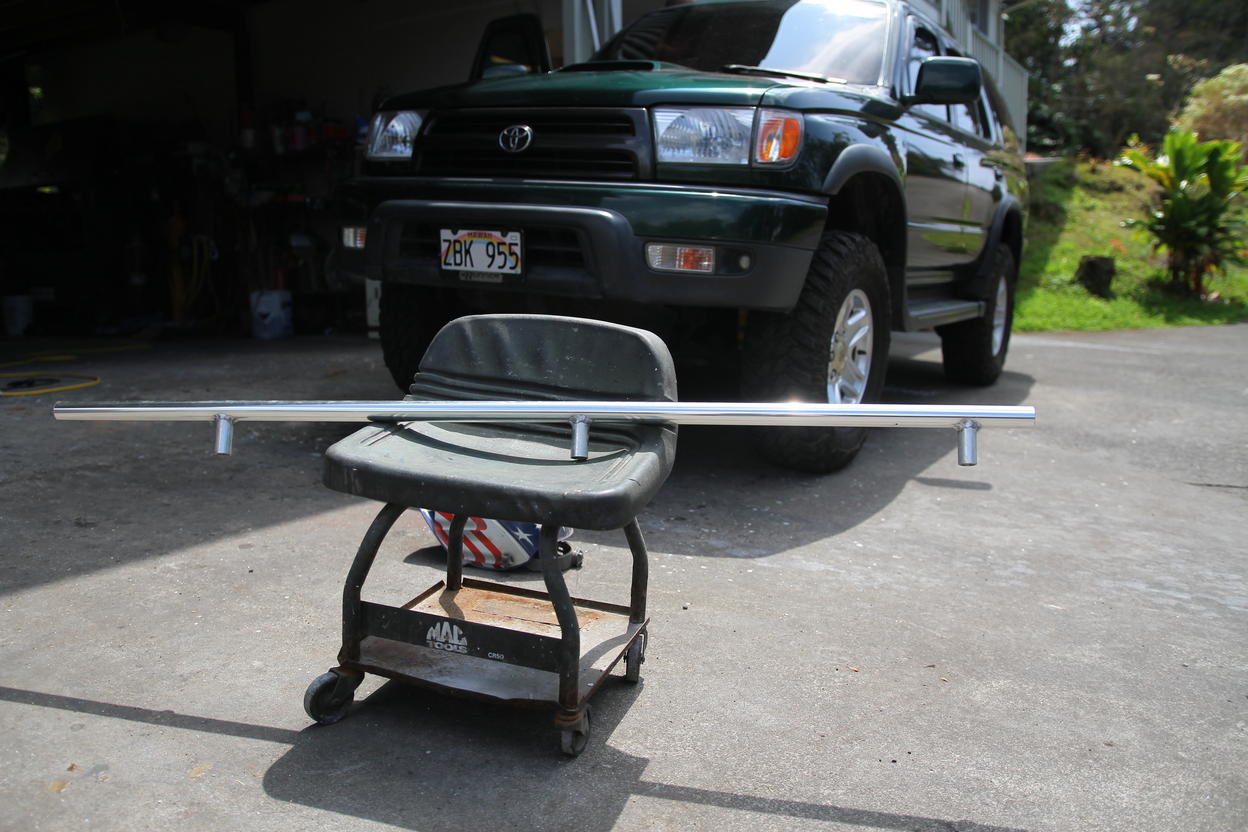

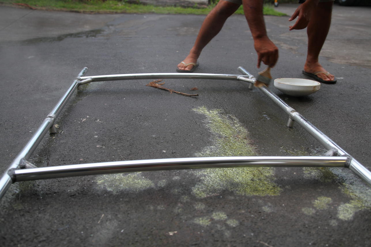

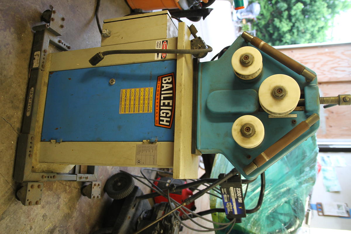

I am curious how you guys rolled the tube for the arc of the roof. Throw me a bone please, I could do it in my tubing bender but it would take forever.
Yeah lucked out, my dad used to own a fabrication shop so he has a load of pipes. Thanks for the compliment! We used a Baileigh electric roller. I thought it would have taken a while
to match the curve of the roof but just did the first crossbar little by little until it matched, then we just made the 2nd bar the same arc.
