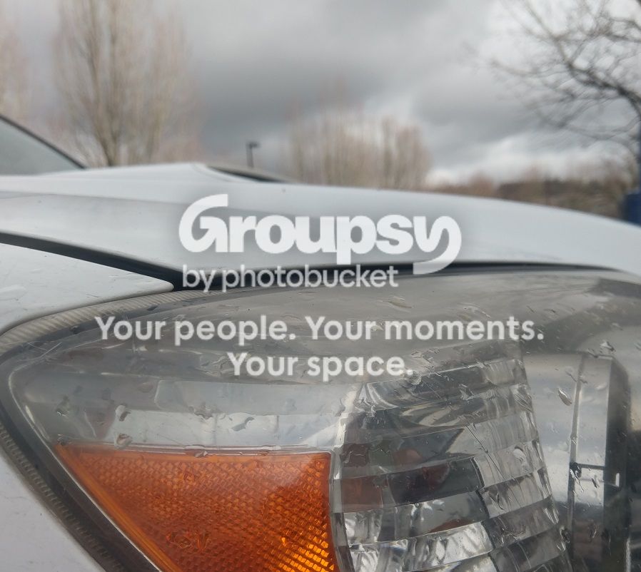

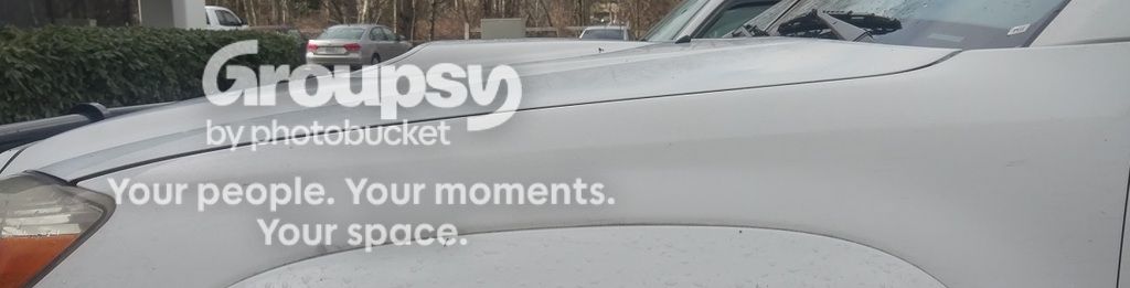

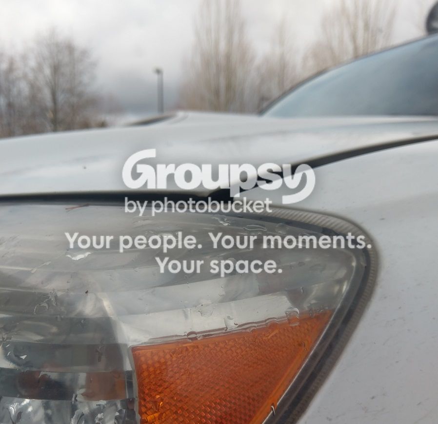

before go drilling anything, lets see some pics.
IMAG0054.jpg~original
IMAG0051.jpg~original
IMAG0053.jpg~original

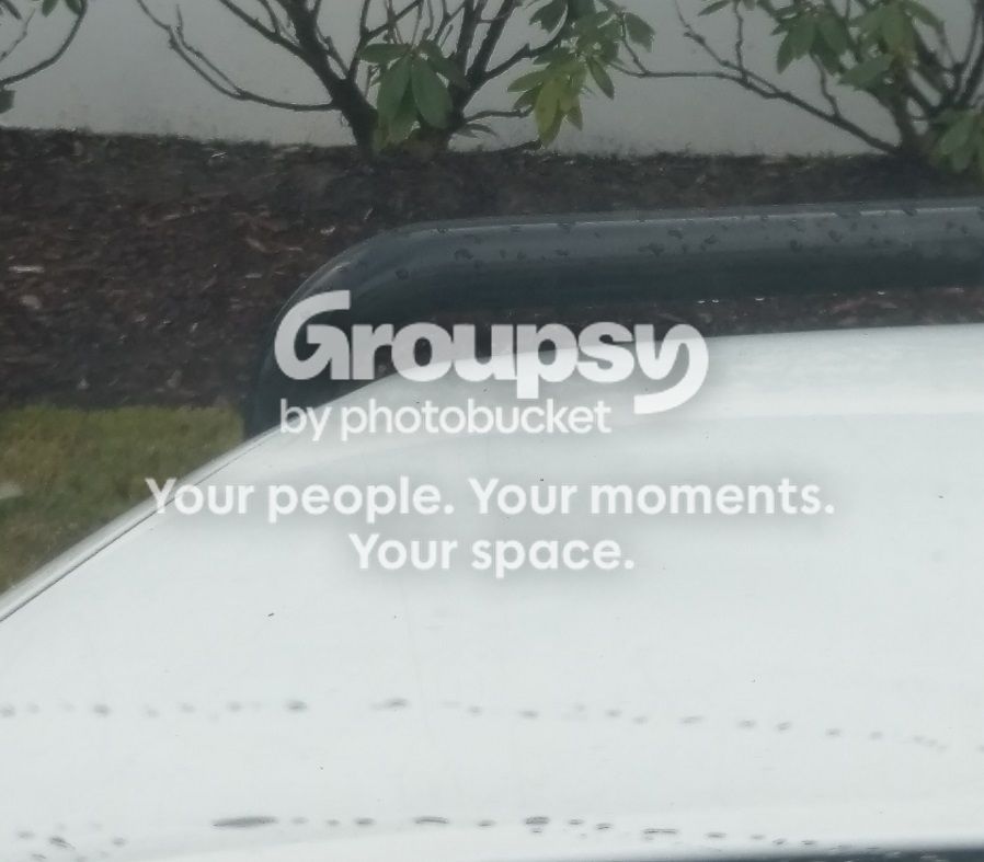

And what really drives me nuts:
IMAG0059.jpg~original
Can't stand constantly looking down my hood to see things are no longer flush.
