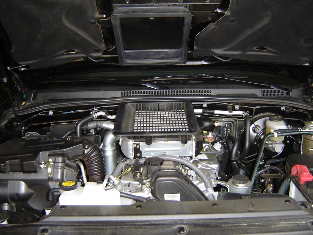

Here's the functional hood scoop.
It feeds fresh cooling air to an intercooler on the TurboDiesel version of the 4Runner, which is not available in the U.S.

This works in the area like Sahara desert or AZ where rain splash is not a problem. Otherwise the air filter will receive lots of moisture. I think that is the reason why this model is not available in US.

The air filter and intercooler are not the same thing. The airbox (where the filter is contained) is on the passenger side of the engine compartment, just like on our vehicles in North America.
The reason it's not available in the US is there is a stigma against diesel's in the US and we do not (yet) have low sulfur content diesel.

Wrong! Do you see the rubber gasket under the hood scoop? It keeps water away from the engine and only entering the intercooler.
By the way, the intercooler is a radiator, so water won't damage it.
