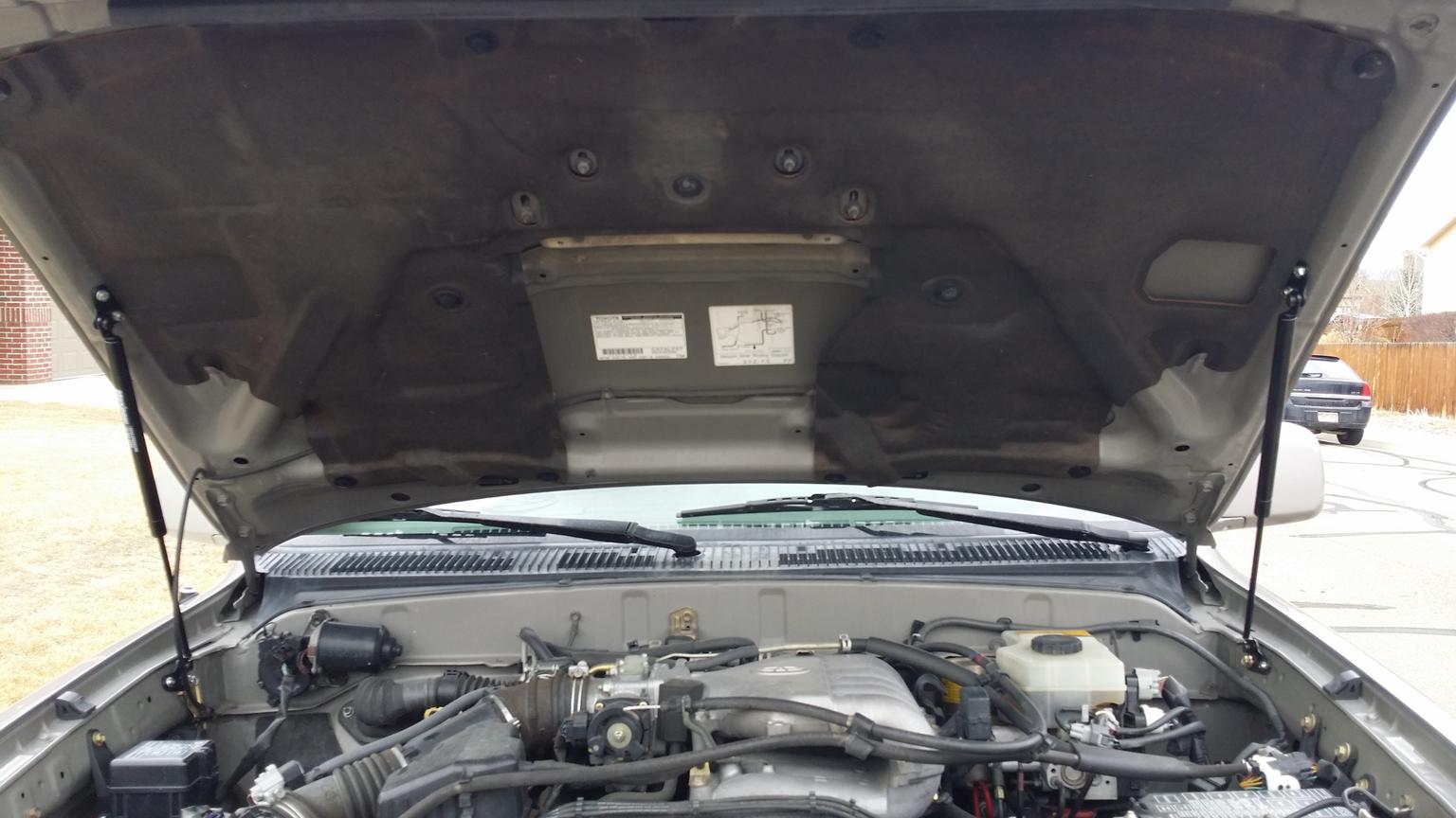

I was able to do the hood strut install thanks to Ritzy using lift supports from rear lexus lx450. Cost was 18 dollars from ebay. Instead of using rivets like Ritzy I used threaded insert and I am able to remove them when I want.

I did not take picks but would post if people want to see. I just didn't measure and just installed them so when they lift the right side stops first then the left side and it bothers me other than that it is so convenient since being short it's a pain to lift hood and hold and prop the support rod. Also my 2002 is different from the pictures and I just wire tied the washer fluid line to the bracket that I had to remove to mount the lift support.

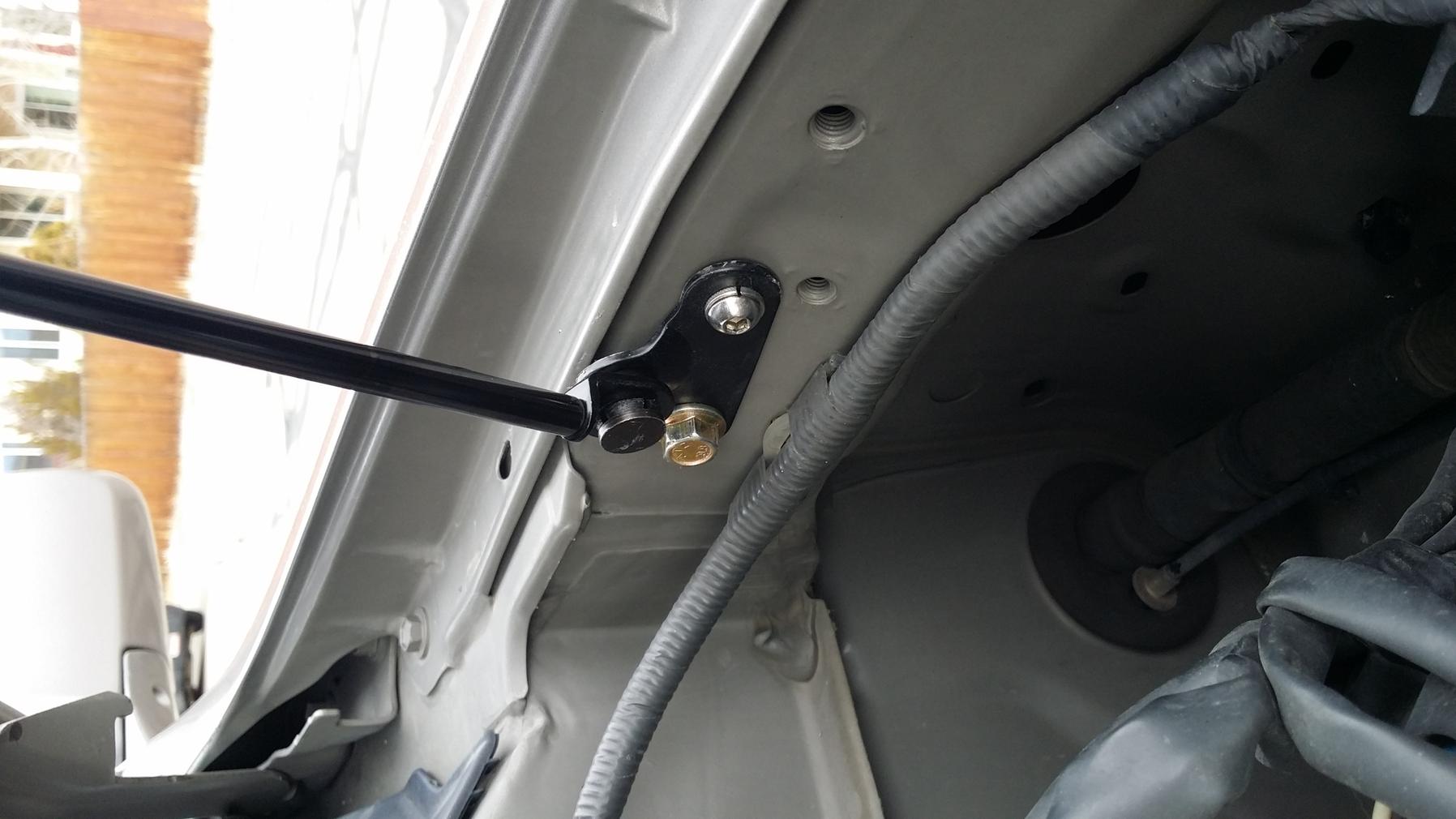

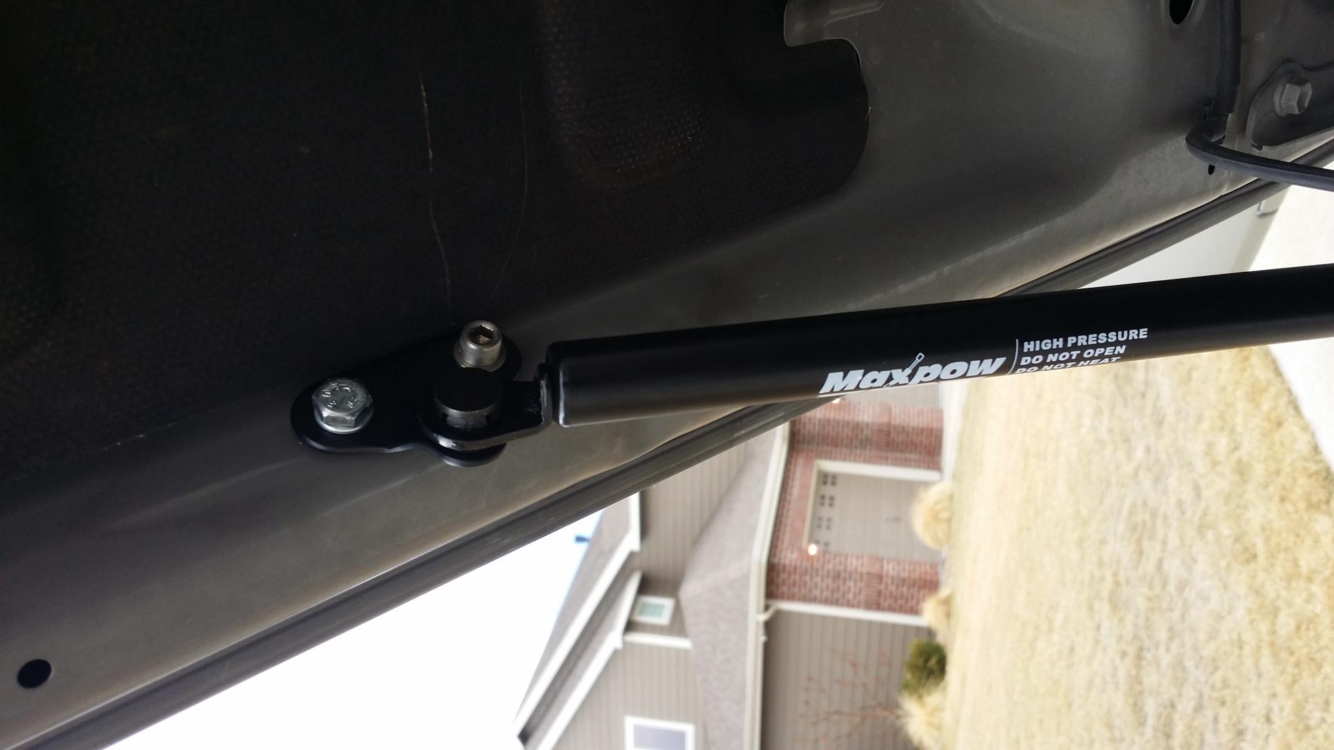

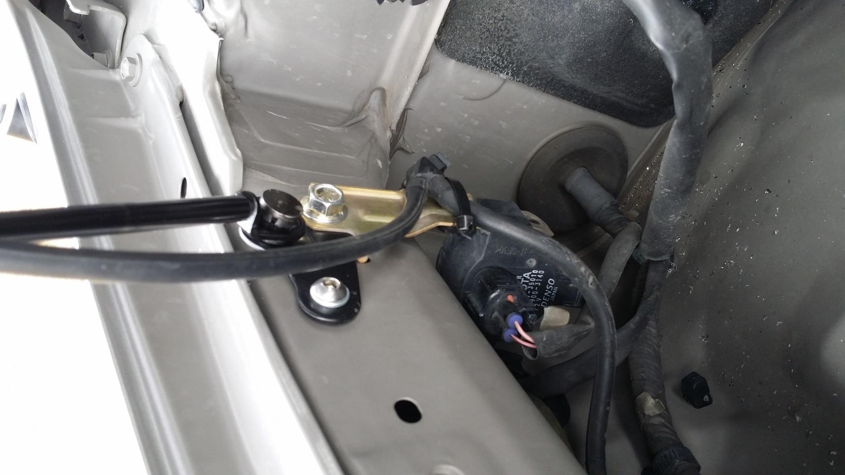

Here's my pic of the 1/4x20 bolts I use with the theaded inserts from harbor freight. I just used what I had but did change them out to all stainless button head bolts except for the 12mm headed one and there are I think 6 or 8mm pitch. I used the lexus rear lx450 struts $18 of ebay and they are hard to compress by hand but installed on the hood they compress no problem at all. Threaded insert is the way to go, remove and install whenever you want.

Thanks for the pics and reply - sorry it took me so long to get back to you
I do like the idea of threaded inserts :clap2:

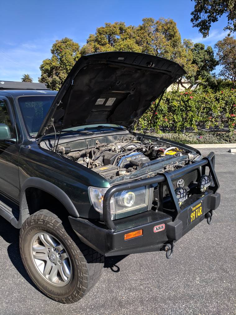

UPDATE 01/27/19
Installed a real hood strut kit developed by our own [MENTION=198376]4Runner4Leon[/MENTION], [MENTION=95238]3rdGen4Runner[/MENTION]hoodstruts on IG
My hood now opens easily, almost like magic, and stays open, taking little effort to close. Well Done, Leon!

Indeed this thread helped me develop the kit that you now have in your truck :). Thanks Mike!
Folks can find the kit here - Home - Spiker Engineering
