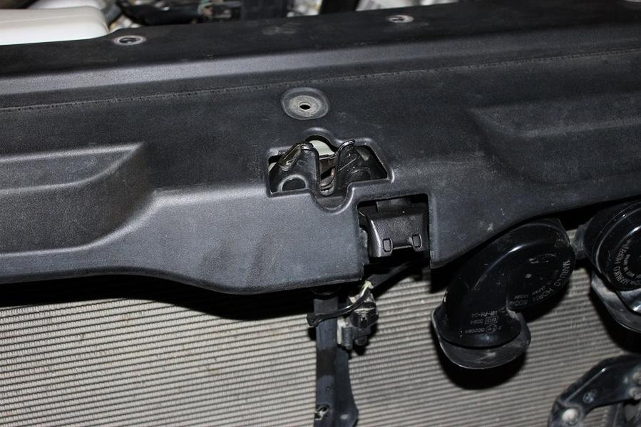

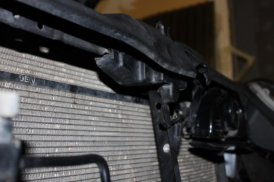

I am still unable to open my hood... have tried pulling on the cable via pliers, and or vice grips. Is there another way to pop it so I can open it? When look through the front grill I cant see much and seems there maybe bit of plastic covering where release maybe?

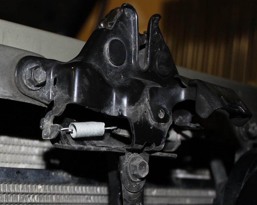

If this helps or not?

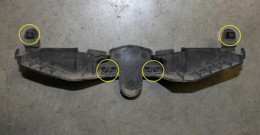

That plastic cover looks to be in the way, 4 little tabs hold it on, marked in yellow circles.

This is great! Thanks for detailed photos... wondering if can remove that plastic piece without popping the hood. Maybe break it but oh well..
That radiator top cover is most likely in the way too...had left mine off after breaking a couple to many clips and left it off.
Looks like a real pain in the rear to get at the latch through the grill.

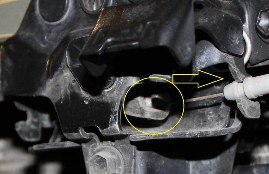

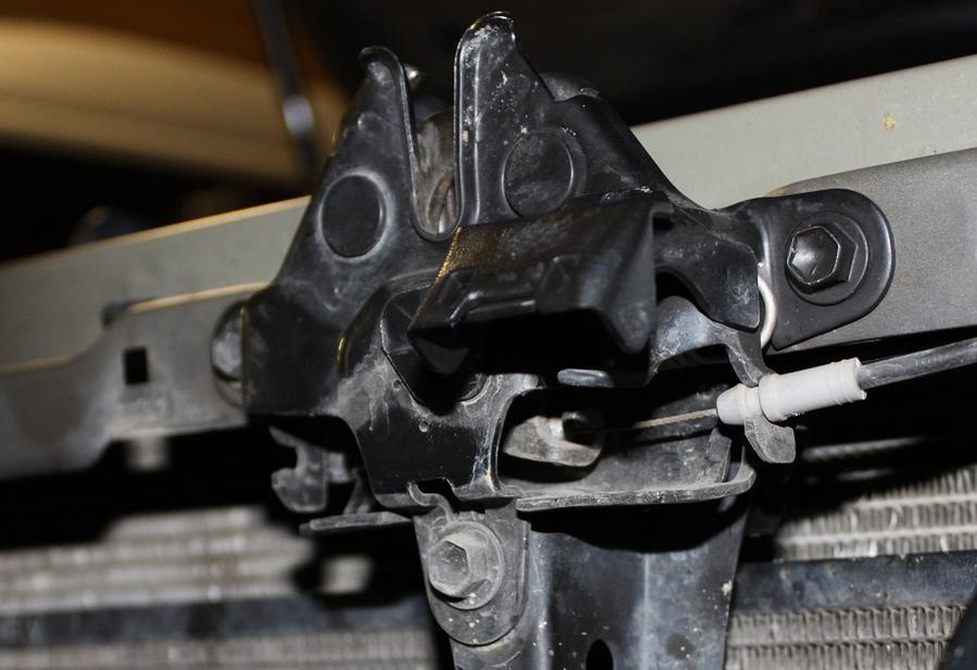

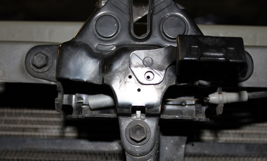

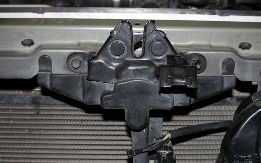

Added a couple more pics.
You would need to move the mechanism to the driver side to open.
The cable and end is just like a bicycle brake cable...for info.
Thinking out loud...
Where did the cable break at?
If it was under the dash then that would be nice if you could grab it with vise-grips.
If it broke at the latch it maybe time for that custom front grill you never knew you always wanted...:).

Damn this looks nearly impossible... Basically just the little ball broke off in the cabin. I was then using pliers etc to pull the cable and pop the hood. Currently I can pull all I want and nothing happens. I have stripped some of the plastic sheath to get hold of more wire but still nothing.
I just popped the end out of the lever, under the steering wheel.
I can pull it by hand and the hood will pop open.
