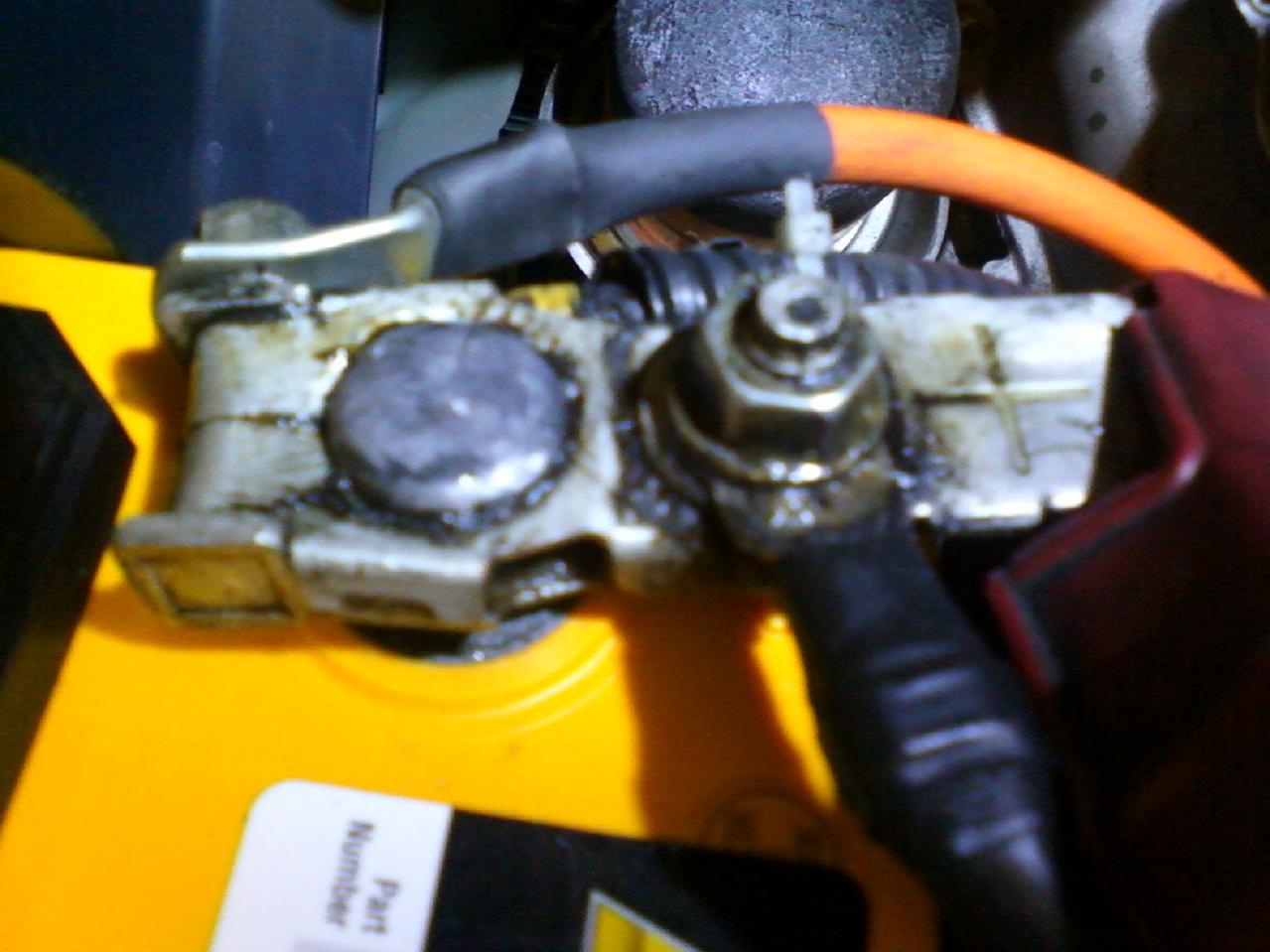

Well, this may be a dumb question. But what are the options to hooking up/powering accessories? With my 4 fog lights and CB radio my battery terminal is getting a little packed. I'm sure I'll be adding more accessories in the future and soon wont have any room to connect them! :lmao:

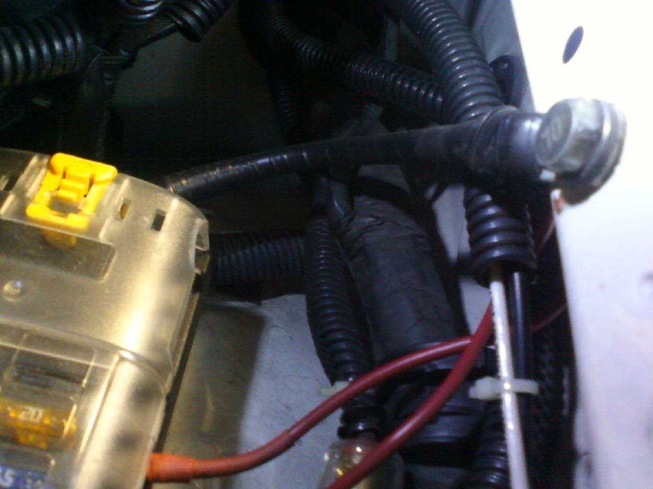

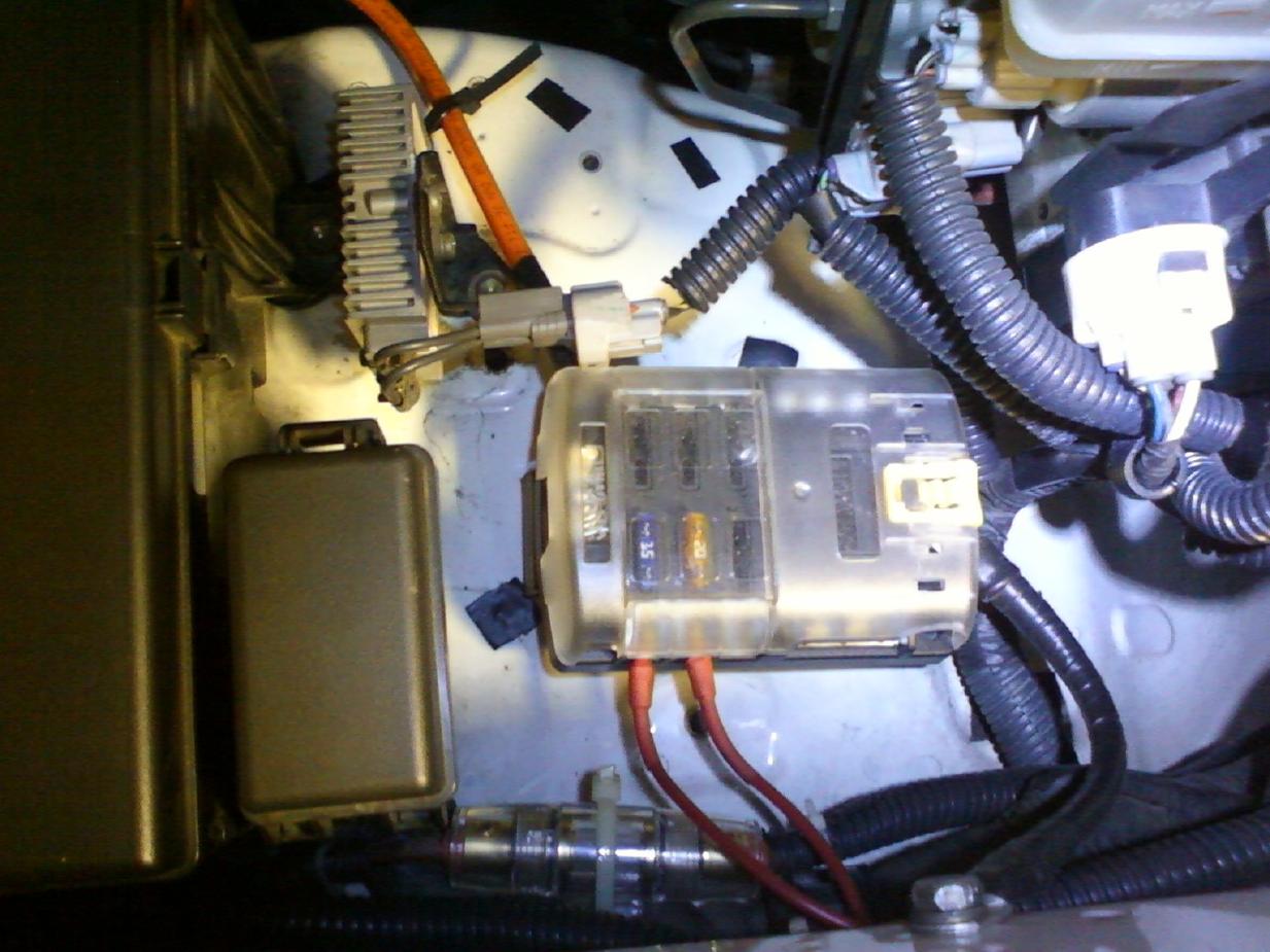

you should get a blue sea block. one wire from the + of the battery and you can ground right by the hood shock bolt for the -.
I made a C shaped bracket and bolted it to the fenderwell. It's a quick and easy way of solving your problem.
Just get yourself about 18" of #4 red and about 12" of #4 black and then 2 terminals and presto...you are ready to rock and problem is solved

WOW!! PERFECT!! Thank you very much!!

Be VERY careful adding a fuse box directly to the battery. I would suggest putting a fuse as close to the battery as possible. If there is a short (to ground) with the positive lead coming off the battery before the fuse box, you could fry every electrical circuit in the vehicle (and computers). Could TOTAL the vehicle!
