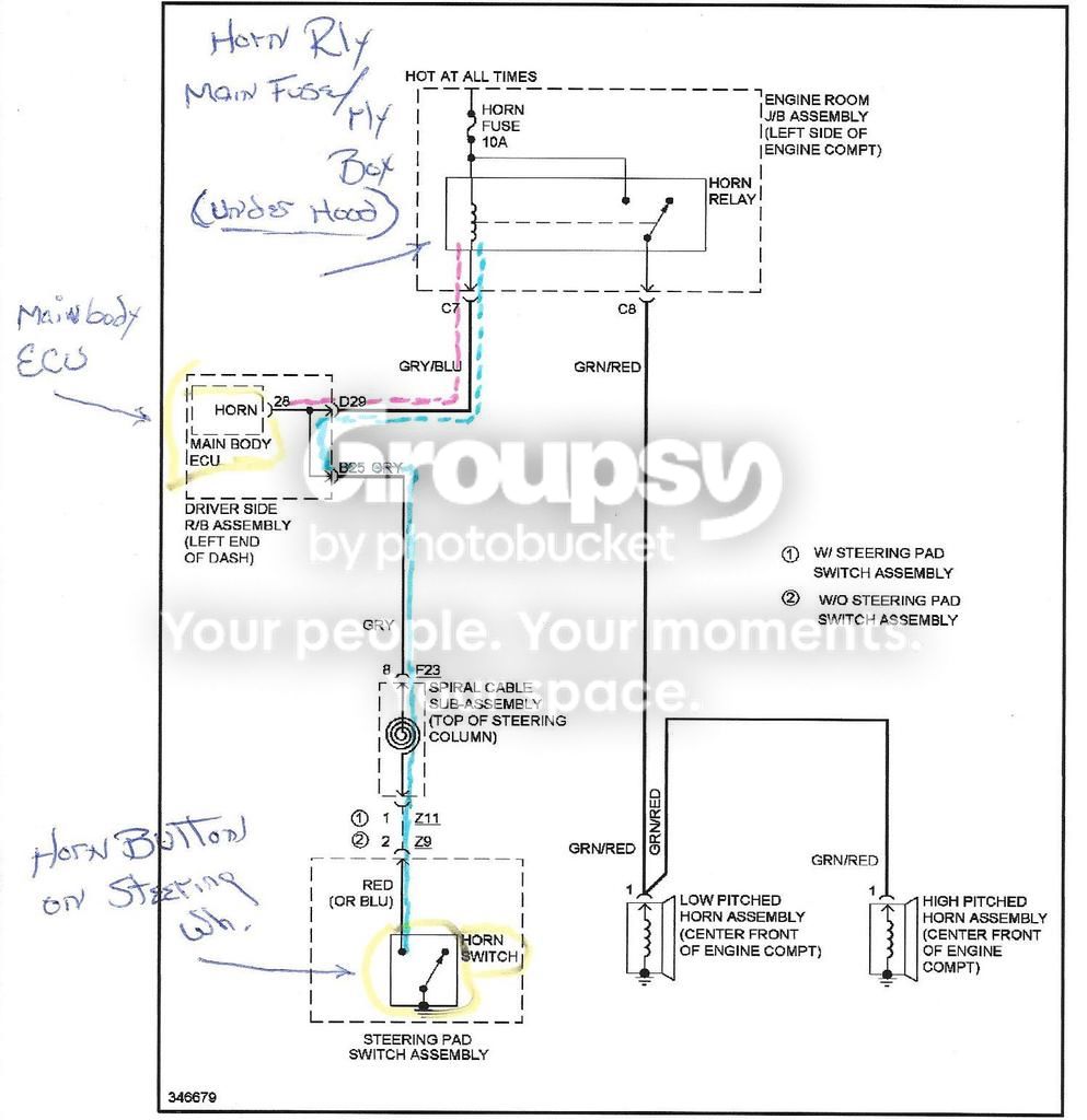

Try activating the horn by means of the 'PANIC BUTTON' on the key FOB. Doing this will eliminate/prove that the issue is NOT in the steering wheel e.g., spiral cable or related wiring. If the horn does work 'Everytime' using this method you're proving the horn relay and the two mechanical horns under the hood... here's the way the wiring is plotted:
The horn relay coil is HOT AT ALL TIMES ("see diagram") so the steering wheel pad/switch assm. only provides a ground to the relay coil, so if the fuse is good (I'll assume it is), and it works when using the panic button (which also provides a ground to the relay coil) then it should be safe to assume that there is a GND issue in the steering wheel assm.
When you press the panic button on the key FOB, you're just grounding the relay coil via the 'Main body ECU COMPU NETWORK' thus by-passing the steering wheel pad button. If the horn still doesn't work using the panic button, just remove the Green/Red wire from either one of the mechanical horns and run a jumper from the POS battery terminal to the POS (+) horn terminal; the one where the Green/Red wire was located.

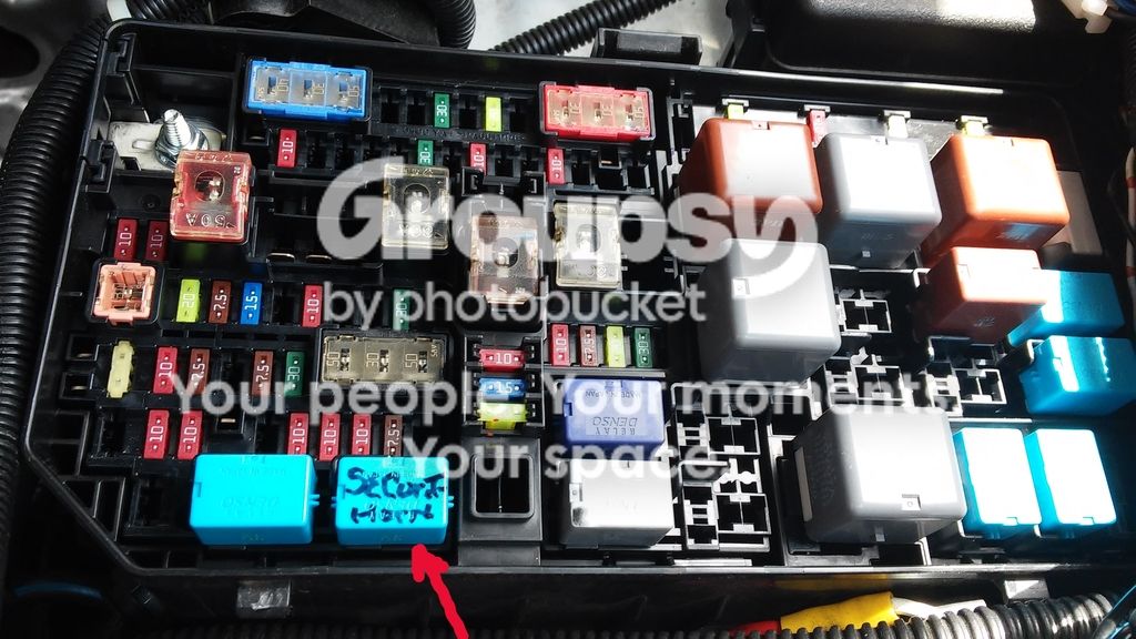

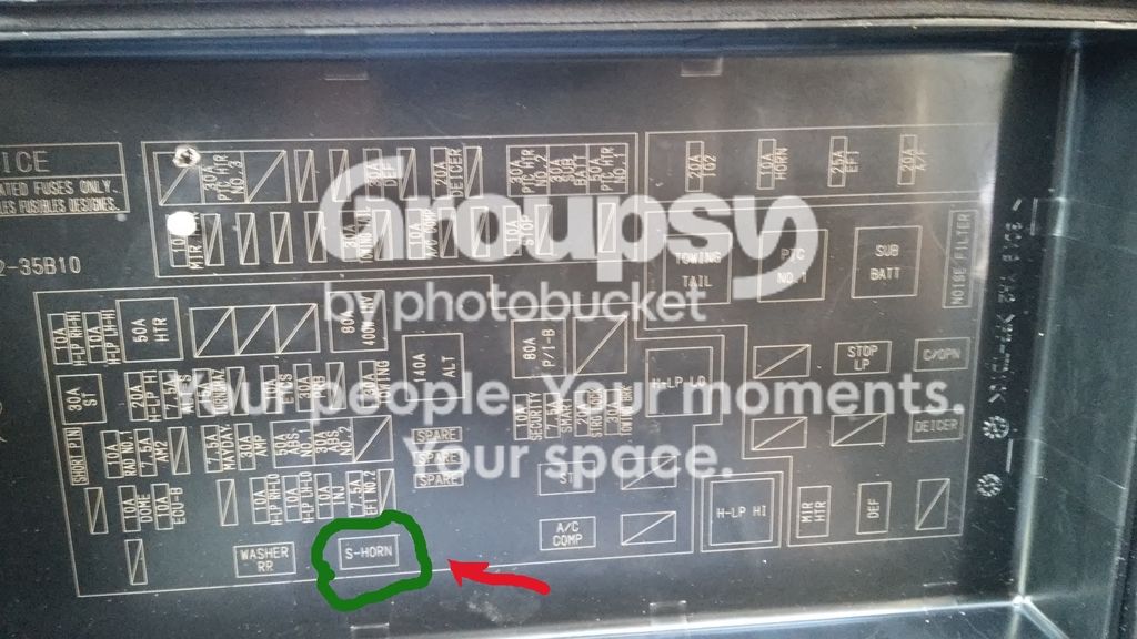

If the horn works now then you've just proved that the mechanical horns are good. Now you can remove the horn relay located in the main fuse/relay box under the hood; there's a chart on the underside of the fusebox cover to help you locate the right relay:
Pull the relay out and inspect the four spaded terminals for rust, dirt or foreign matter on the terminals and in the sockets. Clean all of those parts good... you can even spray "Brake-Clean" on the terms and in their sockets to remove any logged in dirt! Now plug the relay back in and try it again. If the terms are numbered look for #85 & #86; these are the coil terminals. You can try connecting these to the pos and Neg battery terminals... it should click! If it doesn't make a sound then there is the most likely trouble; you can p/u a new 12v relay at any Auto-Zone. This should give you somewhere to begin looking for your trouble, and be sure to let us know how you're making out, 'Best to you',

Hi Riley,
I found the link that you posted: (Dr. Fix It: Weekend Mechanic: Repairing 2000 Toyota Sienna Horn) most interesting and informative; to say the least. And given the age of the vehicle in the article and your own truck (2010) made a lot of sense. The Spiral cable (power source) and the GND are easy to check because you're only checking for power at the horn switch, and then a GND source under the pad using and ohm meter.
I don't imagine the spiral cable would be too difficult to replace... remember: google is your friend! If it were my truck I would first remove the steering wheel pad then run a jumper from the S/W to a body ground just to see if there is a ground issue; and power supply is easy to check! I'll bet if you search the [MENTION=65614]Antman[/MENTION] thread you'll find all the relative information that you need to do the job! Thanks for posting that link... I'll bet I'm not the only member here who didn't know that the steering wheel ground isn't "HARD WIRED"!
