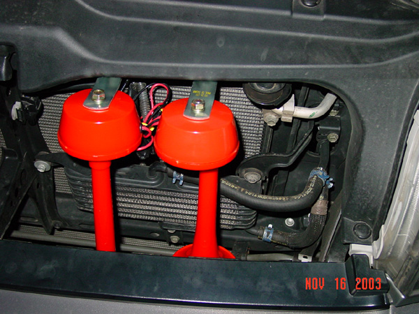

I went to Pep Boys yesterday to see what they had for horns. They had a wide selection on AirHorns which is what I have been installing on my past 4 vehicles, and I can say three things about them:
They are loud
They piss people off
They take too long to install for something I don't use that much
Except that time when I used to do deliveries to this dock which you needed a loud horn to get the guys attention I yet to really need them. So I got these twin horns which are fairly loud (not as loud as the air horns) but loud enough, and the install took 30 minutes once we realized what we thought was the ground, actually wasn't. Oh they are 118DB's. I'll try to make a sound clip when I get a chance. The best way I can think of doing that is recording it with my Ipaq, but of course I have to be the one infront of them. Greeaatttt

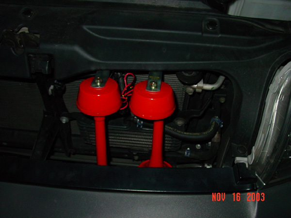

Another pic of them. Next comes my foglights. Still trying to figure out how I am going to get through the firewall to the center console area. Any suggestions???

I don't see it being that hard. Even with Air Horns, all you need to do is remove the existing horns or just unplug them, and use that plug to make the connections. I never cut the plugs, I just put ends on the ends of the wires and slide the ends into the plugs. As long as you follow the directions, use the existing plugs, and the horns are accessible (which in my Passport they were not) then you are in the clear. Look at where I put my horns, they are really easy to get to.

Not hard at all. Here is a tip me and my buddy figured out during the troubleshooting process. There is a clip for each horn (there is two), so we thought that one of the two was the ground: WRONG!!! Turned out when we reconnected them and they still did not work, is when we realized that they needed to be bolted in, hence being the ground. So when installing new horns, use the ground wire and attached it to one of the bolts holding the horn in.
