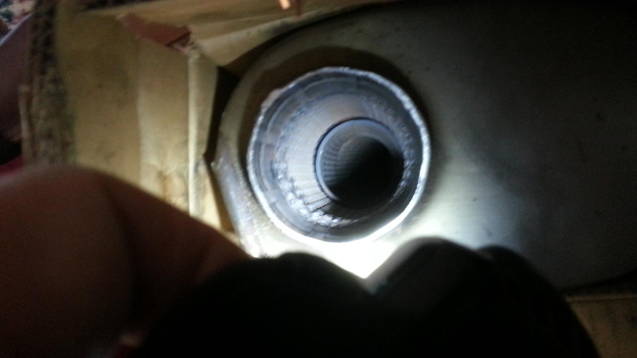

OK found out the deal with the Magnaflow.
On the longer mufflers like the 12286 the inner perforated tube especially on the center/off center ones is in at least 2 pieces and they come apart and bang against each other.
Literally designed to fail.
The short Magnaflows do not have this problem nor does the Borla which is about the same size as the Magnaflow.
The Borla uses ONE tube that is bent to fit and has Stainless Steel Wool and Ceramic Batting instead of Fiberglass.
It is also quieter than the Magnaflow at idle, has zero drone and sounds pretty darn good when you get on it.
Cost was $60 more and I should have went with it from the start.
Will try to make a clip of it and also show the Magnaflow.
So for anyone looking a nice quiet muffler that breathes far better than stock and has a nice growl when you are getting on it I would recommend the Borla 40664 (2 1/4") or 40665 (2 1/2").

This is a horrible picture unfortunately but it shows the design failure of this particular magnaflow.
The 2 piece inner perforated tube is designed to fail.
So if you buy a Magnaflow and you can actually pick it up and look into it before doing so then I recommend NOT buying it if it has a 2 piece inner tube.
It WILL fail.

Your 14" one is probably fine because the inner perforated tube is ONE PIECE.
On the larger 19" one that COB and I had especially the one that fits the 4Runner which is Center/Offset so the tube has to bend and it is 2 Piece in the larger Magnaflow's.
THAT one WILL fail, it is literally designed to fail.
The Borla I just bought is the same size, 19" and it does not have a 2 piece inner perforated pipe, it is one piece. Will probably last me at least 15 years without a problem.
