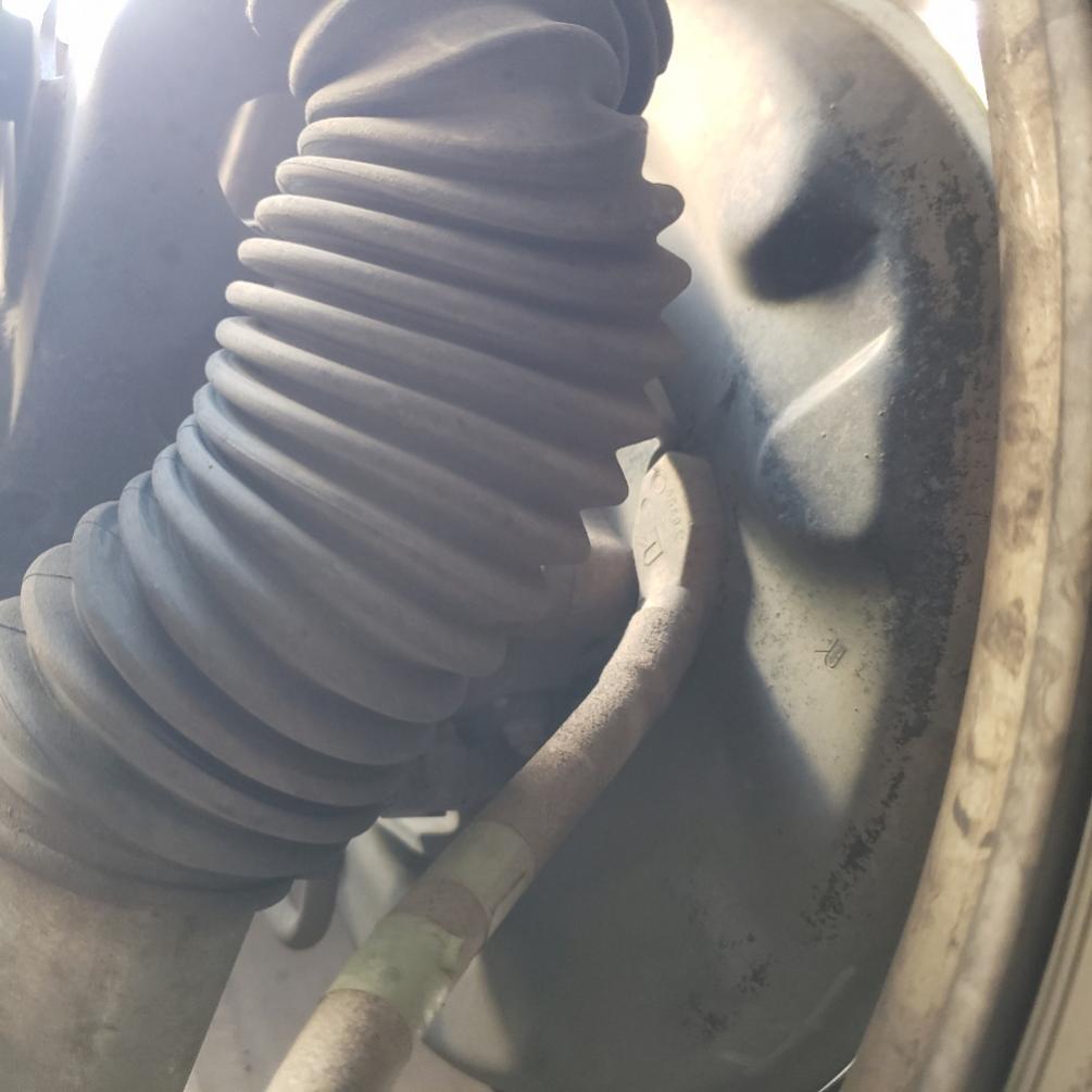

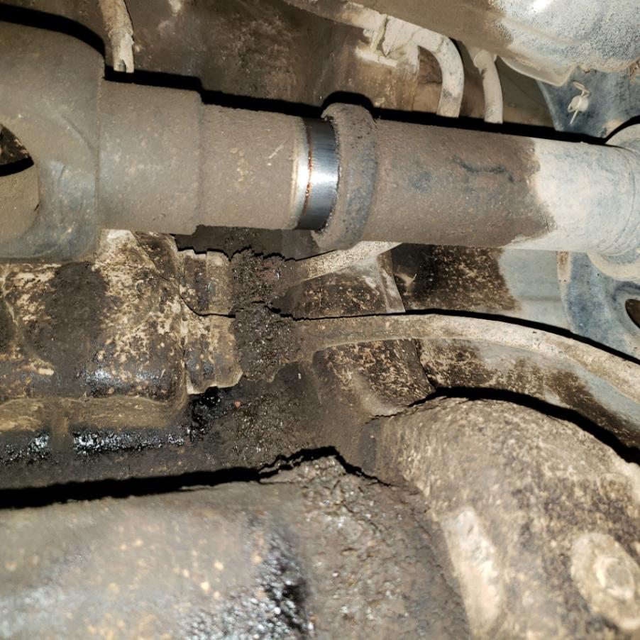

These pix are from under my 2003 V8. In crawling underneath I see a couple rubber hoses going from the center, near the gas tank, to each of the rear wheels (bottom pix). I've not noticed these before. They are different from the hydraulic brake lines.
And I notice there is something oozing out of the start of both lines, where they connect near the gas tank (top pix).
I'm having an issue with brake fluid leaking from the master, but I've been unable to locate the leak - what are these lines and do they have anything to do with the brakes?

Those are the parking brake cables. They run from the parking brake pedal, thru the bottom of the center console and come out where you see in that first picture. So yes, they are part of the brake system but are purely mechanical.
The ooze that you see appears to actually be from your driveshaft, which is flinging extra grease out and it just so happens those 2 parking brake cables exit the body at the same point.

Thanks! I thought it might have something to do with parking brake . . . And an interesting coincidence with the shaft grease!
