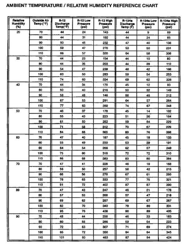

You can also use a thermometer to measure the outside air, then stick it in the vent and measure that. The A/C should reduce the air temp by roughly 40ºF.

You can be a little more precise than that. You only get 40°F at 30% humidity. I use the attached chart. If you can get within two degrees of the R-134a discharge temp. for the ambient temp. and humidity, you gotta figure system is in pretty good shape for its age. I have been able to get it spot on these last two summers.
