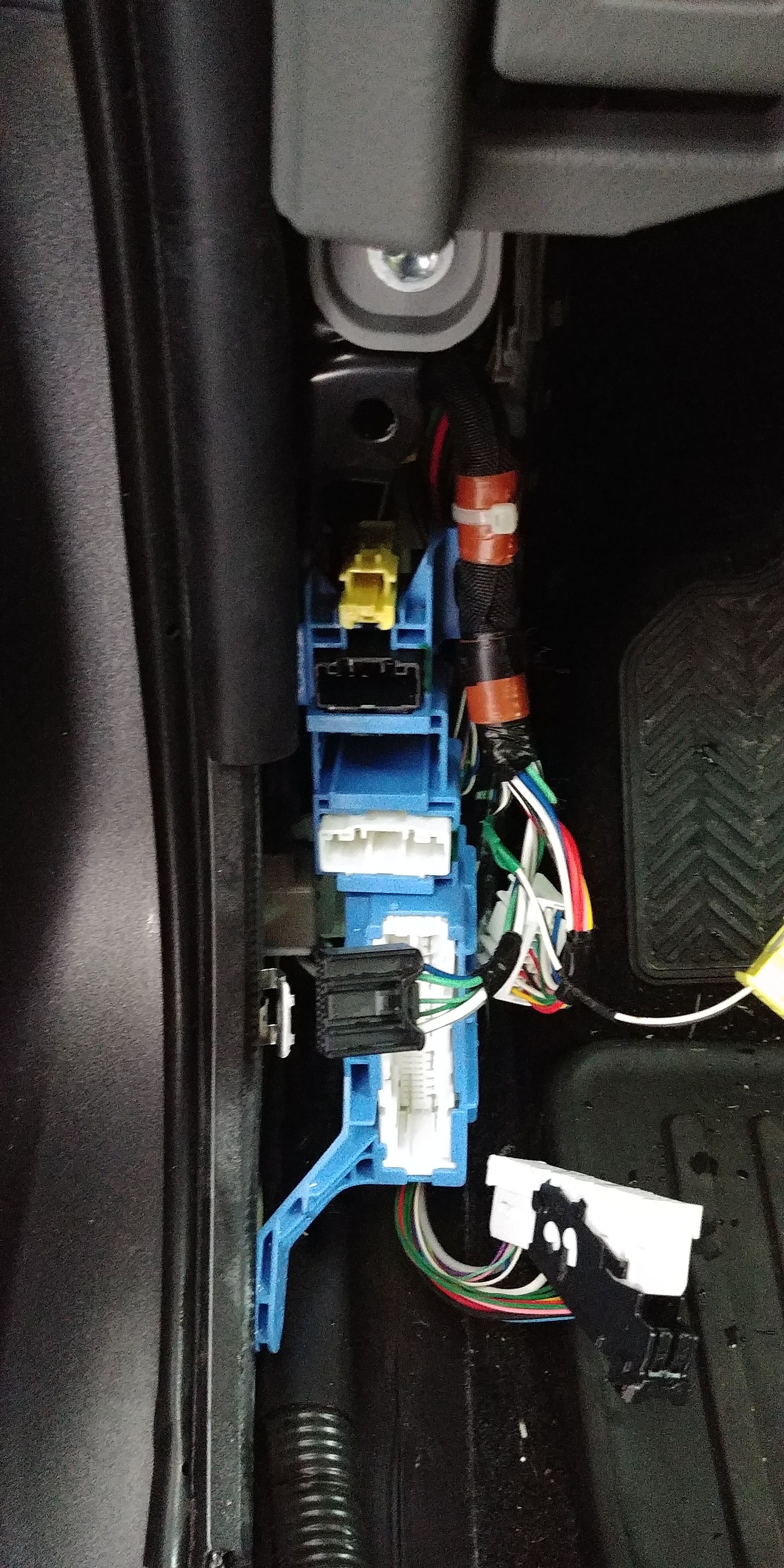

We had purchased our 2010 sr5 about 45 days ago and all has been well. Today we had the airbag light come on. "great" we said. I searched here and checked the connections under the seats w/o disconnecting. I remembered feeling some water drip on my left foot after a heavy rainstorm.
I investigated and found water in the connections in the kick panel as pictured below. I used air and blew it dry and it'll be drying overnight unplugged.

Thanks all for the help. It dried out overnight and the airbag light went out and all is well for now. We washed the rig tonight too and made sure to keep spraying at the leak points and so far so good.
