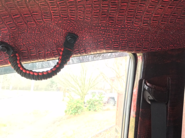

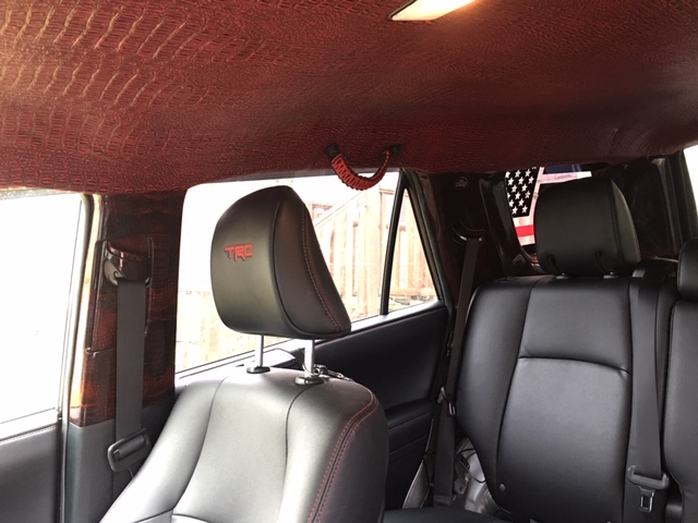

I reupholstered my headliner cuz I hated the puke tan color.
