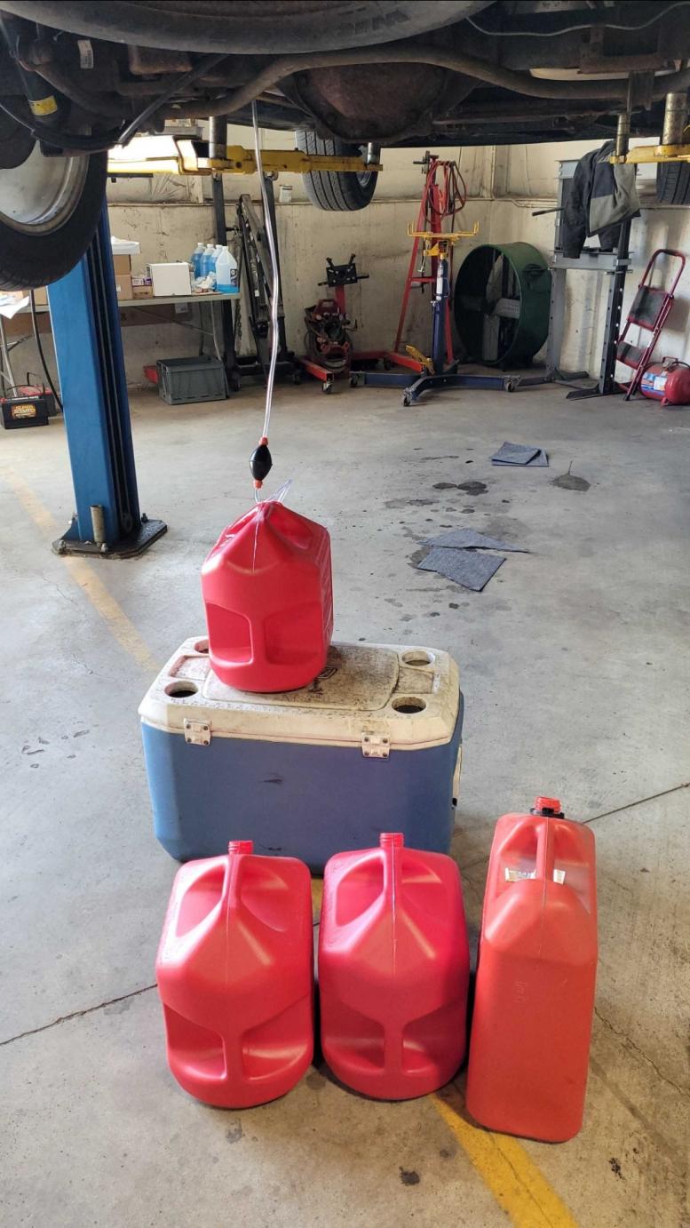

They slosh back and force some thing awful. I just did one in and Escalade with a 26 gallon tank. I got all but about 5 or 6 gallons out (it was Full when I started on it)... I have a transmission jack mind you... Getting it down wasn't so bad. Hut getting it off the ground back onto the tranny jack by myself was brutal. I nearly dropped it a few times before finding a better way.. To get it up there. If you have access to 2 Jack's that would help.

Get a hand pump siphon, they're super cheap. And have some gas cans ready...
Here's me doing the escalade with a siphon..
