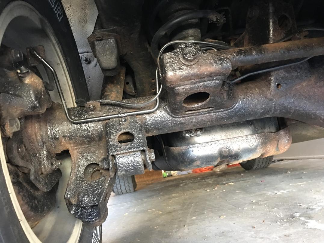

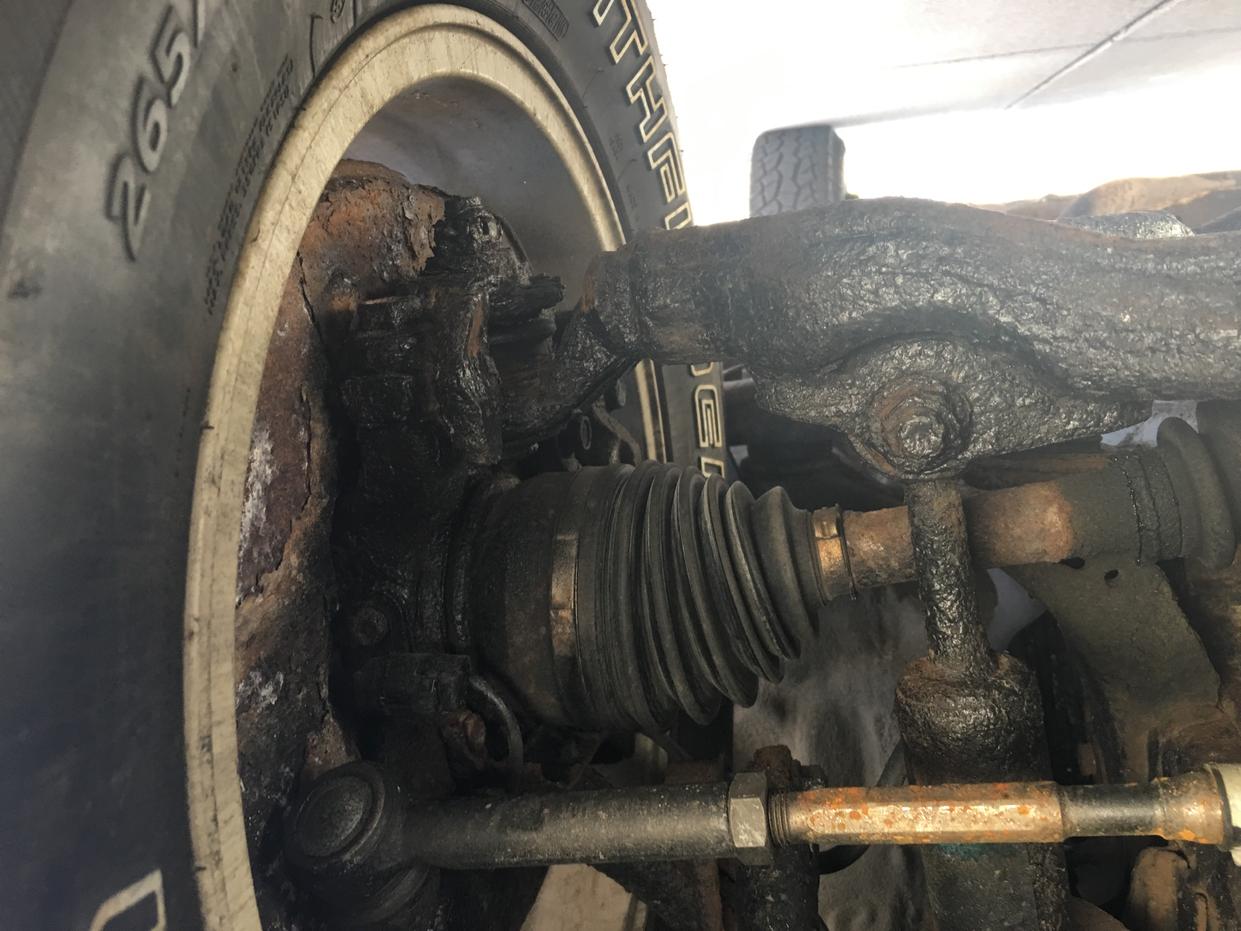

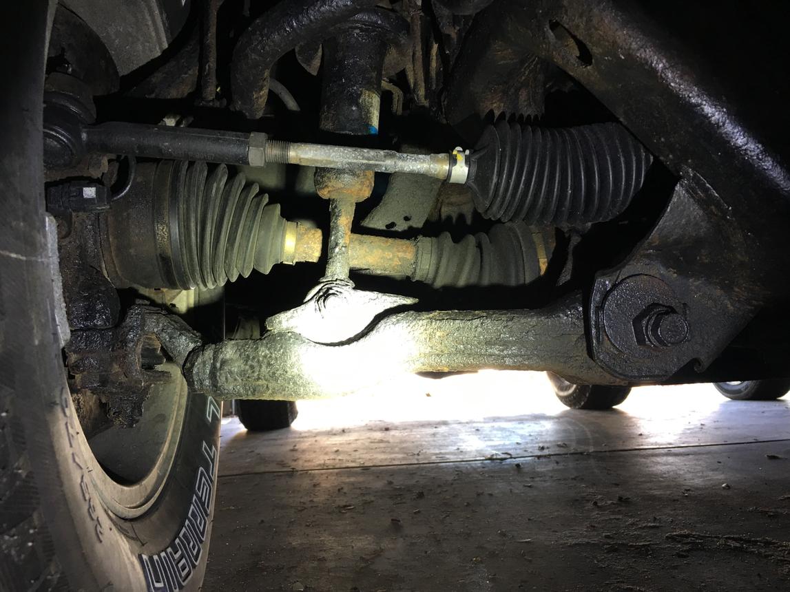

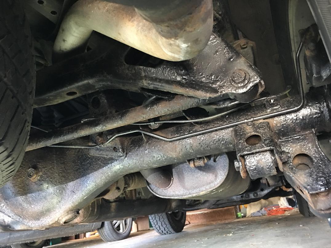

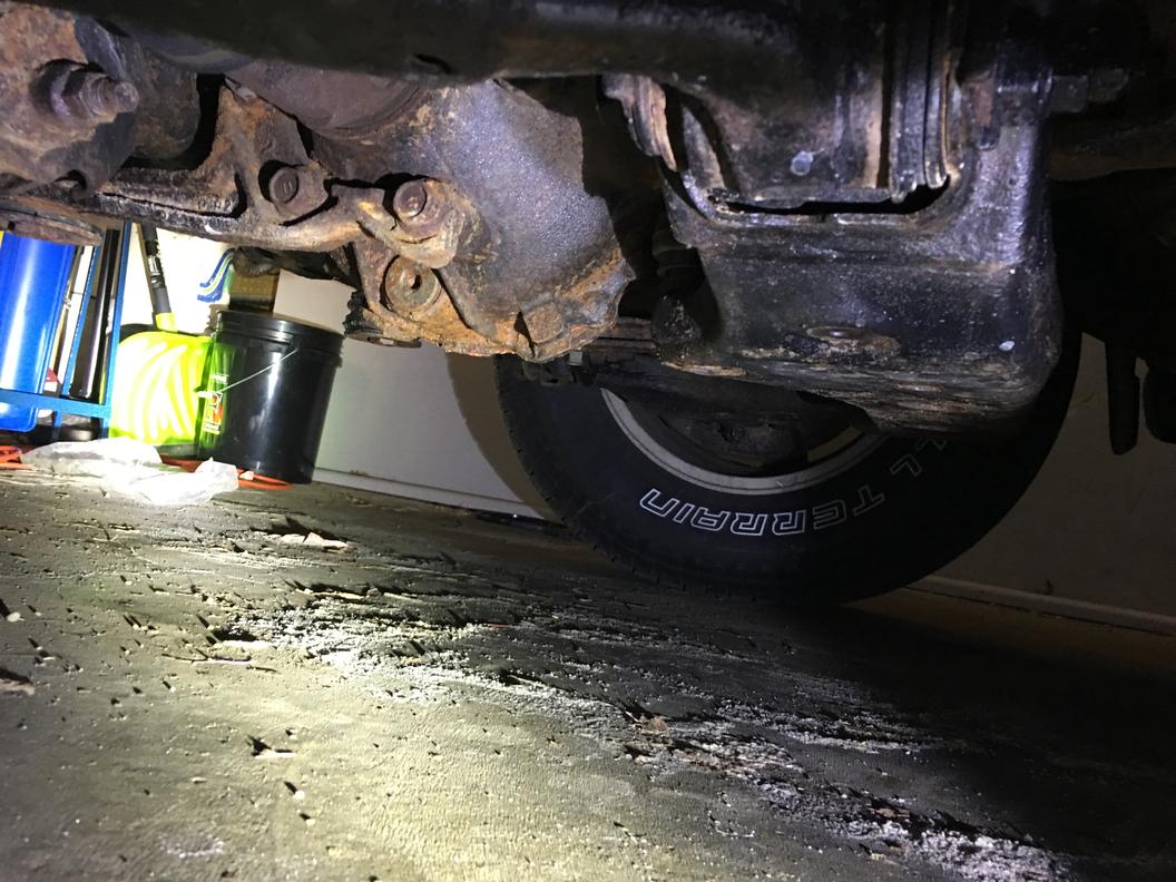

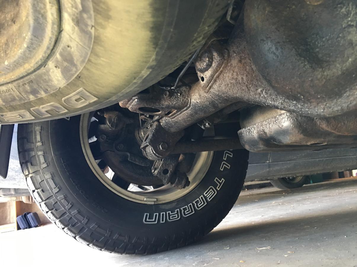

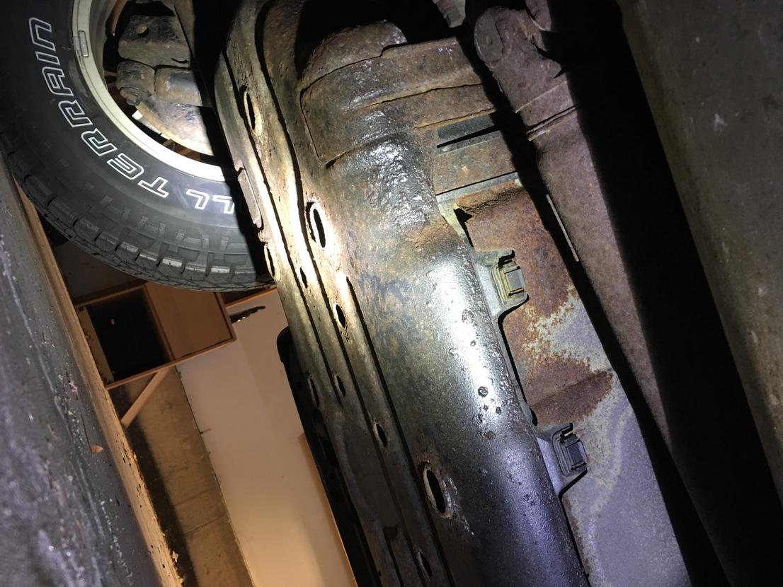

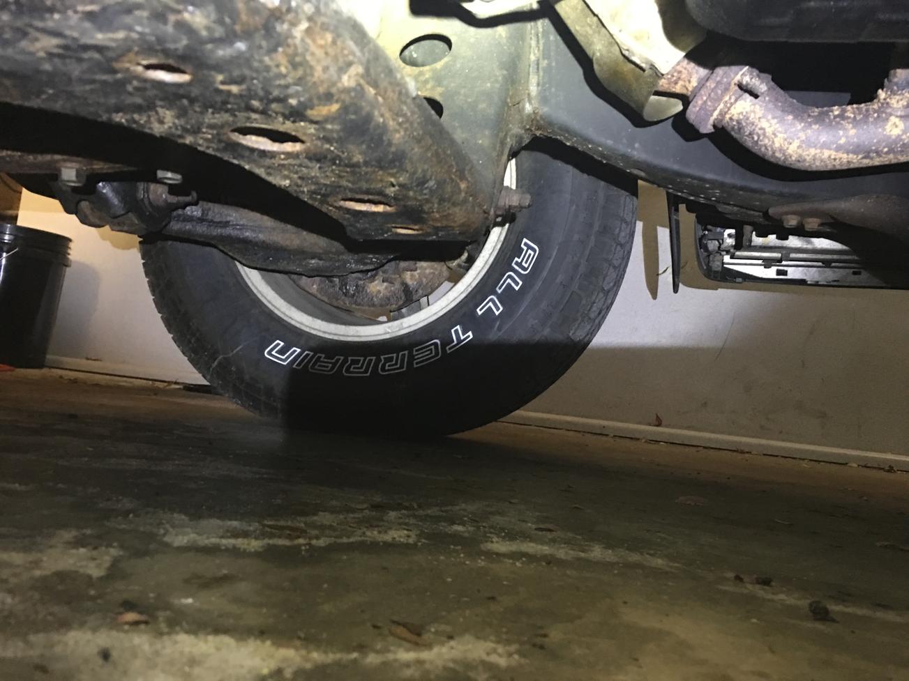

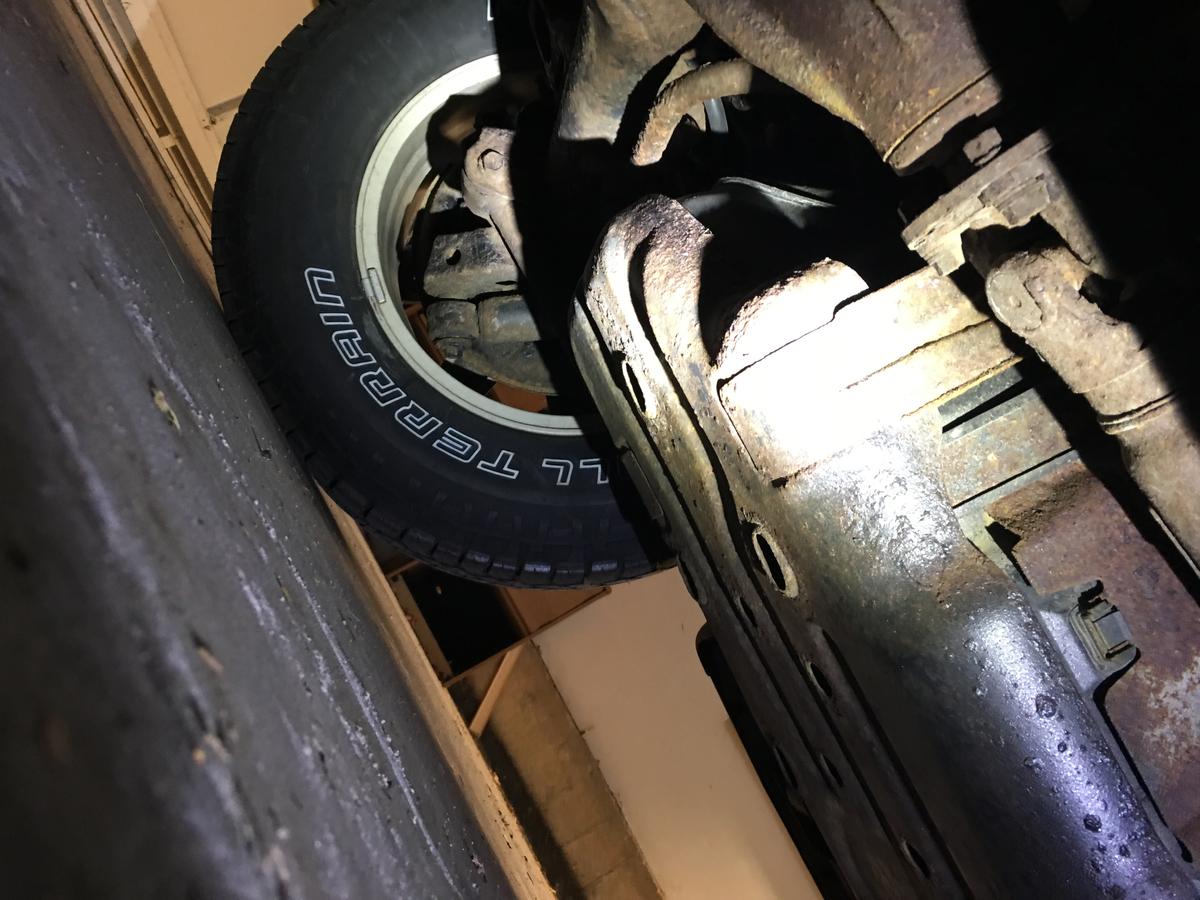

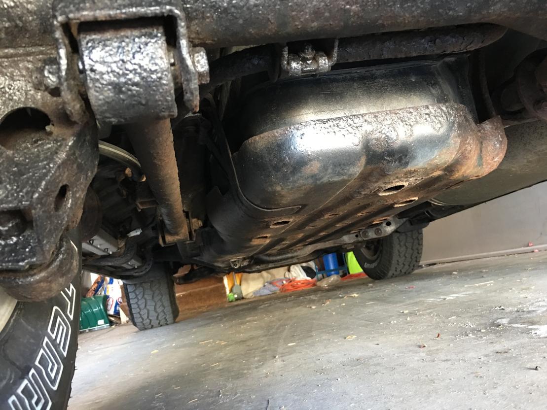

I didn't think you could collect a ton of salt just from being near the beach, but I guess I just learned. Anyway on a scale of 1-10, 10 being the worst, how bad is the rust here you think? I looked at the undercarriage on an overcast day WITHOUT my 600 lumen light that I ALWAYS bring when I check out these things. I've been looking for months.
With the perfect service records and location it came from, I picked it up without doing my flashlight check. :ybrick: :ybrick: x10000
Some of this has a globby look to it also like it's been painted over in an attempt to hide rust.
I went from being really satisfied with what I got to dread. The first thought I had this morning was "you never checked the undercarriage with the flashlight" and I bolted out of bed and took these pics. Let me know what you think... I feel stupid

Did someone spray over the rust or is it just flaking off now? Looks like someone quickly sprayed over it to me. I'd be hitting it with a wire wheel an see how it looks after you get all that crap off.
The Toyota dealer claimed my truck was heavily rusted before I got it. Yet I didn't have a single spot on my entire frame with bubbling like that. Everyone's perception is going to be far different.
Dana Point is a beach city in California. That is quite a bit of surface rust that has been painted over by the looks of it. I got a little lazy with a wire wheel and used a rust reformer over some of mine and it looks similar in spots. I do not think that you need to panic, but I would recommend taking some time to clean it up a bit to ensure it is only surface. Where in CO are you located?
It's missing the front skid plate, probably rusted off/ seized bolts, unless you removed it.
On the plus side, looks like a new steering rack maybe? The boot looks awfully clean anyway.
10 being the most boned you could possible be, 1 being completely un-boned, I would guess you paid a nice price for a truck with that low mileage, so 8?

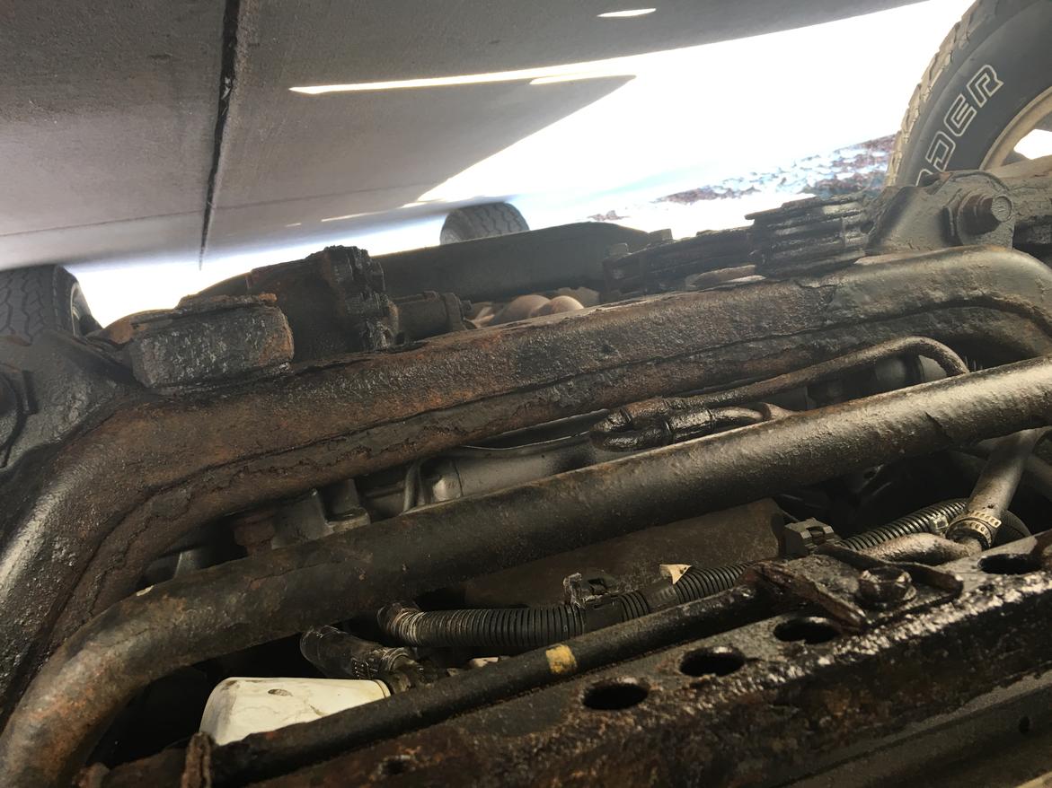

Do you have a pic of the sides of the frame rails? If a lot of it looks like the clear section in the first pic behind the exhaust you could be okay and maybe just the low-hanging metal is rusted. That is all you have pictures of so far.
You could spend a tone of time with power tools scuffing the surface to remove the rust, then coat the whole thing in POR-15 but that would be up to you, could be quite the undertaking, but you could still save it. Poke the frame with a screwdriver to see if there are any thin places where the screwdriver pokes through but it doesn't look like that's the case, just surface rust so you could save it you would just have to unbolt a few things, perform bushing maintenance at the same time maybe, and go to town with some sanders.
Parker, and I just got this thing and the dealership claims to be really straight forward and will right certain wrongs, sometimes even years later. The guy who sold it to me is going to talk to the owner but I have to wait until Monday(meanwhile I lose my mind) and I have no idea what solutions will be proposed.
I'd ideally like them to put it on a lift and do all of the recommendeds in this thread themselves. I honestly don't think they looked at, or at least hard enough, before selling it. When I spoke to him after he saw the pictures I emailed he seemed genuinely surprised/disturbed
And it DOES look like some ghetto spraypaint job (perhaps multiple ones) in certain places, giving it this tar/melting look. Some of the bolts look like they wouldn't even pair with a wrench. I'm pretty disgusted because I paid a premium for this because it had a perfect service history and was coming from CA.
It honestly looks like someone used it exclusively for the beach for owner 1 or 2 and never washed the underbody
I think your gonna be ok. I agree with the above posts...the bottom of the truck was hit with a spray can, but the rust does not look too bad. My '05 is a lot worse after spending 13 years in new England where they lace the roads with salt.
I'd say mine is about the same, maybe a bit worse. Yours looks like a lot of surface rust. I wouldn't worry too much about it. Like has been said, wire wheel and some POR-15 and you'll be good for a while.

From what I have seen just being near a beach does not mean your frame will get rusted out, I'm thinking that your's has been driven ON the
beach and in the sea water from time to time and not washed after.
That being said from what I'm seeing in your photo it is not the worst rusted T4R undercarriage I have ever seen, far from it, but the only way
you're going to know the extent of the rust is to get under there with a wire wheel and start cleaning the rust scale away, also use a screwdriver
to poke at the worst places to see how strong the metal actually is.

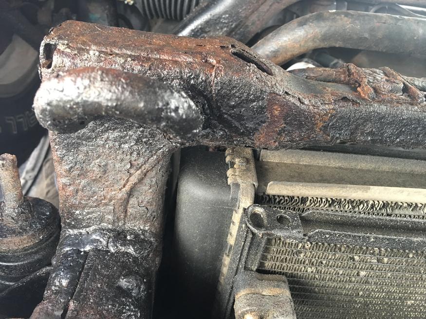

Usually the first piece of the frame to get the worst rust is the radiator support and I don't see it in your photos, it will be a sign of how badly the
rust truely is other than as mentioned getting under there and start cleaning and poking to discover to full extent of the rust.
I'm in the SE USA and I have seen many T4Rs from Florida and not very many of them, very few in fact have any rust issues at all, my 2004 came
from and spend it's first 12 years in Florida and the frame looks very good other than just basic rust film/surface rust, much much better than your's
does, but I still think from first impression in your photos you still have a lot of good metal left in your frame and hopefully you will discover that to
be the case!

That strut though... oof. Maybe an excuse for some Bilsteins?

Here's some of the front with radiator support, jesus

That radiator support looks pretty bad. I have a hard time believing that the truck wasn't in the rust belt for a few years. That rust looks pretty typical of something we would see here in Missouri from trucks just north of us. In my opinion, it just does not look too bad. The radiator support can be cut and a new one welded in. You have problems when the frame is perforated and the rear links start to rust through where they are welded to the frame near the rear end. Everything I see in your pics looks manageable. You probably paid too much for the truck with the rust issues but that amount of rust would not have stopped me from buying that truck at a reasonable price.
That 2006 did not spent whole life in CA. I bet it spent plenty time on snowy salty roads. Some one brought it there at some point later. Your dust shields (4) are far too gone and as mentioned here before you need front skid plates (2). I'd ask dealer for those 6 items and a credit for non-disclosed rust. 2006 Limited with V8 engine should fair market from dealer for 8,936-12,403 in good condition in 92629 zip code according to KBB. I'd be asking to adjust the price down to 10,000 or they can take the truck back and refund entire amount you paid. GL
