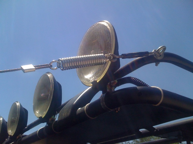

Those PIAA mounts look better, and I agree you can make your own, I did on my roof rack with steel hose clamps. Some might say its a little redneck, but it works.

Or for now, try my steel hose clamp idea. Hose clamps will tighten down around an oval. They only cost about a buck or two, and easy to mount.
