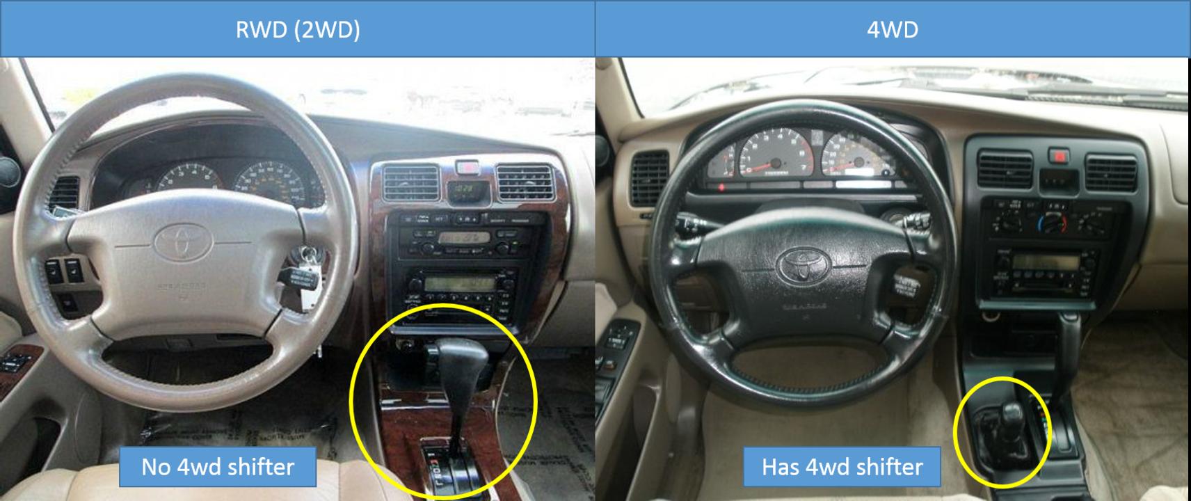

This is as simple as it gets.
Ah, man. If my wife's 2001 had been like that 4WD, I would never have parted with it. I loved that truck and all the places it took us. Interior was identical to that 2WD, even the phony wood trim.
One of our dumbest decisions: not paying just a bit more when we bought it new.
