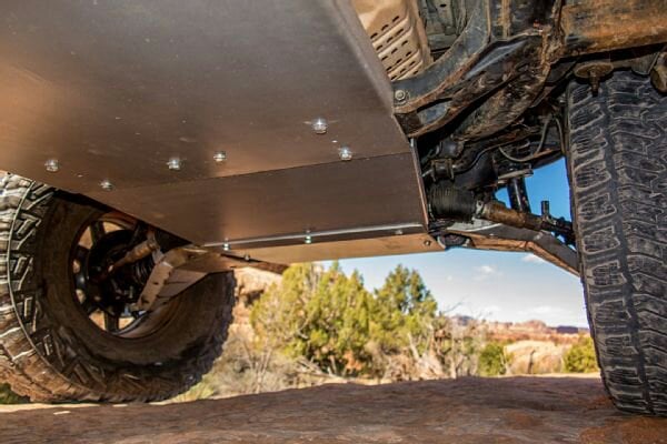

Here it is. I love those arms
Link http://www.fourwheeler.com/features/1606-this-1996-toyota-4runner-proves-ifs-doesnt-have-to-be-weak/
