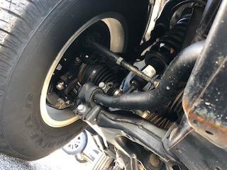

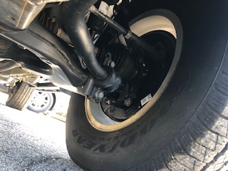

Sorry for reposting to an old thread (I am also not able to start a new thread as I am a new member), but just to confirm, this vehicle DOES have KDSS, correct?

Thanks. I had done that and it did come up as having KDSS, but the seller had made no mention of it, so I wondered if it might be possible that the VIN report was wrong. It's a fairly long drive to see the vehicle in person, so I managed to get them to send me some photos of the inside of the wheels.
