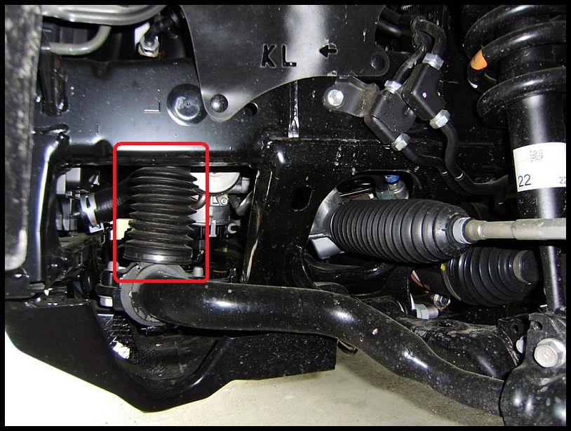

Look underneath at the sway bars. Are they attached with the regular nuts and bolts then no KDSS. If there is a canister attached on one side with a boot then you have KDSS.
Also a way to check is in the front, look at the lower control arms. Is the sway bar connected there? If yes then KDSS if it is connect elsewhere then no KDSS.
Hope that helps
Look under the front end:

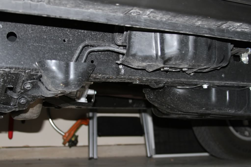

Not the best picture, but you can also look on the outside of the frame under the driver's seat for this piece of armor bulge over part of the system.

Yup. Fastest and easiest way. Its exactly where you bleed the KDSS system if need be

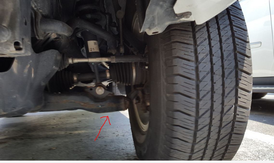

Not that it matters much, but the easiest clue for KDSS IMHO is the first pictures... Just stand in front and look at the front lower control arm (you don't really have to get down on the ground). If there is a big thick swaybar attached directly to the lower control arm, it is KDSS. A normal swaybar attaches via a traditional link to the spindle and is tucked up much higher and is not easily seen.
The attached pic shows one without KDSS. If it has it, you would see a big swaybar and bushing attached where the arrow is.

I would have thought the easiest way to tell is to look for the KDSS reservoir thingy on the frame along with the KDSS "plumbing"...but maybe that it just me.
