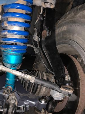

Had the truck shop in SD put on their own spindle gussets, which is pretty THIIIICCCCCCC...
Wish I could take better pictures but I only have a potato.
