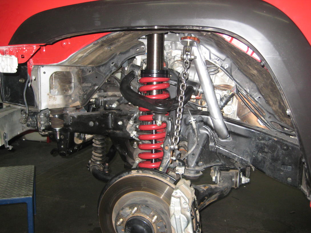

limit strap from the spindle to the frame? i wanna see that. seems overly complicated instead of the LCA to the frame lol, but sounds about right for a manufacturer.
Yep. But not a strap. A chain. I bet it rattled like hell. But it's functional - super easy to adjust in the field, durable, and rotates freely with the spindle. It's unusual though.
Also note: original bump stops!
I think that 4runner is still in use as a test mule at TAPG. So it might actually still be relevant to the 6th gen development. ��

that shock tower hoop is suspicious as hell lol. all that work to run a 10"???stroke shock and stock width control arms. silly toyota.
stock bumps, no double shear UCA mounts, stock spindle. lol

To run in stock class there's a lot of limits on suspension mods. Basically you must use all OEM suspension and drive train other than springs and shocks. So there wasn't a choice in using longer arms. They have to be OEM parts.
I don't think there's any reason to have double shear UCA mounts with OEM rubber bushings. The rubber bushings provide a lot of cushioning. That's why IMO they really are better than poly or rigid bushings for most uses.
