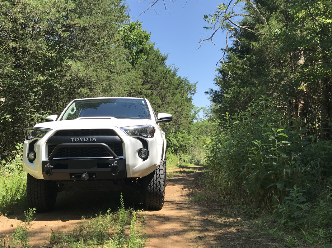

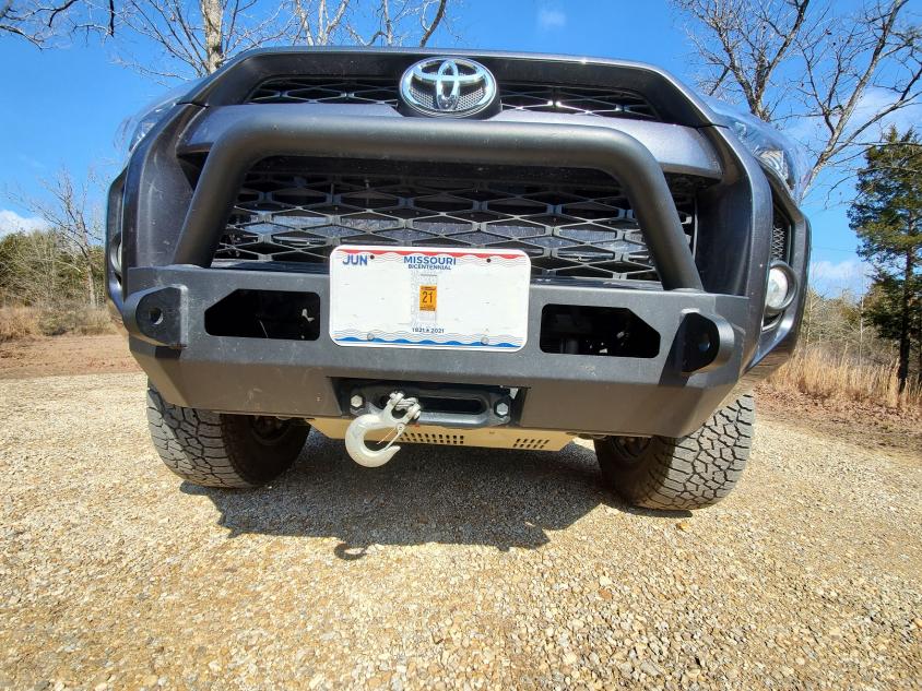

For me, winch access was a top factor when I was looking around for bumpers. Wanted to be able to see the drum as to make sure the line was being winded up properly after/during use.
Really wanted the LFD but shipping costs hurt...so had to settle with something with less access. Eventually ended up with a Outgear Solutions bumper which has pretty large cutouts for winch access. I don't have any issues accessing the clutch or the winch controller plug. Still doesn't have the level of access that the LFD has but it has sufficed. I also relocated the control box so I can now see the drum instead of having to try to peak through the fairlead.
Tried finding a picture of the front to show the accessibility. I don't take many photos of the car so hopefully these help

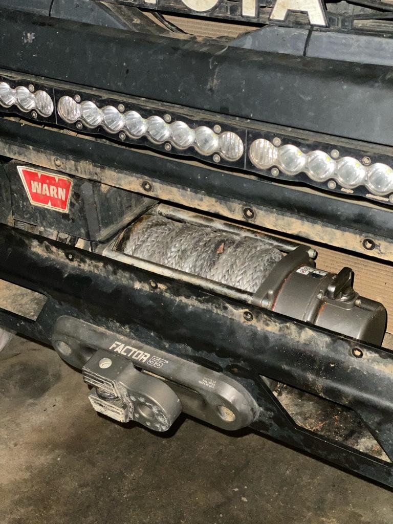

I think it’s absolutely critical if you’re planning on actually using your winch. I can’t imagine respooling a winch blindly without having a sight line to the drum.
I’m fortunate enough to have a bumper that has enough access that also allows me to rebuild the winch without having to remove the bumper. That is another thing to think about as well. These things need maintenance you don’t want them to fail while you’re out In the field.

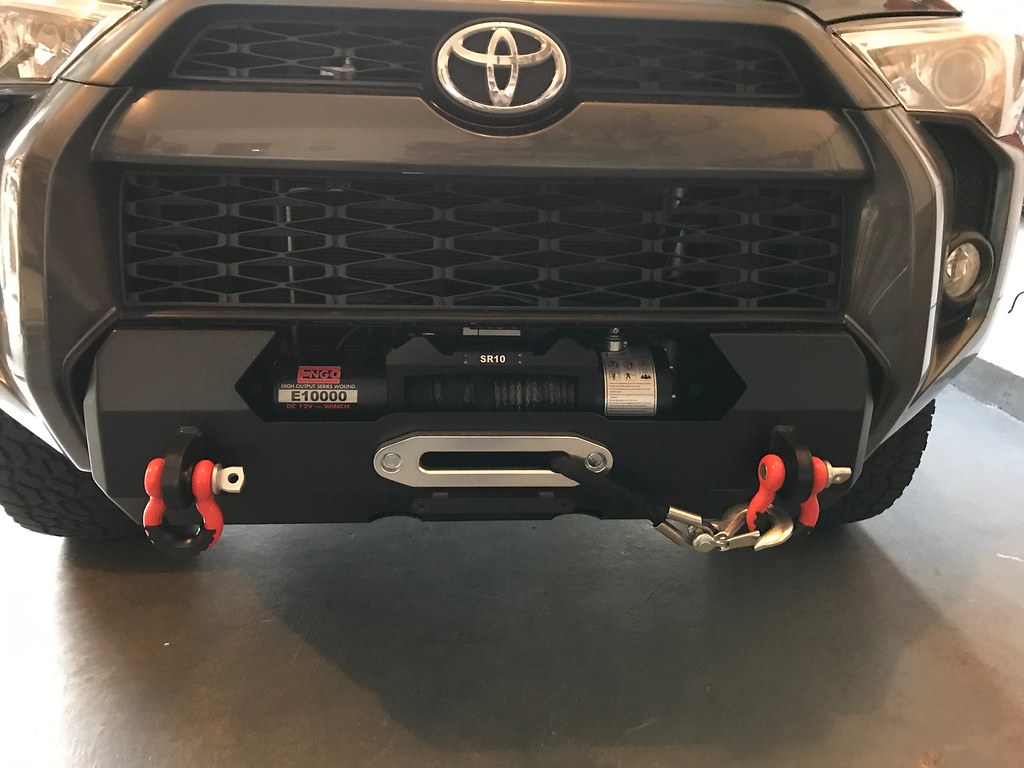

I have the Victory Blitz bumper with 2 ample cutouts for clutch and power access.
Have already used the winch 3 times in the 3 weeks since I've had it installed.
To me it's imperative to have access
