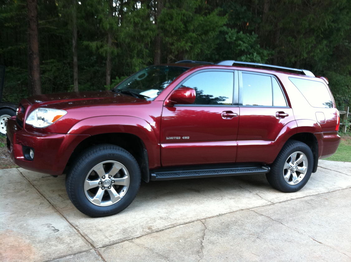

Here is mine with it. Its on the 1.75 setting. Rides 10 times better now. Click on ARK_SWAMP_RIDER'S link in his sig. Theres more there too.

At the lowest position it will still have the rake. But many on here have had a lot of luck leveling their runners with them set at the .85 clip position.

sorry for the off topic but I have you have the exact vehicle you do and was wondering what else you have done to your suspension and what size tires youre running. Thanks
No worries, I have FJ coils all around and 5100s up front with OEM FJ shocks in the rear. My tires are 265/60-18s. They were new when I bought it and still have a lot of meat on them left, so now I have to wait to get bigger BFGs. Either way the ride quality has improved tremendously.

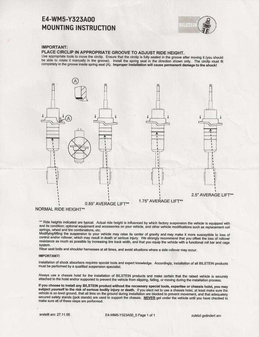

i might be go around in a circle here, but if it is put at any position but the lowest, do you need a spacer? forgive me, i am a newb to truck suspension...

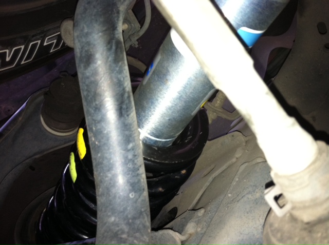

There is no need for a spacer with the 5100s. Whether you want to level or lift with them, it is all self contained to the strut. Here is a picture of mine and a diagram Bilstein sends with the strut. On the picture you can see the line that you can adjust the clips to for lift or stock ride height and the diagram shows how it preloads the spring up as opposed to a spacer preloading the spring down. Basically the same concept, just upside down.

The only reason you would need a spacer is if you want the rear lifted. Everything said only applies to the front. Some use the higher settings on the front and a 1.5" spacer in the rear to lift it versus a lower notch on the front just to level it out. Pics of mine with fj coils and the 1.75" setting, then later with the lowest setting and ome coils are in my build thread, link in sig.
