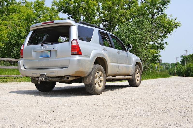

Yes, this is true for me - 0.85. I needed a 1.75in lift to level mine out so I first installed it with the 1.5" (3rd) setting and found the front ended up looking just a bit higher - seemed to go up more like 2.5". You can see from dougiefreshmx's pic that from that angle it seems the front a tad higher. So I ended up changing it to the 2nd setting 0.85 and it did level it to within 0.5" of the rears until, but when I install airbags in the rear coils it raised it another 0.25". For me the actual lift on the 0.85" setting was more like closer to 1.5". For me I like to have the rear just a bit higher so when I have passengers, cargo or accelerating, it is level.

I'm glad this thread came up, I was gonna post up asking the same kind of question. I'm looking at a set of 5100 to level me out and ditch XREAS. I think I won't install any new springs right now, just use OEM. i'm not so concerned about additional load capacity yet. and i'm going to run 255/70/17 tires, which is barely over 31" anyways.
i think i'll do the daystar rear 1.5" budget boost. so for the fronts i'd have to set it on the 3rd or top clip, then? the 3rd is 1.75"..
it's also possible that may be too much lift with the relatively small tires. in that case i could just go 2nd clip on the front to level it and leave it there.
opinions?
this is how it looks now:

If you do get the rear daystar budget lift, I'd definatley bring it up to the 3rd clip or 1.75. But if you just want to level it out for now, you could just get the 5100s and set them at the 2nd clip or .85 and leave the rear alone. Truck looks good btw!
