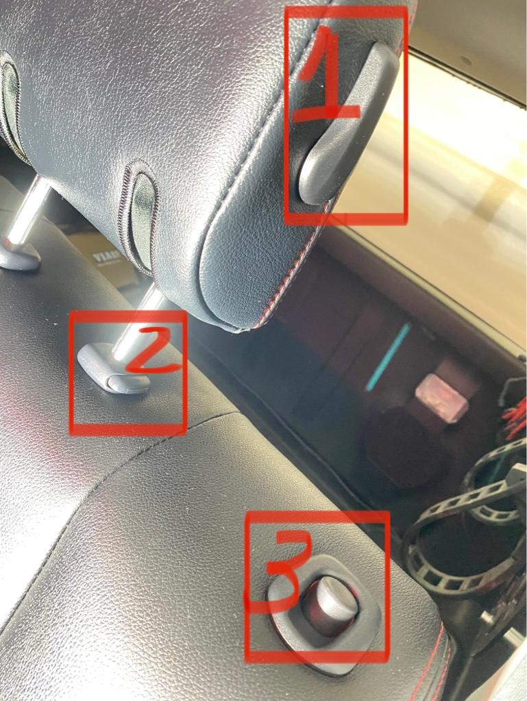

OP, Im super curious if you have this figured out. Here’s what I’m working with…
1 - this lever folds down the headrest
2 - this button lowers the headrest
3 - this button folds down the seat.
Each button only controls one action/direction.
Let me know if this helps.

Sorry I haven't responded everyone, came home from work feeling really crappy yesterday (I work night shift 4PM to 2AM) and went straight to bed. Anyhow, my other rear seat the headrest did go down and then fold, but I couldn't get the left one to. However, this picture is exactly what I need and will give it a try tomorrow. I was under the impression that you had to somehow push the button to fold the seat down to also lower the headrest. I didn't notice that other button. I must have accidentally pressed it while messing with the right side headrest. Will let y'all know.
