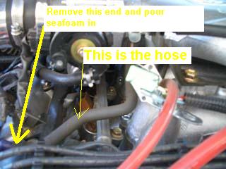

im new here, and i wanted to seafoam my 99 4runner. I already did it to my 99 accord using the pcv tube to suck in the seafoam. I wanted to do it to my 99 4runner, but i dont know where the pcv tube is. Does anybody have pictures of where it is located. Thanks!!!
-denny
this stuff is good but it is known to clog spark plugs and O2 sensors, my O2 sensor has gone bad after i seafoamed. gas mileage also drops but thats because of the clogged O2 sensor and spark plugs i guess. here is a pic i got from yotatech.com

I pulled out my PCV and poured 1/2 a can of seafoam in. NOTHING HAPPENED??? Anyways I put a couple ounces in my oil, and the rest in the fuel tank. Why did nothing happen? My PCV looked pretty gummed up but that won't have any effect using the seafoam. Can anyone help. My motor has a little over 150k. So I'm sure the motor has carbon/sludge in there. I just bought this a little while ago and while inspection the motor noticed looking down the oil fill that old burnt and decayed oil was everywhere and could use a good going over. Any info would be great thanks!!!
I'm wondering if you fed the seafoam into the line coming off the PCV valve or did you dump it into the hole in your valve cover that the PCV valve goes into? If you dumped it in the hole, that's your problem - it needs to go into the line going to the intake plenum.
Lots of people don't think about this but be careful when you feed the stuff into a vacuum line. If you go too fast you can hydrolock the engine and even bend a rod so do it SLOWLY!!!
