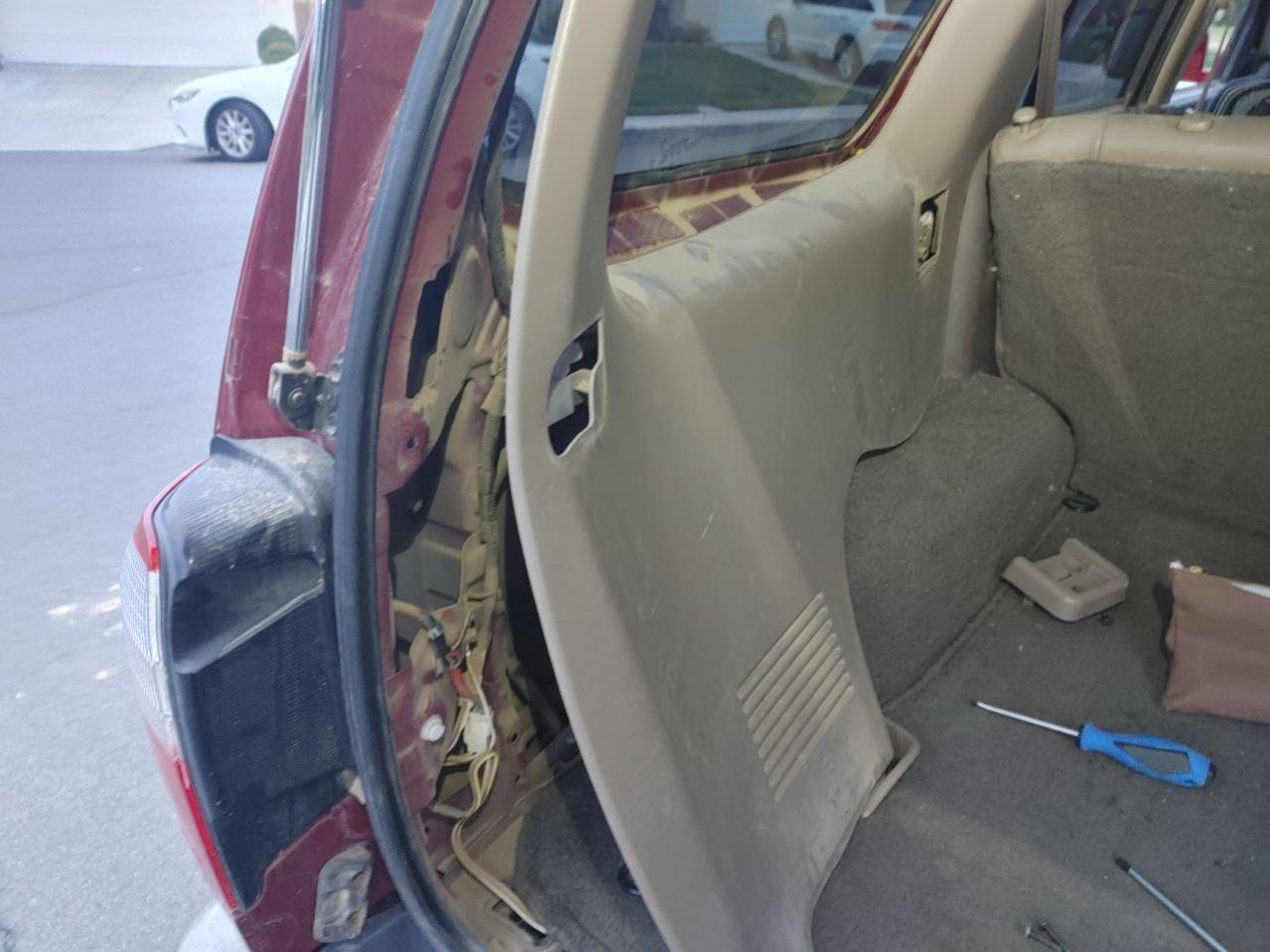

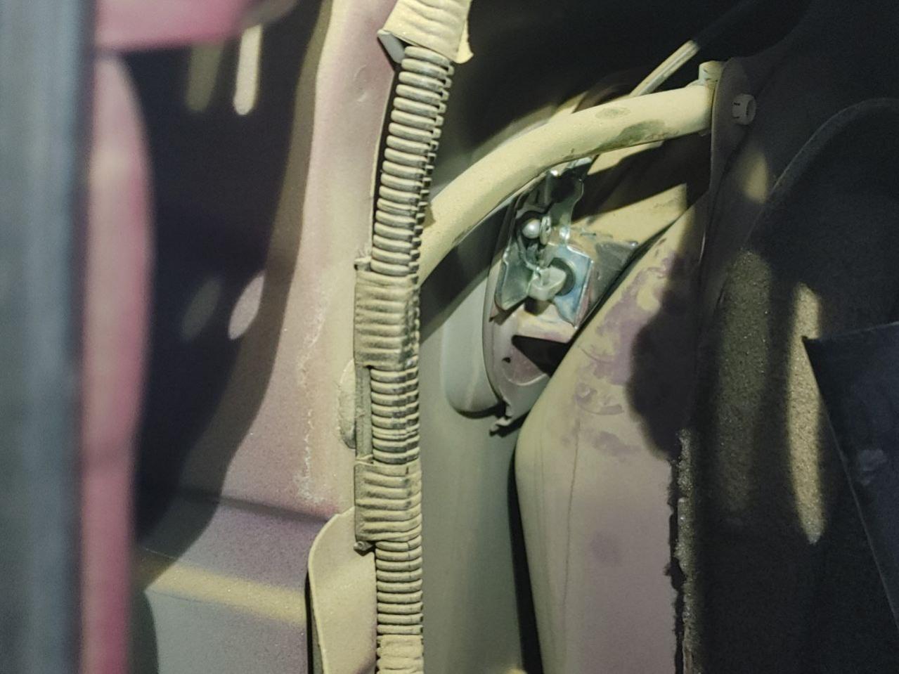

Alright...so you can find the fuel door lock mechanism inside the driver side rear panel in the trunk. You have to remove a few screws and once you pop off the panel, you'll see it right there.

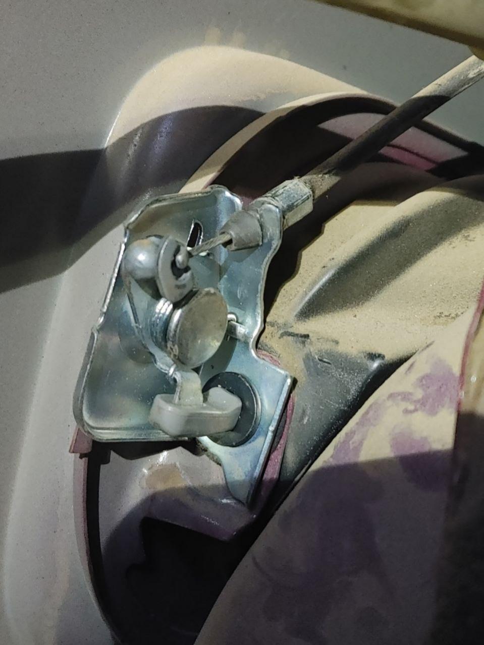

Then you have to remove the bolt from the fuel door side and the mechanism comes right out.
The thing was completely dead....the spring had no return to it even after cleaning it completely. 20 bucks from the dealer.
