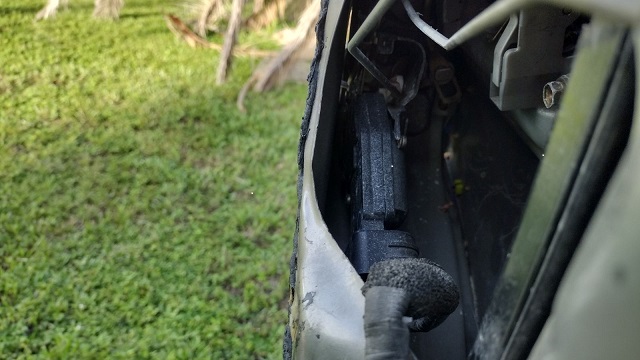

Trying to attach picture
Trying to attach picture. Everything looks connected. Not sure what I am missing?

If rods are intact. Not child safety. The only thing left would be the lock actuator.
So when the botton is in the lock position. It will not lock.
You can also disconnect the rods to verify they are fully going into position.
