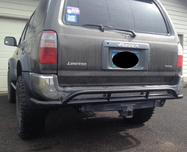

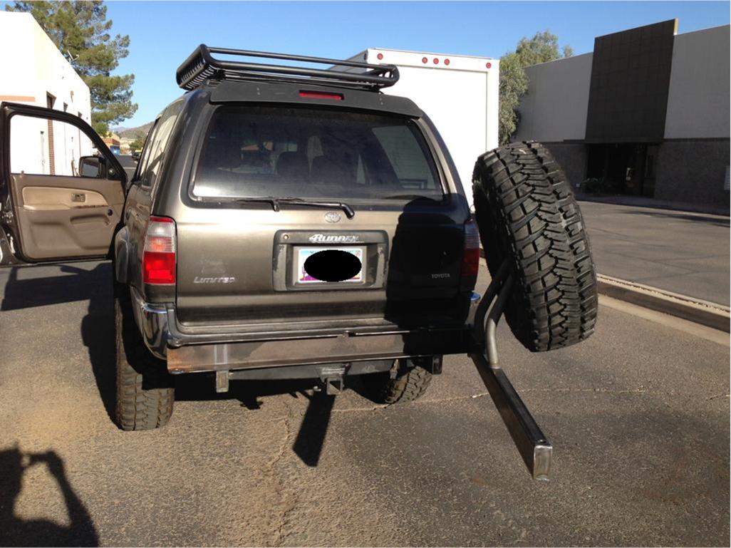

The more I think about it - the more I would like to keep a decent one (like the JD2) in my arsenal. My plan (although somewhat low-brow) is to blend the two pics below together into one unit. The slider style bumper taking the place of the channel including wrap-around. I've already got a mock-up of the brackets needed to hold this in place. Those I will have CNC'ed for me though.

Pretty sure my local off-road club has several people that fab professionally - I just want one so I can bend, test-fit, bend, test-fit. Maybe even score some points by making some of my wife's Pinterest crap for her. :angel:
