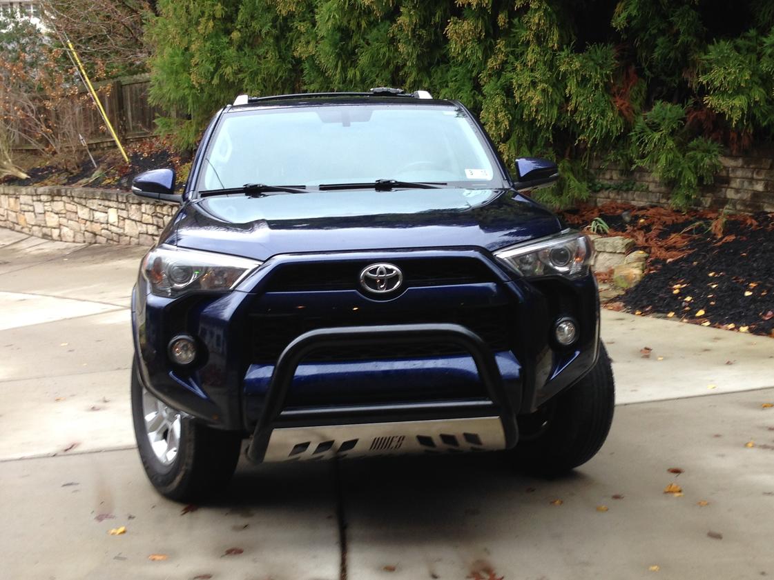

Not sure why you would need to remove the bumper cover. I installed a bull barr on a 2014 SR5 with the cover in place. The room is tight to get to the bolts but not difficult.
I was able to remove the three bumper bolts on the passenger side, but I am unable to get enough space to install the new bracket/bolts without removing the bumper cover. If you have been able to do it without removing the cover, please share the secret.
I was able to remove them by using a small socket/ratchet and a ratcheting box wrench. To remove the bolts start and the bottom and work your way up. Don't fully tighten the brackets until the bar is mounted. It is slow going. At one point it was so tight the ratchet was only going one click at a turn. I did not have to remove any plastic of any kind.
