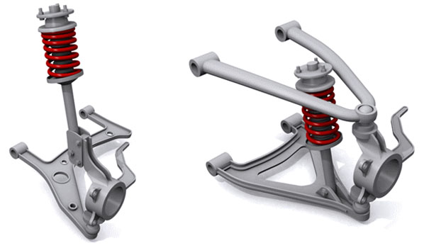

Technically a McPherson Strut is not what these trucks utilize. A McPherson Strut is a suspension set-up where the strut itself is treated like an extension of the spindle. The strut top mounts into the body and has a top plate that rotates as the wheel is turned (very common on almost every passenger vehicle found on the road these days.)
Our vehicles use what's referred to as a "Dual Wishbone" design with the strut being sandwiched between the two control arms and being separate from the spindle. The tops do not rotate like a McPherson strut as they do not need to twist when the wheel is turned.
A "Strut" is basically what we consider a "coilover", it is a compact assembly with the spring seated over the shock. Most people call them struts, but coilover is acceptable as well, what we as a community often refer to as "coilovers" is short hand for "Adjustable CoilOver" that has a perch that can adjust the ride height, but in reality any strut can be called a coilover, just not all of them are adjustable.
McPherson on the Left, Dual Wishbone on the Right:

Thanks for the clarification BlackWorks.
