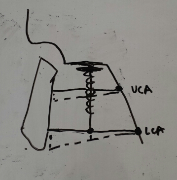

We know it's a 2:1 system but we were looking for explanation on how it's a 2:1 system. I think we figured it out. A 1" thick Spacer installed on top of the strut will push the lower control arm down 1" where the bottom of the strut meets the lower control arm. Let's just call this point the center. If you look at the attached drawing, the further out you go on the control arm the more lift you will gain.
The drawing is as if you're looking at the front of the car. The solid parallel lines are the control arms. The dotted lines underneath them are the control arms new position after installing a spacer.
So it's mounted halfway up the LCA so it pushes the LBJ down 2x... make.. think about opening a door closer to the hinge if that makes sense
When you look where the shock/spring assembly is positioned with consideration to upper and lower control arm pivot points (body side) vs the outer control arm points (wheel side).
It is clearly evident that a little lift on the spring/shock assembly with be multiplied as you go out the axis towards the wheel end of the assembly.
If you want you can measure the axis vs mounting positions and do the math.
Try this easy visual:
Lay a 2 X 4 in your driveway (or on the floor) flat (0" lift).
take a 1" block & put in under the center holding one end on the ground. Measure the other end and find a 2" space (1" spacer gives 2" lift).
Now picture the end held to ground as pivot point of control arm and other end is the wheel.
