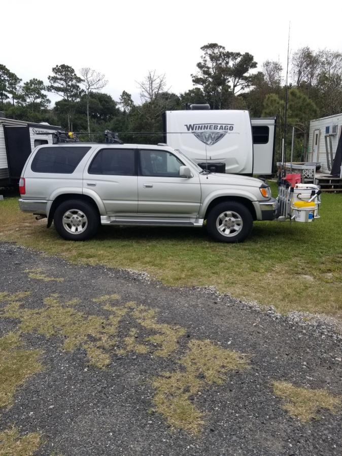

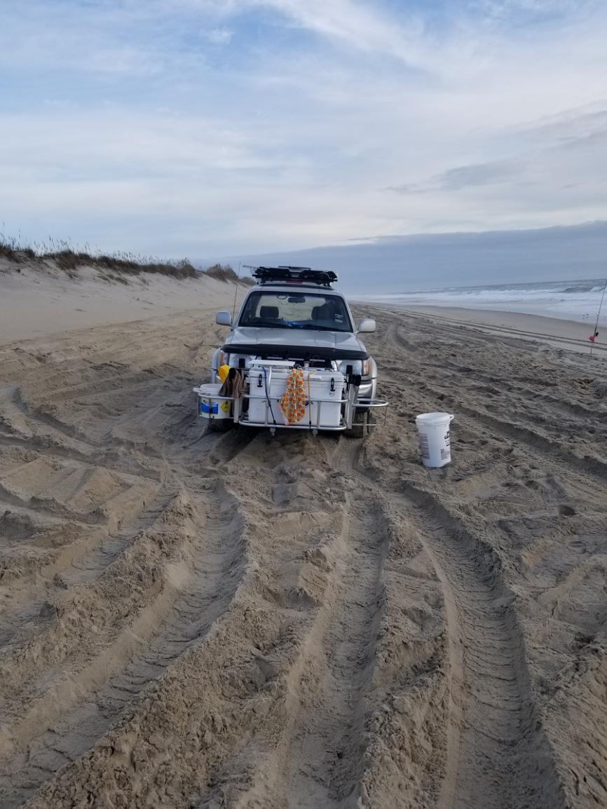

199,500 on my 2000 Toyota 4Runner SR5 4x4. Bought it used in 2001 with apx 25,000 miles. Not a daily drive for the past 6 years. I used it now exclusively for surf fishing at Cape Hatteras. LBJ's wil be replaced by 12/31.
Michael
