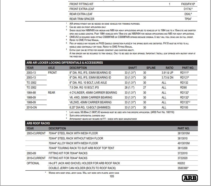

From ARB's website. It was only the front that has a gear split...
