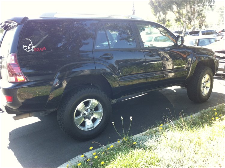

I'll let you know in a few minutes when I pick up my truck. Just went up 3" in the front and 2" in the back and added 32's.

Here it is. I just picked it up.
FJ Springs, Bilstein 5100's on the top setting, 1.5" spacer in the rear. I also have 1.25" wheel spacers too.

Thanks for the pic. I current ly have almost the same setup except I'm on the 3rd notch on the 5100s. I think with the older style flat fenders we can pull off more than those with the rounded ones.
