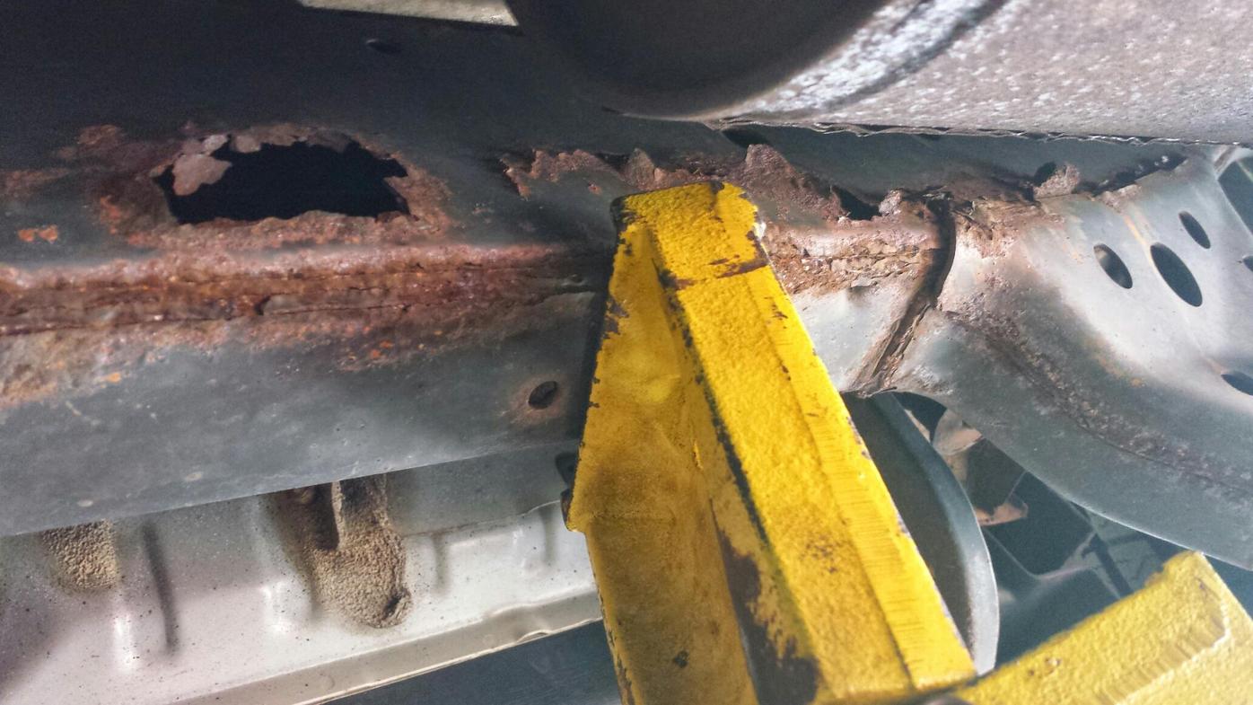

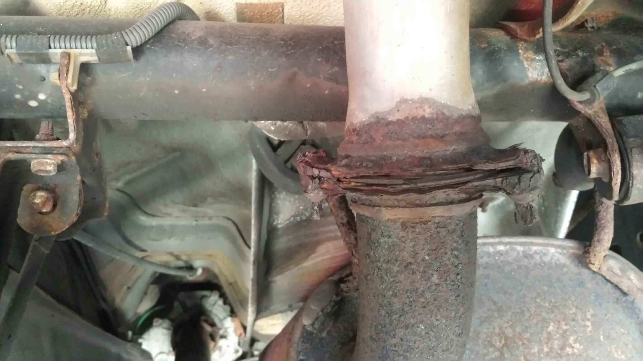

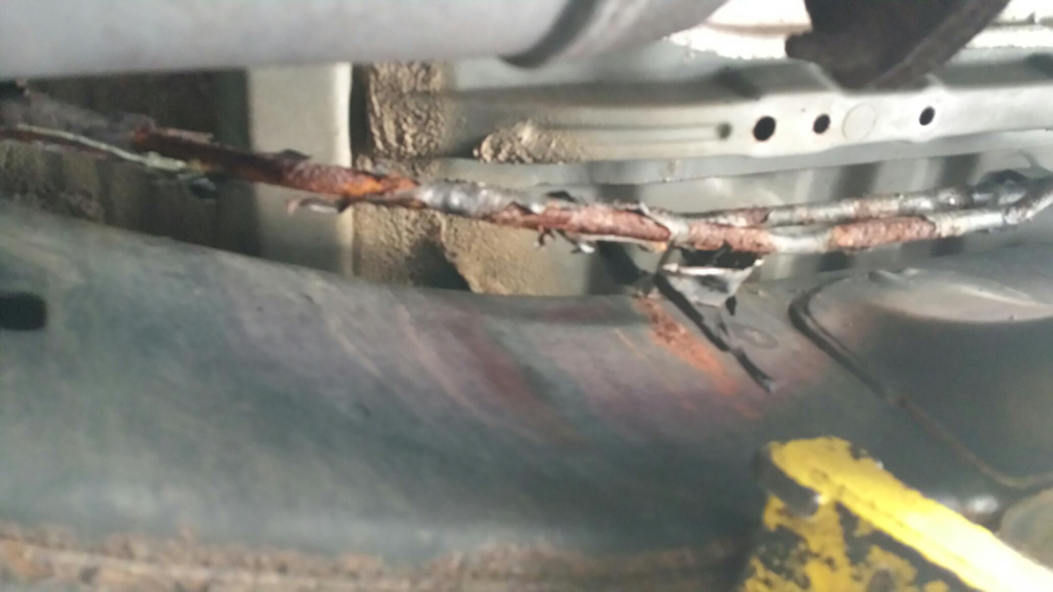

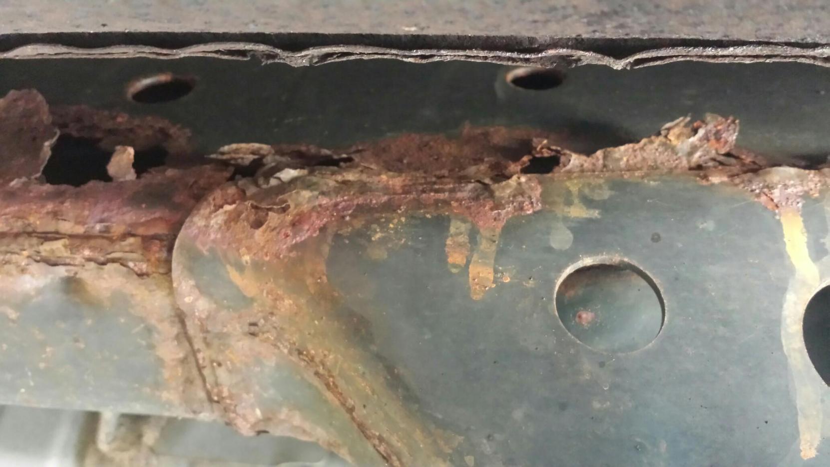

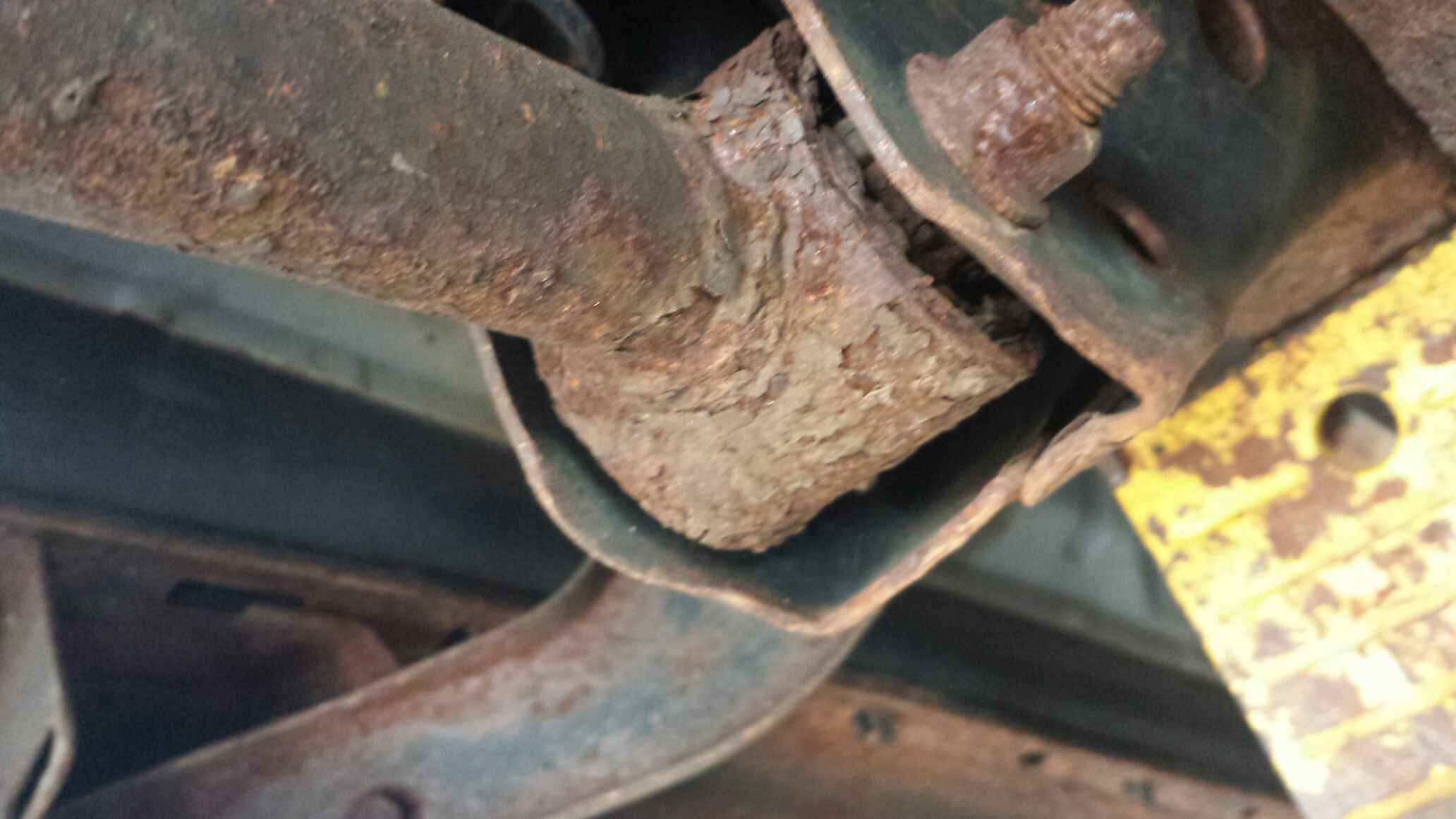

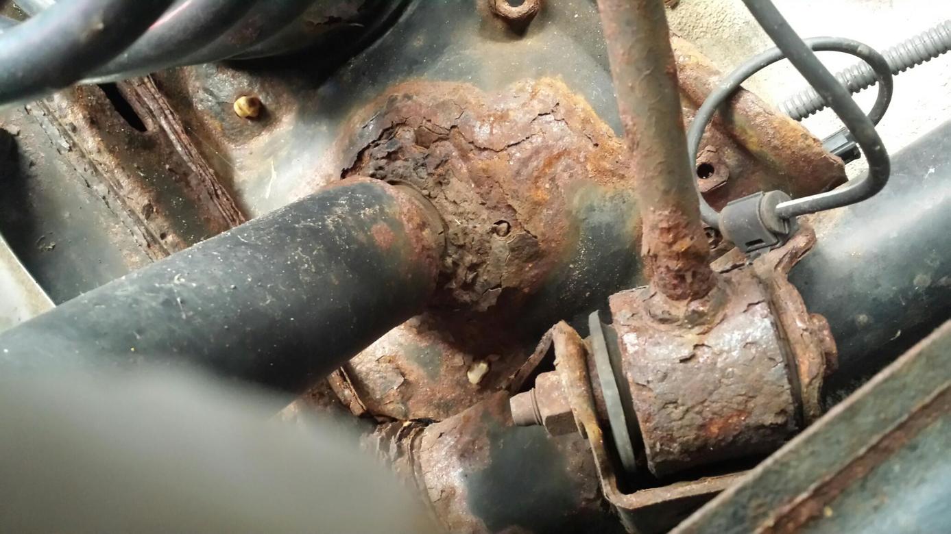

Dam it was too late!!! Dint lift the truck before buying it. I took it to a mechanic to check the exhaust and wala! just what i was scared off. Frame Rot exactly were JRZEE2000TR4LTD told me to check and more. I am not a mechanic so Dam. Shit I think im screwed. Do you guys think this can still be fixed by a welder?

The Titanic has less rust on it this very day as it sits at the bottom of the ocean.
I would _never_ buy a rust belt or east coast car for the very reason you are seeing.
Out here in the wild, wild west you never see see that type of damage even on a vehicle that has not been maintained so well.
IMO I would not dump any additional money into it - you will never get it back and there is likely a whole lot more you haven't even found.
Frame is bad ! Thats what would scare me. Is it fixable ? Yes ! Everything is for the right price. In other words if you want to throw money , it will be fixed. Same way people restore cars. Now if it only had rust around the rear shock mounts. I wouldn't really be scared. As there are alternatives to mounting rear shocks. I seen people make mounts on the outside part of the frame. Heck you could even convert to leaf springs if you are deep in. Me personally I'd sell the truck. Or get a donor or keep this as donor.
Says your in NJ, I bought my truck from NJ and even though I was very cautious about rust. So cautious that I completely missed the fact that these trucks came with e locker or manual. But my truck has no where near that rust. None at all ! And it's from NJ.
I'd walk away, take your time on searching for the vechile. Remember you can also look into different states.
Damn, my truck is a 99 & no where near that. I wheeled on the beaches of LI for the first 5 years I had it but always took it to the car wash right after. Even during the winter I bring it to the car wash once a week. Salt Kills! It sucks people dont take of their shit.
That sucks you bought it already. I laid under mine for almost an hour with a flashlight and screwdriver before i bought it. I wasnt worried about a little surface rust and body spots. But if the frame had any holes I walked away. I live in Michigan so rust and salt is guaranteed. My 97 has 233,000 on it and frame/suspension is good to go. Some small spots on rockers but not bad. If I was you, id either sell it or find a donor 4runner and start swapping frames.
The rust on my frame on my 99 was a lot worse than that and I had it repaired by a shop that works exclusively on 3rd Gen 4Runner's and Tacomas..It wasn't super expensive either it cost me under a grand to have it repaired.
What shop was that? I may need it after this winter, and I'm in the area.
Don't listen to anybody on this thread that is telling you to walk away, buy a new frame, and so on. That is a very common spot to have rust, and a lot of people have fixed it (myself included). The steel cost me around $10, and I spend about 2 hours doing the job. I cut out an 18" x 2" section, and welded in a new piece of 1/8" mild steel. Once the rusted area was removed I didn't see any other sections that we rusted out. I slide a wire camera through the frame and all the rest was still in great shape. You can PM me if you have any further questions.
That is true for someone who can weld and can evaluate the frame enough to trust their work, but for a weekend mechanic, I would say it's better to walk away than to buy a harbor freight welder and make this your first welding project.
Don't get me wrong, I have a harbor freight welder, and would totally use it to repair my frame, but I have also done alot of welding with it already and know I could do the job without getting help from here. I'm also an engineer and am comfortable trusting my own judgement. If I had kids, then I might not feel as confident with them in the car.
A Harbor Freight welder is a great welder to learn on. It's what I learned on a couple years ago. Don't get me wrong, this task isn't for everyone. However, I'm willing to bet you can find someone to do this for around $500. Look for a small mom and pop shop. They don't have the overhead that larger companies do, and still have quality work. I still wouldn't tell someone to walk away from it; even if they can't do the welding themselves.
