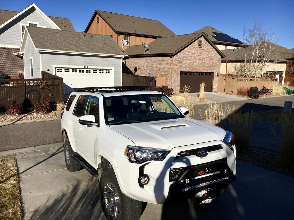

I have that same build and did not even see much of a hit in MPG over stock. I used to get 20-21HW/16City and:rofl: I still get 18-19 MPG highway and about 15-16 in the city. I have RCI sliders and skids (though not the gas tank) SSO front bumper with Warn winch and 255/75/17 Duratec tires. I now have a BP-51 suspension upgrade and Rhino-Rack Pioneer roof rack with little changes in MPG or handling on-road.
