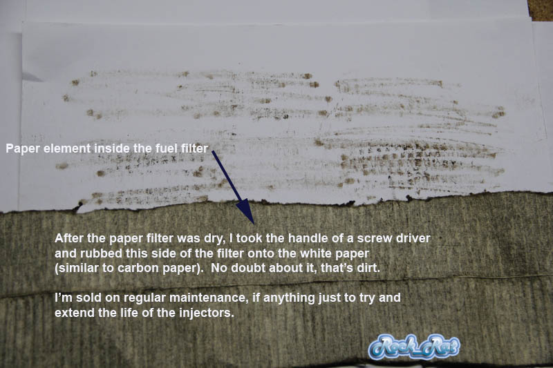

Fuel Filter Dissection Photos as Promised
So...I cut the filter in half just to see what it looks like after 15 years and 320K plus miles. It's pretty dirty but without bringing it to a lab to test the filtration capabilities I would recommend changing it out during some sort of scheduled maintenance.
While nothing "fell" out, there was some miniscule dirt particles as you can see by the specks on the white paper. The actual screen was clean. The dirt on the filter that you see on the initial cut was probably the filter element cleaning my sawzall blade.
Photos are in my build thread Additional Fuel Filter Photos
I added one more pic to the fuel filter section. Once the paper element inside the filter was dry I laid it over the white paper and took the handle of my screwdriver and rubbed it onto the paper. That was definitely dirt and not discoloration.
I'm thinking this will be a regular maintenance item from here on out for me.

Wouldn't having the dirt on the filter just make the filter more efficient by making it harder for future dirt to penetrate the paper? Until of course the flow rate decreased and caused an issue. But until then you should be good. Or is that just the pot making me think this makes sense?
Lol, pot makes everything logical.
I would imagine it only remains efficient for so long with "x" amount of dirt closing blockage. I'm not an engineer, but regardless, how many miles were on that dirty filter?
