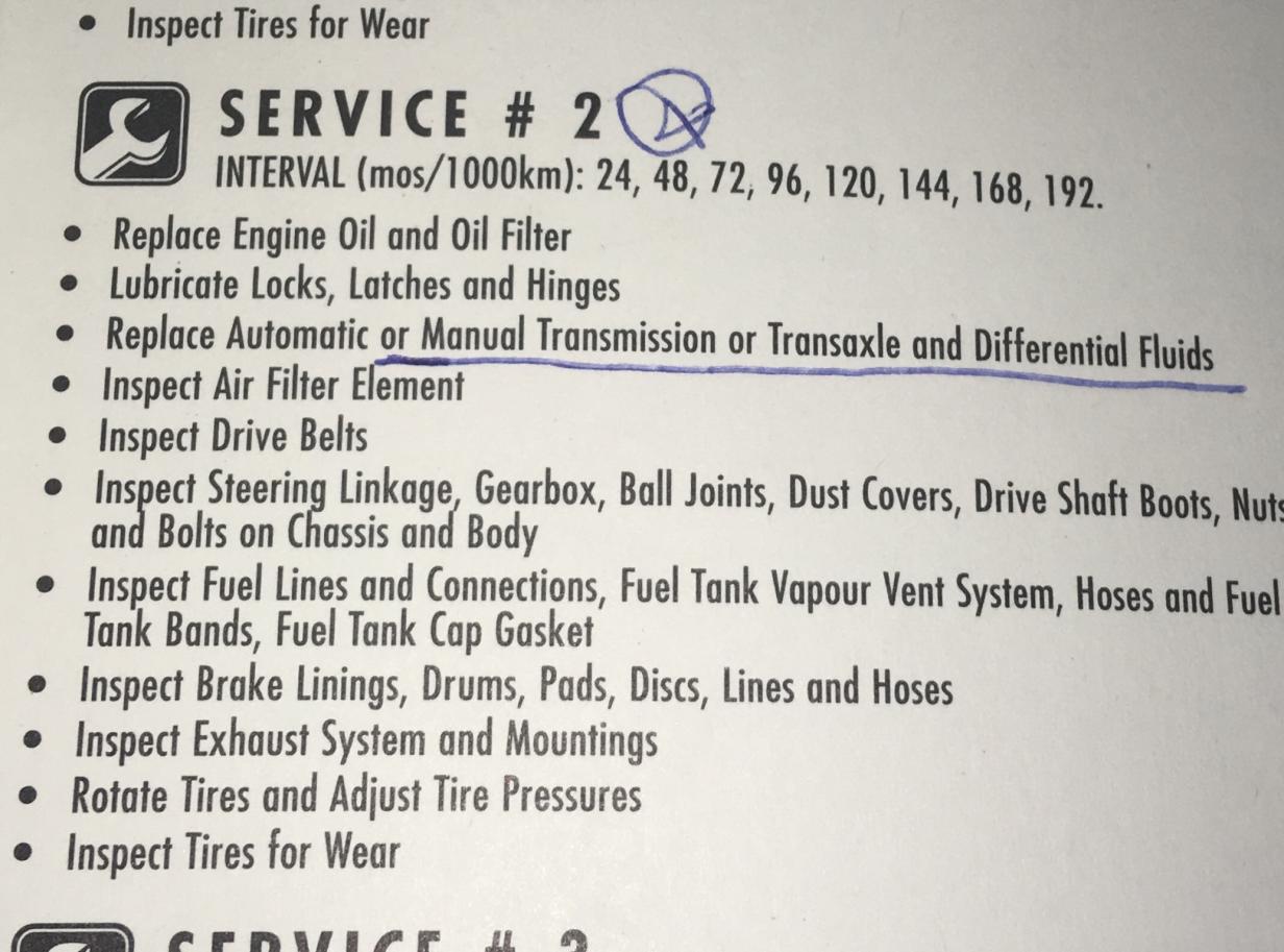

From the owners manual: Every 24 months or 24,000km.
Of course most will not be this frequent once the warranty period was up. I try to stick to it.
