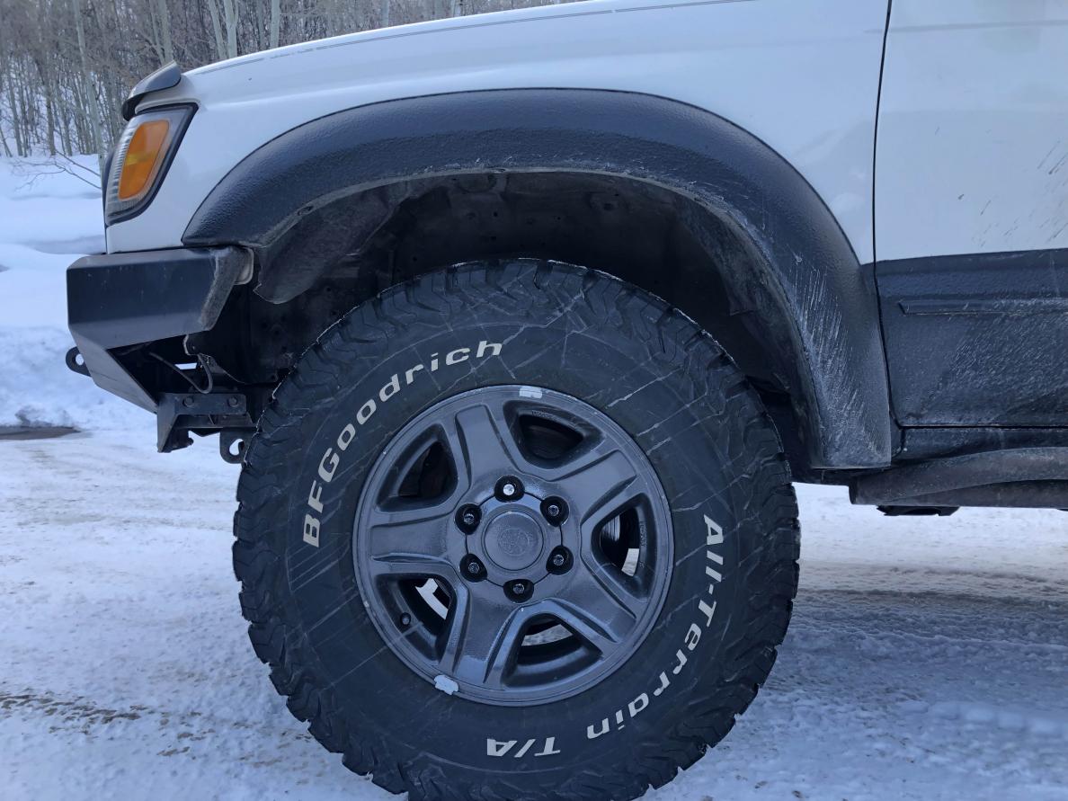

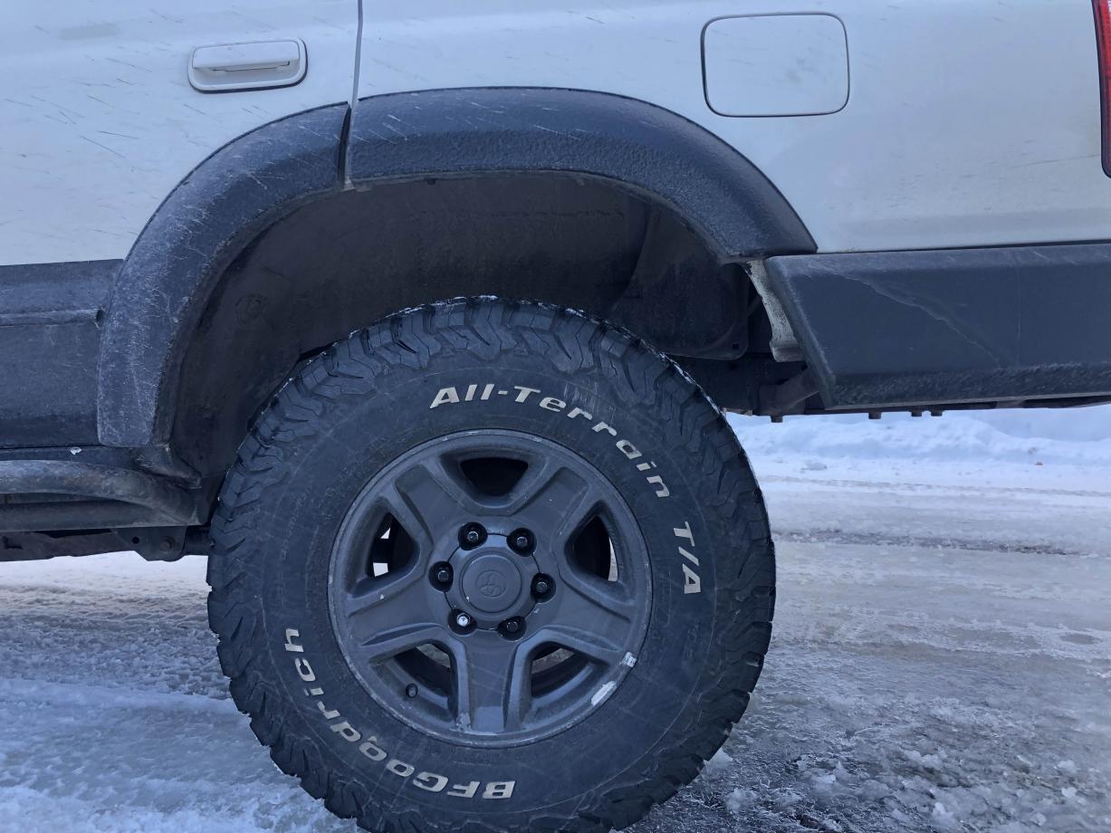

Sure enough I drive out of there and there's some awful rubbing close to full lock, but after removing the bolt and hammering the pinch weld its still there. Starting to tear into my fender flares now. Tonight at the car wash I notice the front tires seem pretty tucked into the wheel wells compared to the rear. So FINALLY I break out the tape and my rear is still at 37" to top of the fenders, but the fronts are at 35".

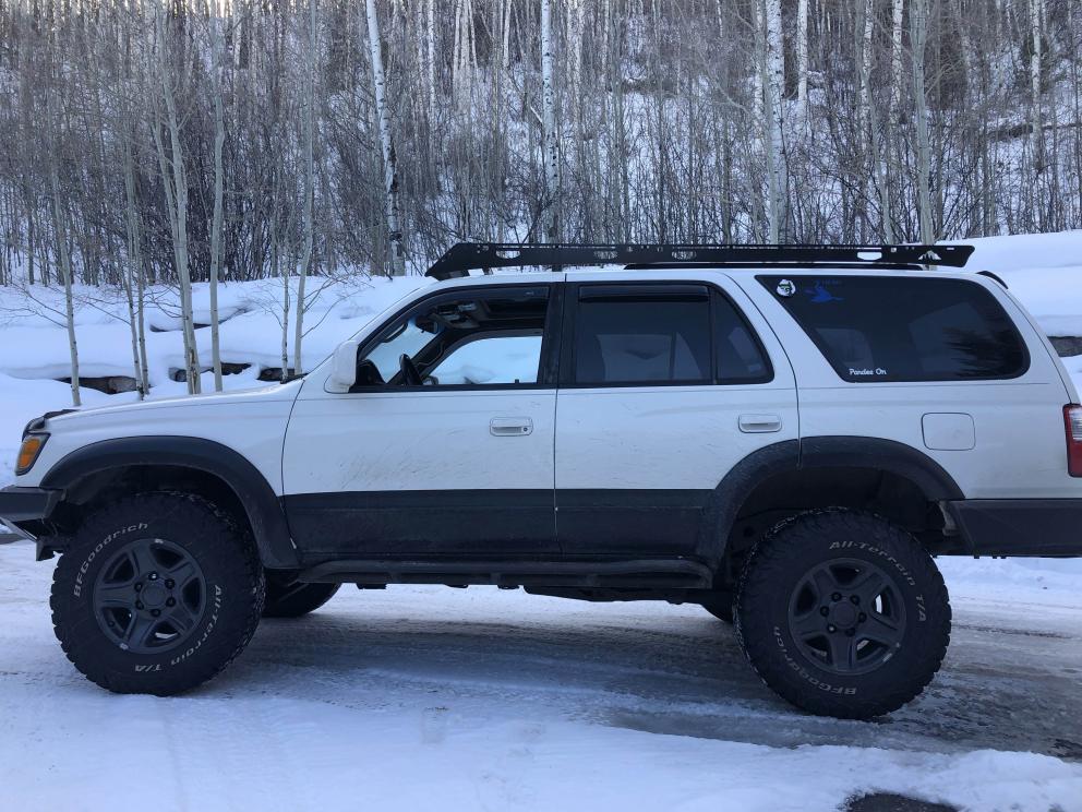

Post up a side pic. I got 3" on 881s and toytec spacers. Added winch with steel line and bumper and sit around 2.5". And that's on a 96 that sits the lowest stock of them all.

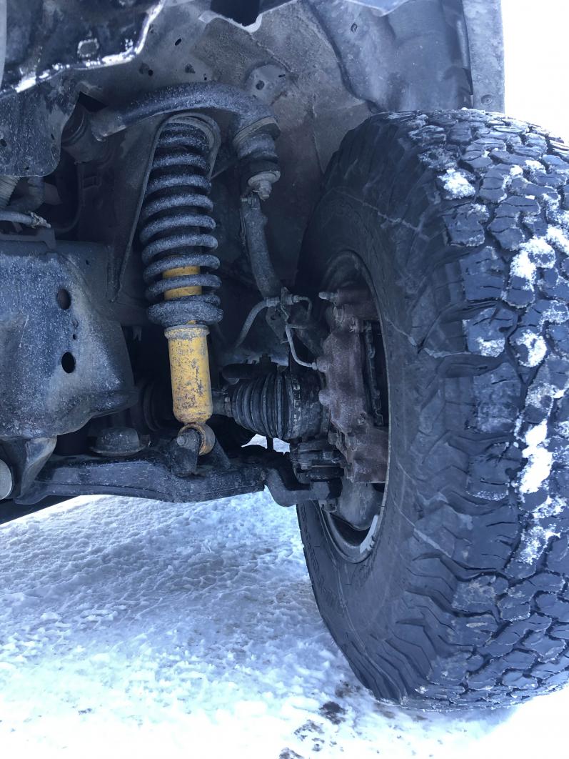

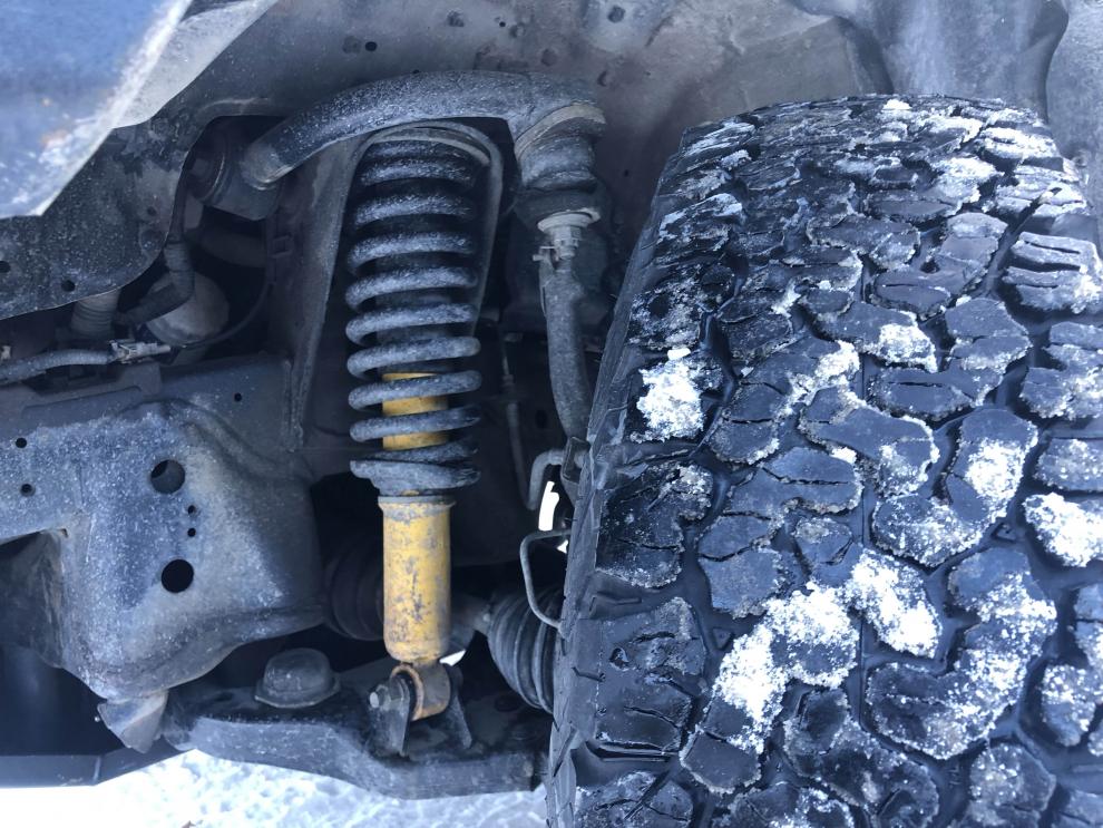

I did talk to the mechanic, who just kind of shrugged and said 'huh, thats strange.' Apparently he just removed the LCAs and LBJ, put the LBJs into the new OEM control arms, and replaced. Didn't touch the shock assembly, upper control arms, or anything else.
Is there anything glaringly obvious in the photos that I am just not seeing?

everything looks normal/standard - but but standard for what I would expect with stock height

Not Normal!
Your UCA is way too high up! (the angle it is sitting at is inverted from where it should be)
The UCA ball joint should sit below the top mounting point of the coil over, not above it.
Did you maybe have a spacer before he did the work?
I don't know what the spring seats on Old Man Emu Shocks are supposed to look like but the seat that the spring is sitting in (on the bottom of the shock) if it were a Bilstein the orientation that yours is in would be upside down. That having been said it should only raise the vehicle if it was upside down, not lower it?
The only thing I can think of is that he either put the wrong springs back on your truck or removed a spacer.
