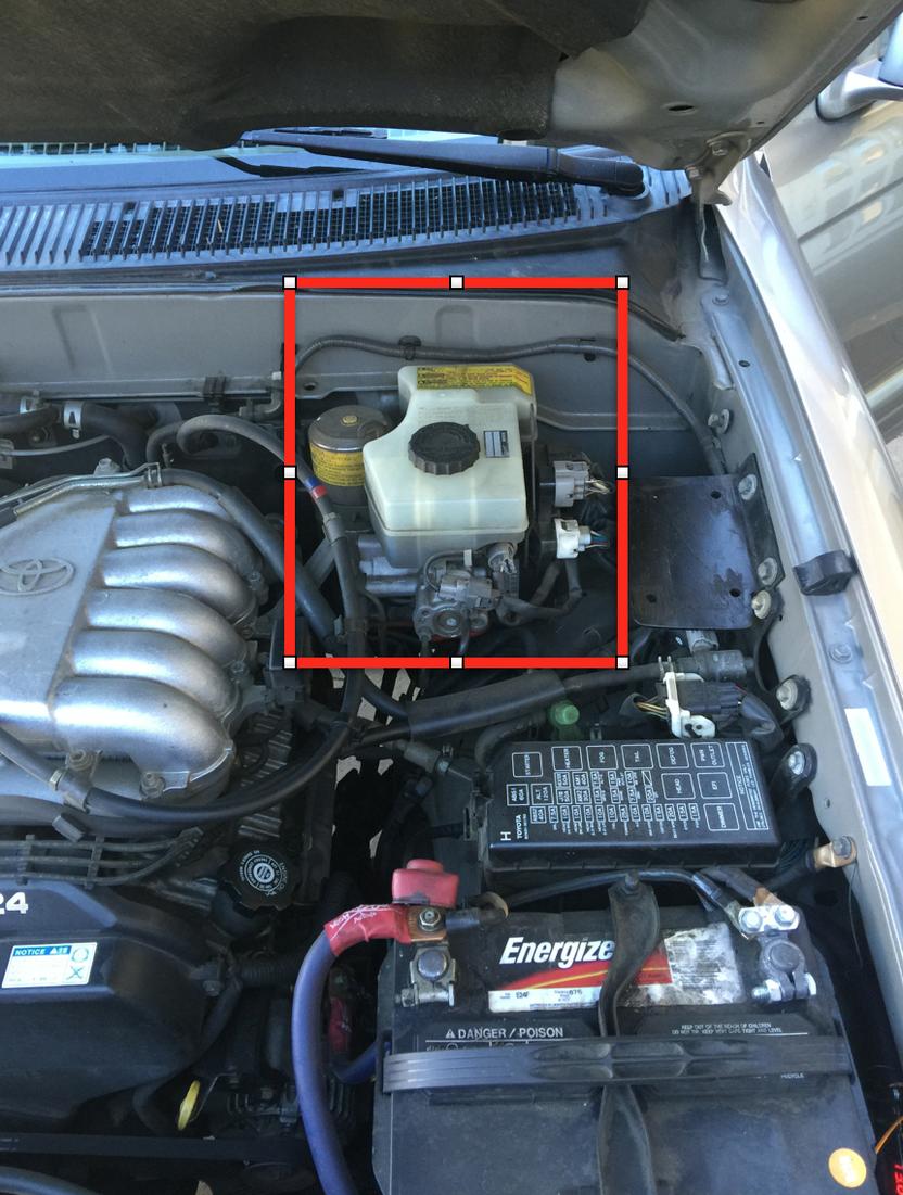

the thing that is making noise is a component on this!!!

Ouch. You've got a hydraulic booster. Little more complicated than vacuum. The part below the reservoir is the booster. But definitely sounds like a booster. Mine is doing the exact same thing.
which part is the booster?...
is the reservoir with the brake fluid in it the master cylinder?????
Are you leaking any fluid? Sometimes you can get away with replacing the check valve, and sometimes not. If not replace the entire unit and call it good. Your master cylinder is the section with the fluid in it. The booster is the round solenoid on the side. This is the booster.
