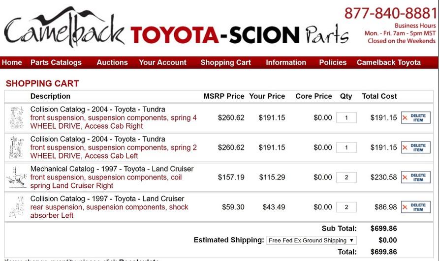

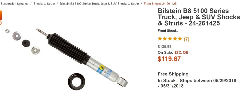

FRONT - These EXACT PARTS:
* Front TRD Coils: 48131-AF090 & 48131-AF100 (1 of each specific part #) [$191 each]
* Front Bilstein 5100: 24-261425 (Qnty 2) [$120 each at AutoAnything] --> https://www.autoanything.com/suspension-systems/77A5660A6319055.aspx
REAR - These EXACT PARTS:
Rear Land Cruiser Coils: 48131-6A570 (2)
Rear Toyota Tokico: 48531-69417 (2)
So $700 + $240 = $940 (no tax and free shipping!). Plus $500 to Sonoran Steel if you want the quick setup kit linked and that equals ~ $1,440 out the door for a proper correct real Toyota parts LC+Tundra badass lift kit. You would still need to assemble the front strut and coil together but you aren't experienced you can pay a local shop 1 hours labor, lets say $100 to assemble it for you. That brings you up to $1,540.

The 24-261425 billies are $104 each with free shipping from Summit Racing, no tax for me in CA
