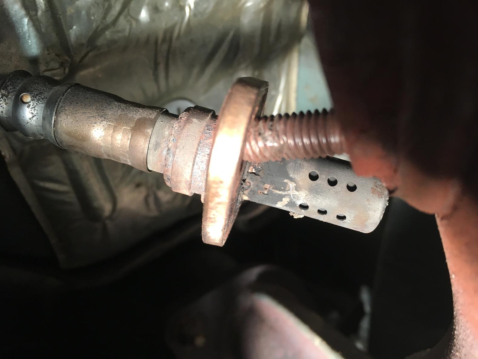

also look in pic.. i am needing to replace bank 1 sensor 1 oxygen sensor. I have sprayed with penetrating blaster few times now... but it's so corroded..not sure how to get that removed..thoughts? I suppose i'll need an angled socket extension pivoting one to try to get at those corroded nuts on there.. ideas?

the fluid you see there is my penetrating spray.... on the O2 sensor....it was dry before i sprayed..but the nuts are sooo corroded...wondering how to deal with them....?

Exhaust bolts can be a bear to remove. you might end up destroying the stud - it may be just as rust-damaged as the nut(s) a good muffler shop should be able to tackle that for you if it proves unmanageable.
PB Blaster will be your friend. If that doesn't do the job, then apply some heat with a torch. I got lucky and my A/F sensor came right off. I had to drill out one of my O2 sensor studs and replace it with a bolt though; it snapped with barely any pressure.
I had to take a dremel with the flexible extension and cut off both nuts as they were so rusted. Took a good couple of hours, and not the most comfortable position. Good luck.
so you just cut off the nuts and preserved the bolt on there?
Would I be best off by just unplugging the sensor, and dropping the exhaust completely to work on this thing? I'm not sure what that entails but...the angle and laying on my back... if I have to replace the bolts as well, how the hell does that work, aren't they part of the exhaust pipe welded on or something.. they are just so rusted .. well i'll try to put a socket on there and crank em off first..
If the O2 sensor nuts are that bad, you'll have a worse time with the rest of the exhaust. Look into using a nut splitter. That might work better for you.

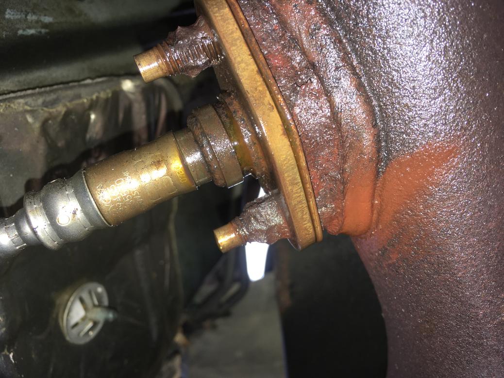

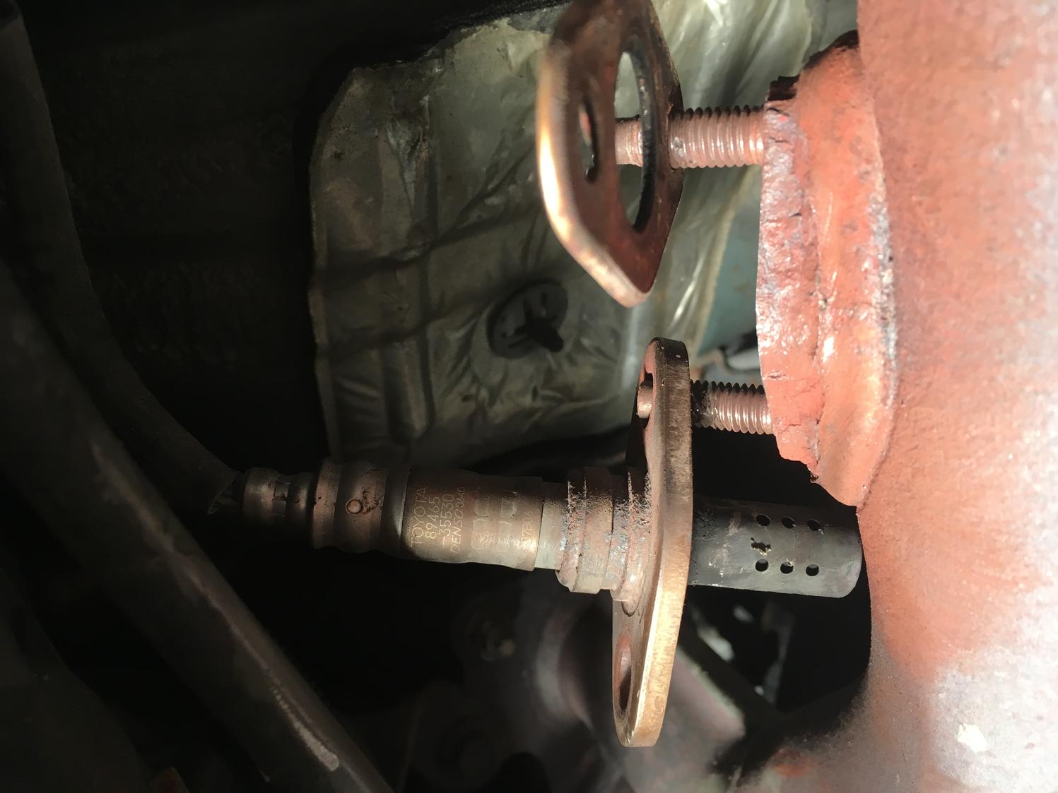

so....
took a peek at the nut splitter at menards... thought maybe wouldn't be able to slide the smaller one (comes in package of 2, one larger one smaller) between the nut and the sensor.... so.. guy up there told me to try grining with dremel and also pick up a sharp pointed smaller punch...so I did.
the nut that was completely corroded away..well.. i punched it with the sharp point and half of it peeled away from the bolt.... i was amazed.... basically did the same to the other half of it and boom...one done.
i then took the grinding wheel to the other more in tact nut... after punching it a few times... making a hole but not really doing to much.. decided to try to grind it and make a good cut up and down.. well it was hard to stay in one place so i ended up grinding a bunch off.. it was eating away at the nut pretty well... didnt take long at all.. so then I punched it a few times with the sharp pointed punch.. and BAM... got that nut to split and peel off as well....
I ended up eating away at the bolt a bit with the grinder... dremel type tool... hope i can get a hardened nut (12mm? - i wonder what the pitch is..) and just twist it onthere in place... i'll have to pick up 2 nuts and finish the job tomorrow..BUT.... it actually went very well for once... spent 20 minutes actually working on the nuts.... again hope i can just force the threads to work out on that left side, with a hardened nut... guess we'll see... but that was a hell of a lot easier than I expected....wow.

i punched it with the sharp point and half of it peeled away from the bolt.... i was amazed.... basically did the same to the other half of it and boom...one done ...a hell of a lot easier than I expected....wow.
Brilliant job !
got the O2 sensor on.
for anybody wanting to know what size nuts to get for that sensor bolts, its an M8, 1.25 thread pitch.
i picked up hardness 10, and that was a 1/2" size drive. Used open ended wrench for most part, turning 60 degrees at a time, plowed right thru the damaged threads from the grinder dremel..
